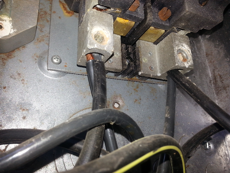

This is the feed in from the meter to the 200amp breaker and then the 2 hot connections on the breaker with copper and al put together. The ground is the same. Both wires are #4 which on the al i dont think is enough for the 200 amps if it got the full draw for some reason. I'm trying to figure out what I can do to correct the issue for now. The power wouldn't be connected to the house if everything wasn't right in the meter box itself. The power company inspects the connections before installing the meter and won't install it if they don't meet code. Beyond that point they don't care though. Eventually we want to put 1 box out there that feeds the 3 circuts, but don't have the money for it right now. The other 2 circuts are on another box under this 1.

Wow - those lugs in the pictures look pretty bad. I would immediately get some no-ox from the closest electrical supply or big box store, pull the meter, and clean the lugs and cables. Then strip back enough insulation (probably 1") to mount a split bolt connector, and apply no-ox to the aluminum, and mount it to the copper wire. Then wrap the connections with electrical tape, and re-tighten the previously corroded lugs to 50 or so ft-pounds with the copper only in the lug. By doing so, you have fixed a possible impending fire due to corrosion, which is looks pretty bad in the picture.
None of the wiring appears to be suitable for a 200 amp service unless I am misjudging the picture. As long as the actual ampacity ratings of the wire itself are not exceeded (100 or so amps) then you should be ok for a while, assuming that your system ground is functioning. Considering the way the rest of the wiring has been handled, I would be examining the ground, taking some pictures, and posting that next.

That isn't corrosion. That's the remnants of mud dobber nests. I just haven't cleaned all the dirt off yet. They will be clean once I actually set to correcting the issues. The copper wire is just barely big enough for the 100 amps capacity being pulled through it.
/ electrical issues. #17
Are you saying that the lug is not corroded? Sure looks that way in the picture, but I was also thinking about the aluminum wire which looks heavily oxidized.
The copper wire would only be a few inches long at the point of my suggested split bolt connection. A couple of inches of wire will carry a lot more than you might think without overheating. However, for safety's sake the main breaker in the panel shouldn't be much higher than the service wire capacity. What size wire is it, and how long a run to the house panel?

This isn't even connected to the house pannel other than possibly sharing the lug at the meter. I had a neighbor who recently retired as an electrician come over this morning for his reccomendations both temporary and permanent fixes. Temporary would be a brass connector that can be inserted into the lug with the copper after cleaning the lugs and wires throughly and applying "no-ox" to the al wires. When we moved in both lugs had mud dobber nests on them which is most of what you are seeing. There is a little corrosion on the lugs themselves. The al wire is ok for 50amps at 100% duty, so for now (after cleaning and prepping everything) it will be good as an access point for welding etc. since my portable welder only needs 38 amps peak surge and the compressor/plasma cutter 47 amps peak surge combined.
#19
The mostly permanent fix will include a 200amp breaker box combining the 200 amp and 100 amp box below it into 1 with a 100amp breaker to the shed's new location via the current termination point with new properly sized wire not sharing lugs with other types of wire. we'd eventually like to put a bigger box inside and combine everything into 1, but that's another massive can of worms with only copper wiring involved.
