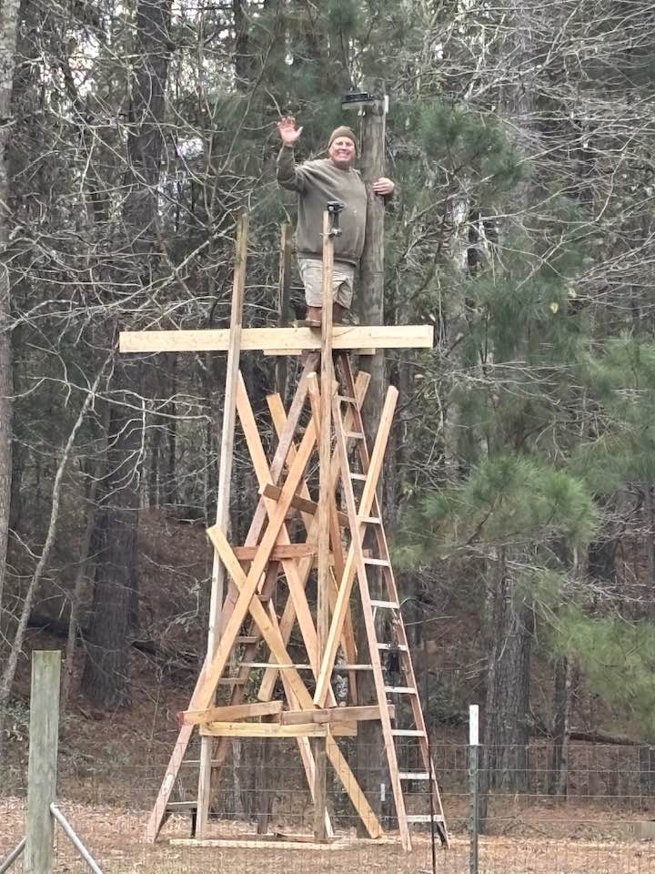

The only connection that I haven't checked is the breaker. Today it started out at 22 degrees outside and the high should be 36 degrees. Then it's going to get worse this week, and maybe even worse next week, so I'm not messing with anything out there for a while. I've bypassed what I think is the bad section of wire, where my wife dug up her plants, with a couple extension cords. The light is working perfectly!!!!
472659463_10235514097495762_5771016872339971485_n.jpg 472536520_10235514097855771_7968058056262785382_n.jpg
