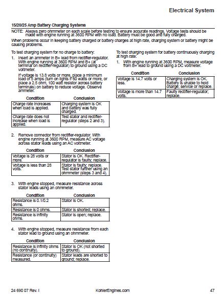

Before you start taking this apart, do these test as described in the Manual. I have attached page 47 that shows what and how to test the stator.
As you my note in the jpeg I attached, you will have to have a good ohm meter in order to know if the stator is shorted or not. Also check for short to ground from one the stator leads. I should read in the mega-ohm range or grater. (note: you can't hold the meter leads in your hand while measuring from stator to ground.)

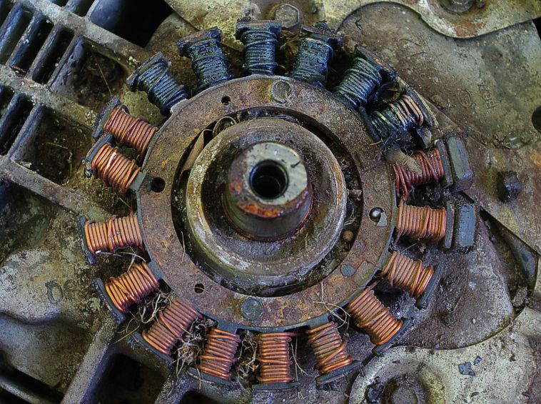

Thanks for the help. I pulled the flywheel and the stator does not look good at all (half if black). Also, parts of a magnet is still attached to the stator when I pulled the flywheel. Can I get just the magnets, or do I need buy a whole new flywheel? The magnets are also all loose on the flywheel. Here's a pic of the stator. (doesn't look like I will be mowing my lawn soon). (Also, I did find the service manual, and gave it a test which lead me to believe it was the stator).

Yep, not good. Guess you found the problem. Good work.
   / Electrical Problem on Scotts s2554 #10
The cause was the flywheel. You could clean up the flywheel, get rid of all the magnet bits from the engine, tend to the outside electrical damage from the engine and run it. You would need to keep after the battery by charging it. You could also buy a stator 237878-S and an ASAM conversion kit 24755308S which has the flywheel and new ignition set up .

I was wondering if the magnet coming apart could have caused the problem. You can see 2 pieces still attached to the stator. Aside from the fusible link, I don't see any other wires cooked at all.

Was wondering if I could just run it without the charging system. I may just try that. Did find the stator on amazon, but I would assume the magnets need to be replaced since one is in a few pieces.
