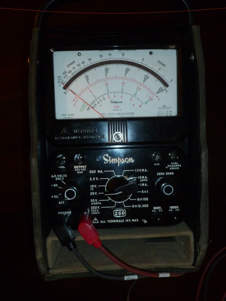

One of my meters is a Simpson model #260. I have owned it many years and recently it quit working. I have changed the battery and checked fuses but no luck. Love this unit but now it doesn't work. Any ideas?

First and obvious thing: If you can't get ANY readings at all, have you verified your leads are working?? It's possible one of the leads could have a frayed connection where it solders to the jack, or the test probe. If you are able to get ANY sort of readings, then the leads are obviously ok. Which leads to a likely defective component on the board inside it, or possibly the meter movement could have gone bad. Only way to tell that is to open it up and start checking things with another meter.
