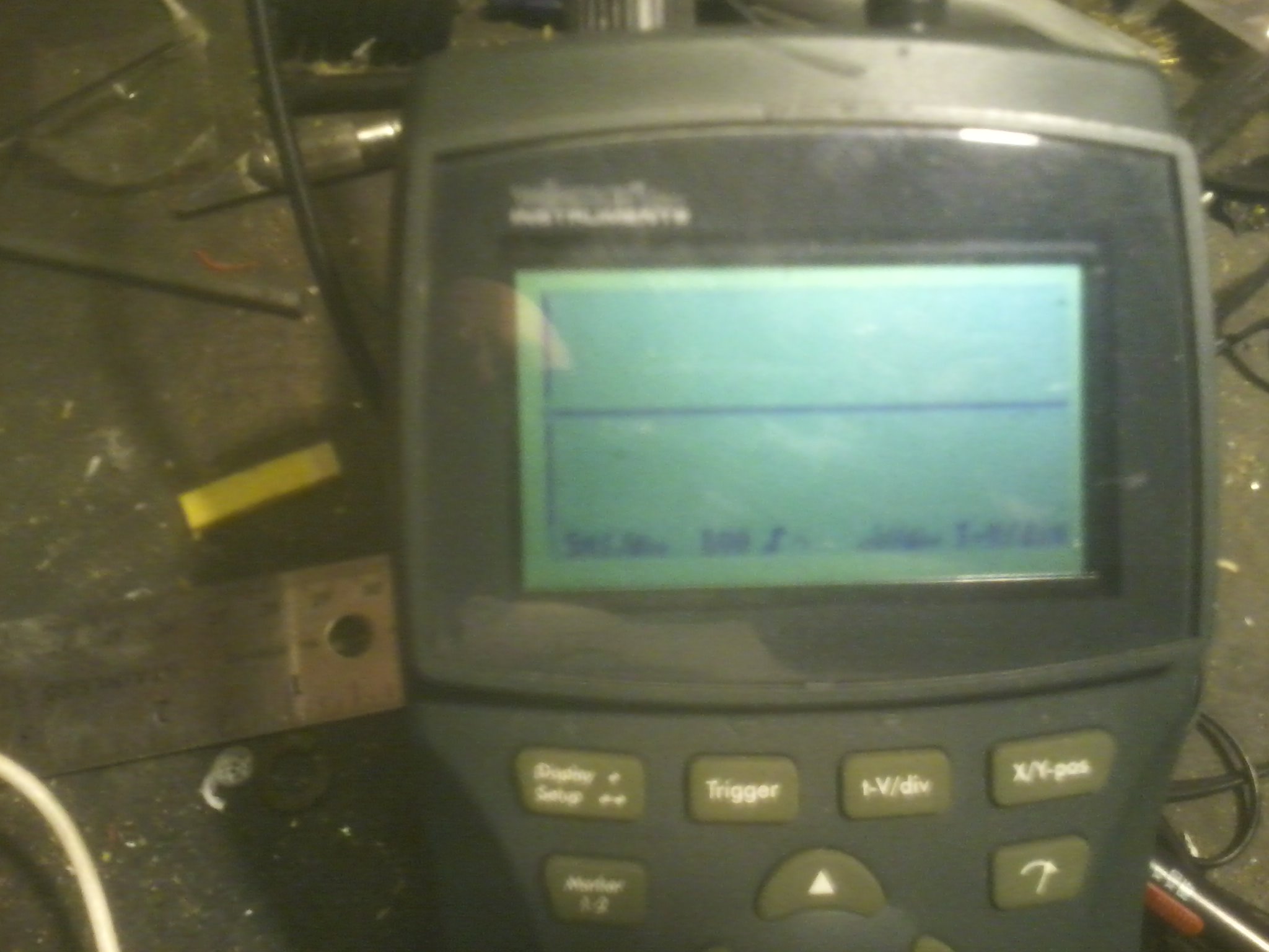

Here is the layout showing a clean signal without the drill on any circuit:

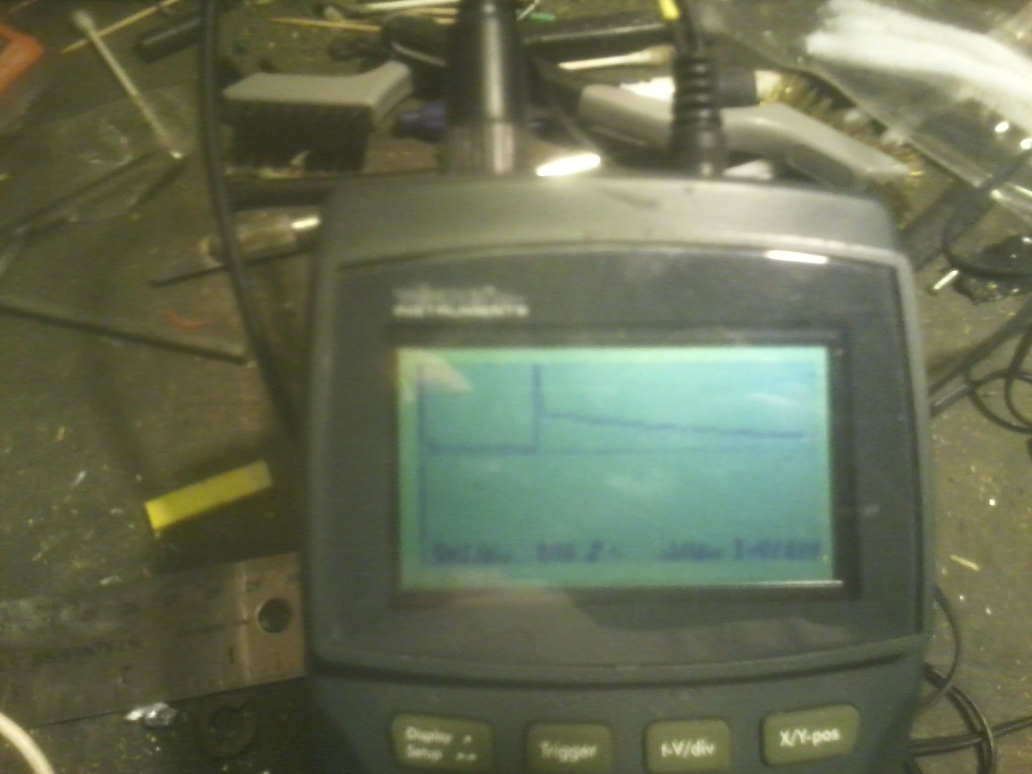

Here is the signal with drill running on another circuit from same breaker box:

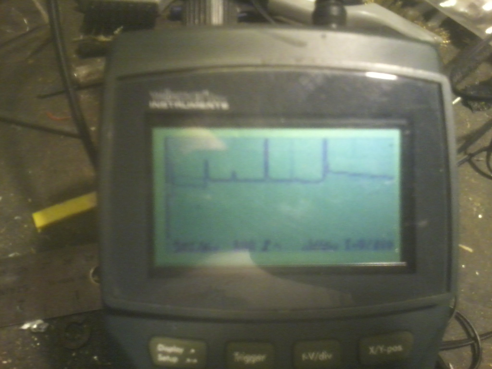

Here is with the drill in the shared neutral circuit at start up:
Here is the Display with the drill just running (shared neutral:
Conclusion: There seems to be significantly more noise induced onto the other leg of a shared neutral circuit when a noisy appliance is paired with a DC output device.
