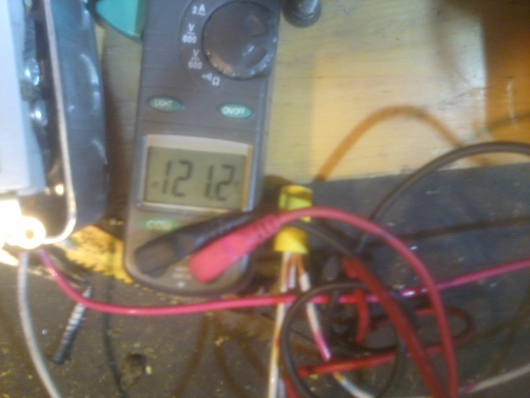

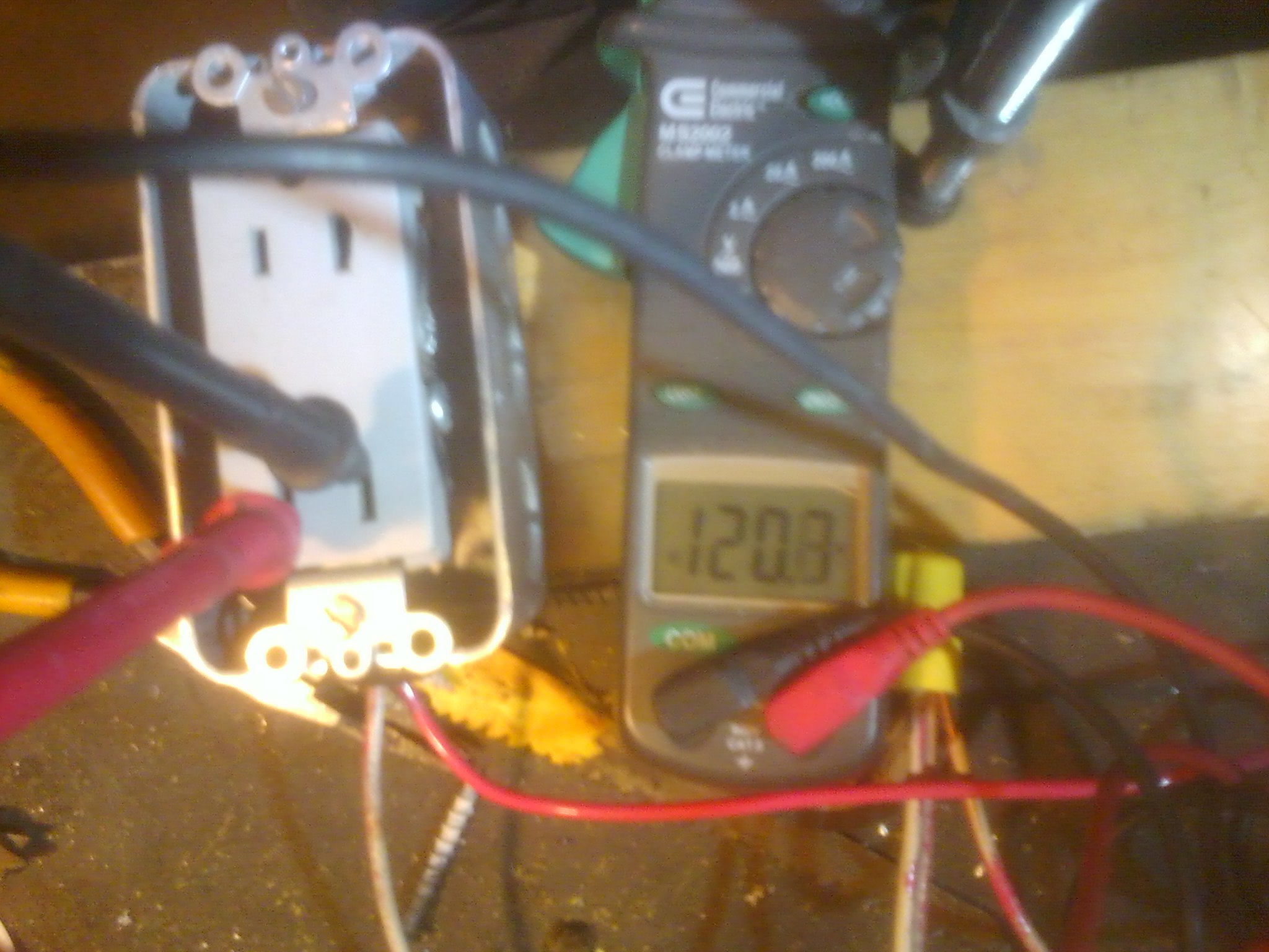

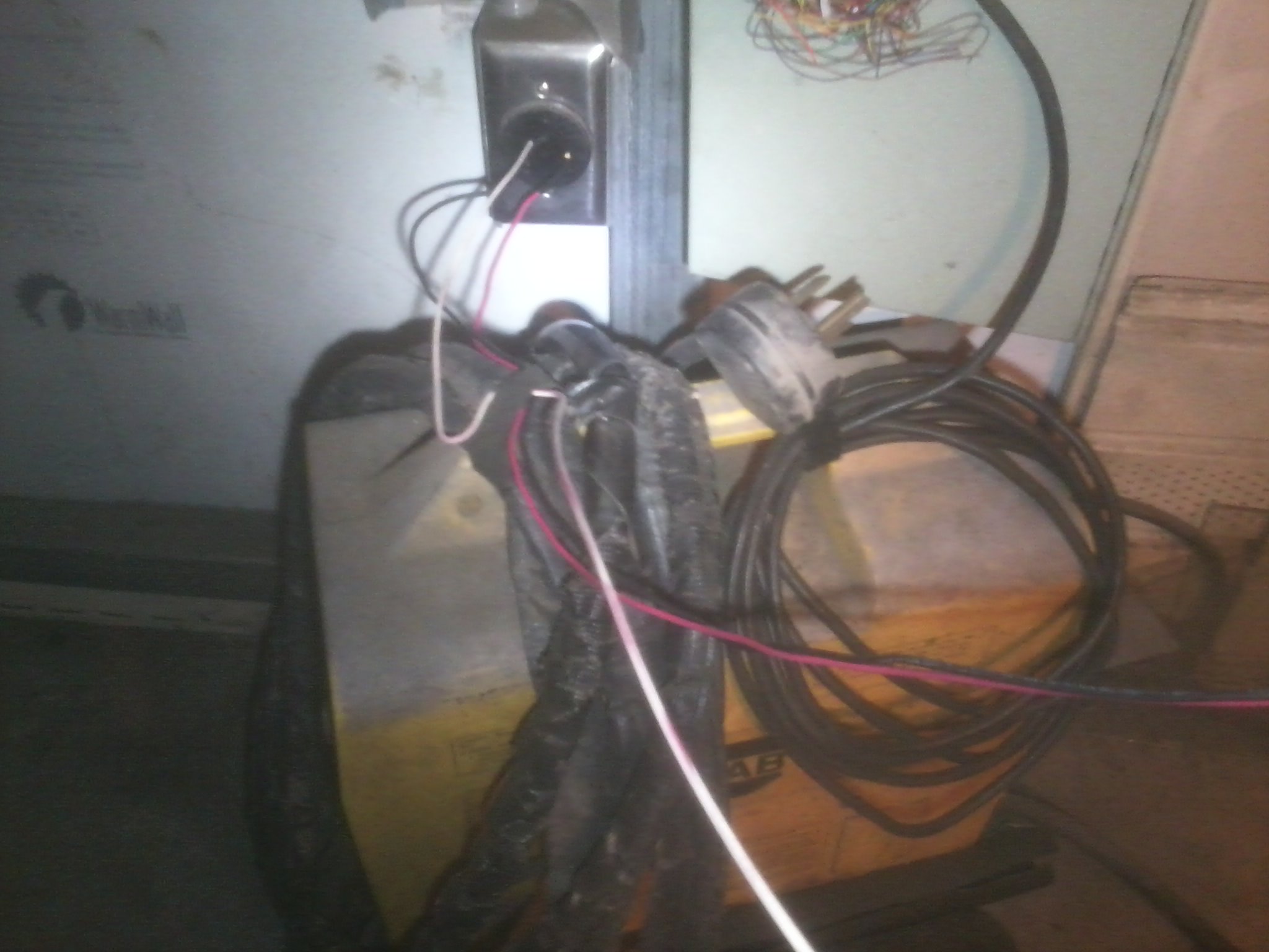

OK, for simplicity I set this up using the 220v outlet used by the plasma cutter:
Please excuse the crudity of this model. I didn't have time to build it to scale or paint it:
Voltage reading across the two hots in the 110v duplex outlets= 238v:
No load voltage across 110v outlet on red side= 120.7v:
No load voltage across 110v outlet on black side= 121.2v:
Camera battery died whilst performing the clamp meter amperage test, but the results were as LD1 had predicted; i.e. using two identical Lasko box fans, the neutral measured .5 amps with one fan on high speed. The hot side for that fan measured .5A as well. The idle hot measured 0.0 amps. When both fans were on the neutral measured 0.0A to .01A and both hots measured .5a respectively.
