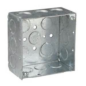

And why would you be pulling all 9 thru a single gang box with only 1/2" holes anyways. Pull main run into a 4 square box with 3/4" knockouts then branch out to the smaller boxes with 1/2" conduits.

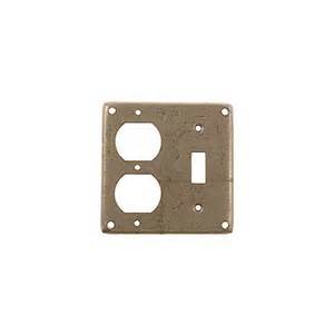

I also never use small junction boxes. I always use the 4"x4" variety with the raised commercial covers. They allow more wire space room, look more professional, and allow for single or double outlet combinations. Art not very expensive either
