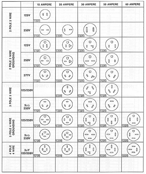

We could try this another way. A male plug on a cord to plug into a 120v 15 amp receptacle has one configuration. A male plug to plug a cord into a 120v receptacle 20 amp receptacle has another configuration. A male plug to plug into a240v 40 amp receptacle has another configuration. A male plug to plug into a 240v 50 amp has another configuration.
Go to graingers.com and download the receptacle and plug chart, do a bing search and see that every ampacity and voltage has receptacle and plug. More if you consider twist lock which also has ratings to the configurations. receptacles.jpg
