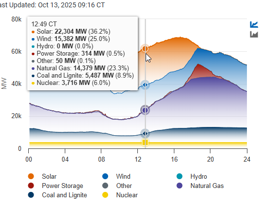

I am all for renewables, just not mandated for the consumer. Texas is heavily invested in solar and wind. Yesterday at peak sunshine shows over 61% of generation was solar and wind. There is also generation capacity for when the sun doesn't shine and the wind doesn't blow. Keeping those sources idled still has a cost associated with it.

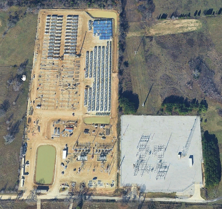

New battery storage facilities are coming online. There is one just south of me that recently came online. The picture shows it under construction in December 2024.
