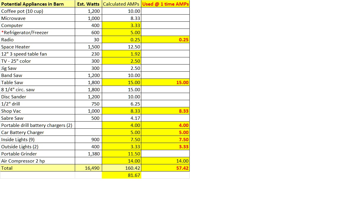

I need about 60 amps at my barn which is about 350 feet from the house panel. It must be buried and it will cross over my cable for the tv.
I looked at running a new line from the street but they want $65 a month for the meter which is too high.
I've received quotes and they are all over the place. Can I get your opinions on these?
1. $5.5K -- 2 6/3 wires from panel in house to outside wall then 1/0 Aluminum to barn (about 290 ft).
2. $4-K -- 1 6/3 copper wire from pannel to house outside wall and then 1/0 Aluminum to barn.
3. $1.5 -- 1 10 guage wire all the way to the barn.
4. $3-K - 1 6/3 copper wire all the way from the panel to the barn.
These all are official quotes from companies in my area. What do you think?

3.4% voltage drop = ok for the 1/0 the 2 6/3 wires don't make any sense you need 4 wires for sub panel in my area.
3.4% voltage drop = ok for the 1/0 the 1 6/3 wires don't make any sense either you need 4 wires for sub panel in my area.
16.2 % way too much loss and 10 gauge is rated at 30 amps how are you going to get 60 through it?
6.6% drop ok but not good design and a little light rated at 55 amps so marginal for 60 amps

By the chart 2 gauge copper would be the correct size if I were running it.
That would be 3 #2 (hot, hot , neutral) and #6 ground cooper and a driven rod at the barn again done to code in my area.
You could substitute aluminum conductors 1/0 If you were doing that I'd just run aluminum all the way not change to copper unless you cant get a connection on your panel for 1/0.

Ok, heres the figures as i calculate them. For a 4.8% voltage drop over 350 foot run you are going to use #2 alum URD direct burial wire buried 24" below the ground (or 18" if buried in conduit). Whoever gave you a quote on #10 is an idiot. at 350 feet you couldnt even get 15 amps out of that.
We run #2 all the time and there had never been an issue with its use. You can even run a 2/2/2/4 SER cable under the house if you wish to a J-box where it leaves the house and starts the path underground. You need to run 2 hots, one neutral and one ground wire to the shop.
2/2/4 URd runs about $1.50/foot here in Idaho, plus $0.35 / ft for the #6 ground wire.
i always run at least 1-1/2" conduit on my work with #2 wires, and this is running about $0.50/foot

Also, to run a 6/3 COPPER all the 350 foot to the barn would result in a 8 - 9% voltage drop. So whoever suggested this is also nuts. This is WAY outside the allowable 6%, I always try to stay in the 3-4% on all my outbuildings.
Voltage drop plays havoc on equipment.
