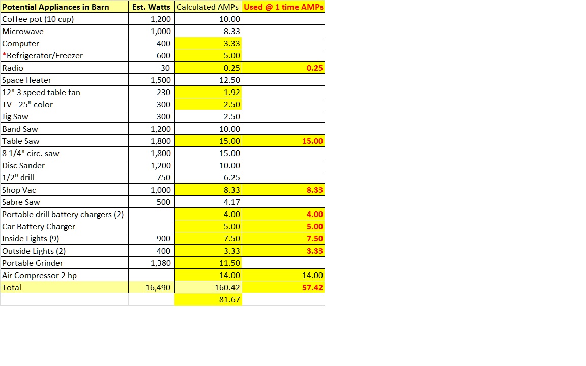

It sounds like your bidders bid on two different options. Do you need 120 volts at 60 amps or 240 volts at sixty amps. If the distance was short the 10/3 with ground would be ok for the 120 volt 60 amp if no single load was greater than 30 amps. Of course the distance is not short. Stay away from this guy he does not understand voltage drop. What else does he not know? Please describe your loads.

I too am in the business and in my opinion, options #3 and #4 are out as they do not account for voltage drop. Actually, there is no way to get 60 amps from a single 10 gauge wire. I don't really understand option #1 running 2 6/3 wires. Option #2 sounds right on the wire they will run but maybe a little high in price. Probably between 500.00 and a 1000.00 more then I would charge for the same job. Now I haven't sat down and figured all the materials and labor out for an exact quote but just figuring in my head I would say it seems a bit high.

Someone asked me what what I would be running in the barn. Attached is my chart.
OOPs should be 5 amp for the car charger. (fixed chart)
