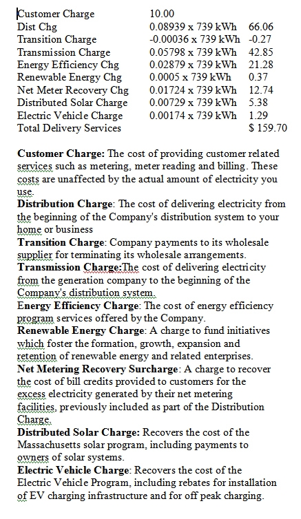

Not only do I get to pay for electricity services I do use in Massachusetts, I get to pay for services others use that I don't such as solar and EV's.
