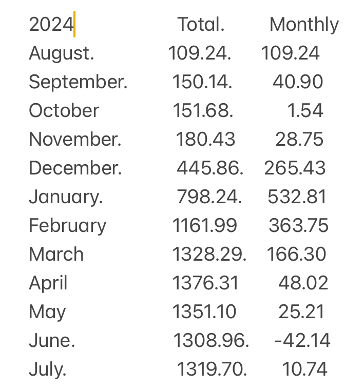

I have a 2500 SF house with a 7.5 kW ground mount solar. Last year I produced 15.2 kW and consumed 17.4 kW or 89.5% of my power.
My annual settle up was about $1,300 or $110 per month.
Now, if I didn’t have solar and had to pay the piper the full cost using simple math it would be about $900 per month.
Now this cost is distorted because SCE’s Net metering, my solar is being is paying for the low daytime energy cost and I’m paying for the high 4 PM to 9 PM high cost.
My house is 100% electric and uses mini splits for HVAC. Even though our winter temps are mild, due to significantly lower winter production my winter energy costs are significantly higher than summer.
I’m glad I got the solar.
