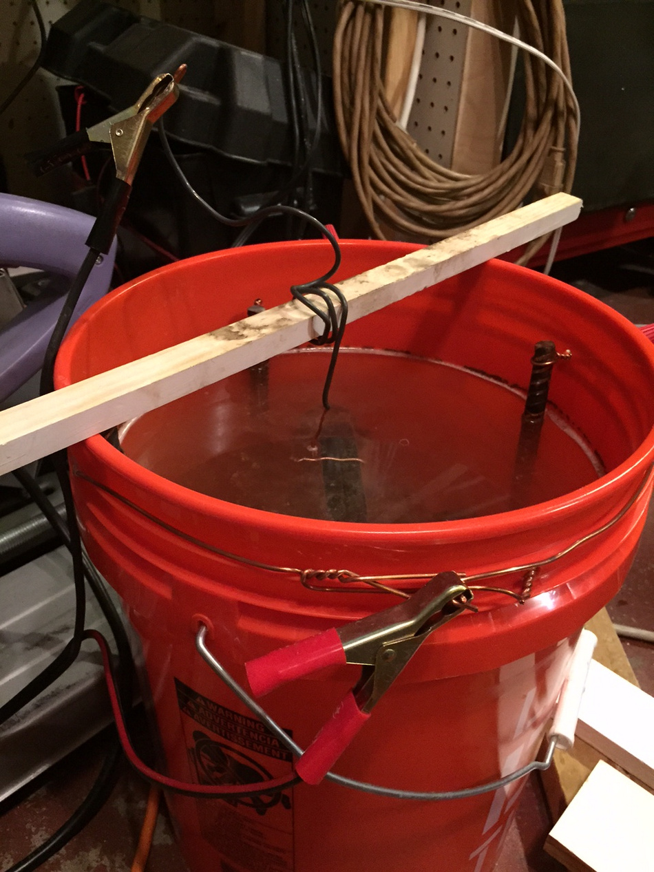

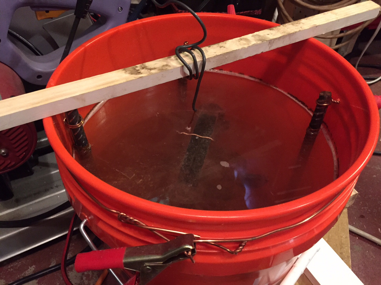

Anyway, I didn't want to grind them or wire brush them, so I rigged up an electrolysis bath:
Supplies:
  • Water
  • 1 cup of Arm & Hammer Washing Soda (NOT baking soda)
  • An automotive battery trickle charger or bench power that puts out low-amperage DC current
  • 4 old pieces of rebar (steel, NOT stainless steel)
Steps:
  • Mix up the solution of water and around 1 cup of washing soda per 5 gallons of water to create an electrolyte solution that will conduct electricity in a PLASTIC container
  • Connect the rebar with wire so that they are all connected, but not fully completing a circuit (leave 2 of them unconnected) and leave enough wire to attach a lead from the battery charger
  • Sand enough rust off your part to get a good metal-to-metal contact and then wrap a separate wire around the item to be cleaned
  • Connect the NEGATIVE to the ITEM TO BE CLEANED (remember, "black to rust")
  • Connect the POSITIVE to the wire connecting the sacrificial annodes (the rebar)
  • Turn on the charger (ideally set to <2 Amps to minimize any pitting)
  • Watch for micro-bubbles to start appearing... bubbles means "it's working"
I used a 5 gallon bucket, and the setup looked like the pics below, but you can make this as large or as small as you want, depending on the size of the part.
Here is a before and after pic after about 6 hours:
Here's a final pic after about 24 hours in the machine, and then a couple of rounds through my Harbor Freight ultrasonic cleaner and a good rubdown with a scotch-brite pad. The black residue that remains can be sanded or wire brushed off, but I like the look this way -- looks more "antique" than "brand new" which is what I was going for. Cover with some oil to prevent surface rust, and voila -- restored antique traps with (almost) no elbow grease.
Now, I just have to make a nice display board so I can mount these and hang them on my office wall.
NOTES:
  1. Don't use stainless steel EVER. If you do, it will release the chromium atoms and create the Erin Brokovich chromium 6 toxin (hexavalent chromium.) Very nasty stuff.
  2. If a magnet will stick to your rusty piece and your annodes, then you're good to go.
  3. Don't mix up your positive and negatives -- get them wrong, and you will clean the rebar and all the rust will be attracted to your antique part.
  4. So long as you follow rule #1, you can dump the residual water down the drain -- it's 100% non-toxic and safe.
  5. This only works in "line of sight" -- that is, if there isn't a straight path fromthe part to one of the annodes, it won't work -- add more annodes if you have a complex part, but I found 4 to be enough in a 5 gallon paint bucket
  6. You can leave the part in the solution and run it for days if necessary. The reaction will stop when there is no more rust -- no need to monitor it or risk damaging the part by leaving it in too long. It may take several days for a badly damaged, or a highly intricate part with a lot of nooks-and-crannies
  7. It will gather some surface rust almost immediately when you rinse it off, so make sure you either paint it or oil it ASAP after you've rinsed and dried the part
  8. You CAN use more power (amps) but it doesn't really help the speed much and you risk pitting the material due to the reaction being too intense. While this turns rust back into metal, there are "micro-explosions" of hydrogen gas happening, and these can pit soft metal if the amperage is too high.
