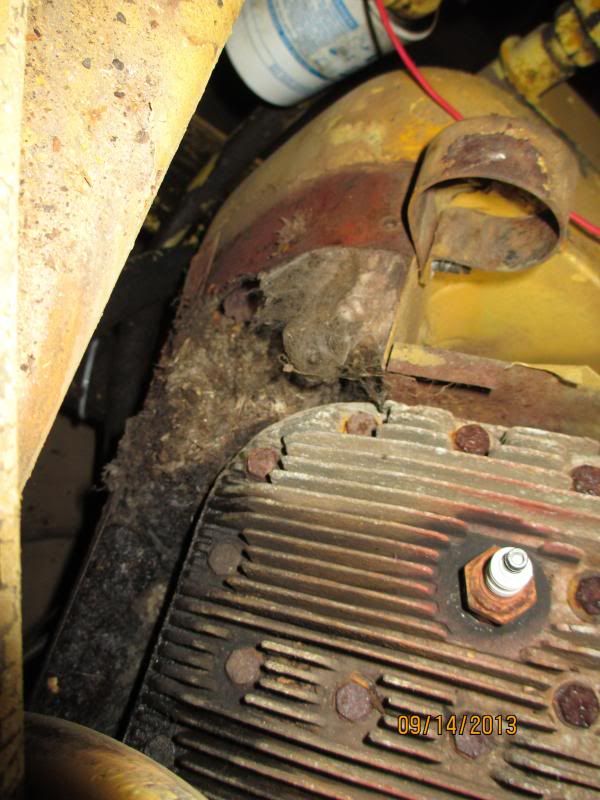

I'd remove the tin from around the heads and check the cooling fins. I suspect your back firing once hot is because rodents have pulled material into the cooling fins, and the engine is over heating. This is very typical on VH4D. They are very attractive rodent homes. Vac it all out and you should be fine.

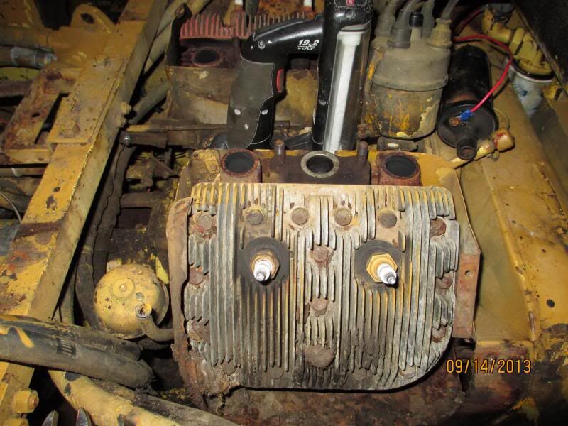

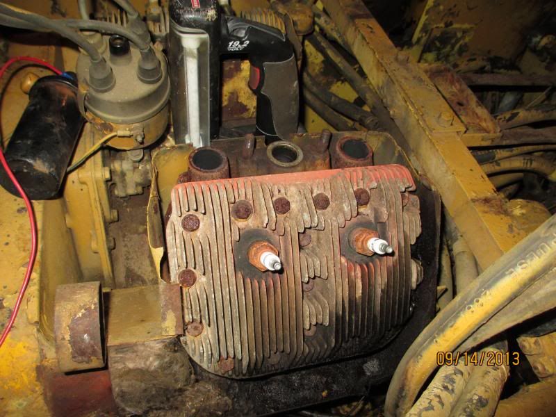

Bingo. I've read that before about these engines, but for some reason I had it in my mind that they couldn't be clogged up. Well, they were and what was left of my lower tins pretty much fell apart. I found a couple reasonably priced Wisconsins local on craigslist awhile back. One was a VF4 that I figured I could use for parts, another is another VH4D but it has the lower distributor. I'm going give the VF4 guy a call tomorrow and see if he still has it.
Finished breaking down the chain boxes today, I need two bearings on one side and one bearing on the other. Got those on order. A couple of broken pins that will be welded back up also. At some point there must have been something catastrophic on the right hand side, the outside of the chain box had been welded wear it tore and a quarter inch plate was on the inside. There was some signs of carnage on the inside of the chain box as well.

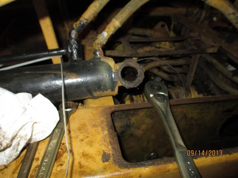

The lift cylinders ends are pretty wore out too. Can I just cut the end off and weld on new tubes for mounts? Or does the cylinder need to be dismantled first? I figured I could extend the piston and remove the hoses, drain the cylinder and cut off the old and weld on a new rear mount.

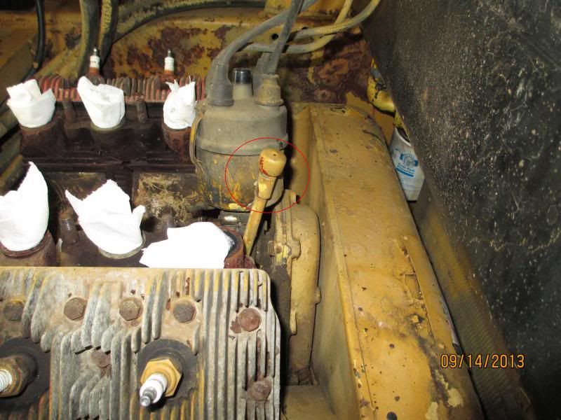

Anybody have any idea what this thing on the distributor is for (in the red circle)? It's like a lever that moves back and forth, but no idea what it does yet.
Glad you found the mouse nest. It happens to ALL of these. The thing circled looks like an extended grease port on the prestolite distributer ?
I'd be weary of welding those lift cylinders. Maybe if you went slow and constantly cooled the surrounding area.

There is a little oil dripper with a lid on the distributor also, I haven't pulled the orange cap off the lever thing yet to see what is under it. The odd thing about it, is it will move back and forth as far as it will go in either direction.
   / Electronic Governor? #32
It looks like it is some sort of grease fitting on the distributor. Not a zerk but some kind of injection fitting. New brakes should show up today, the drums are at pep boys, hopefully they will be able to turn them down.
