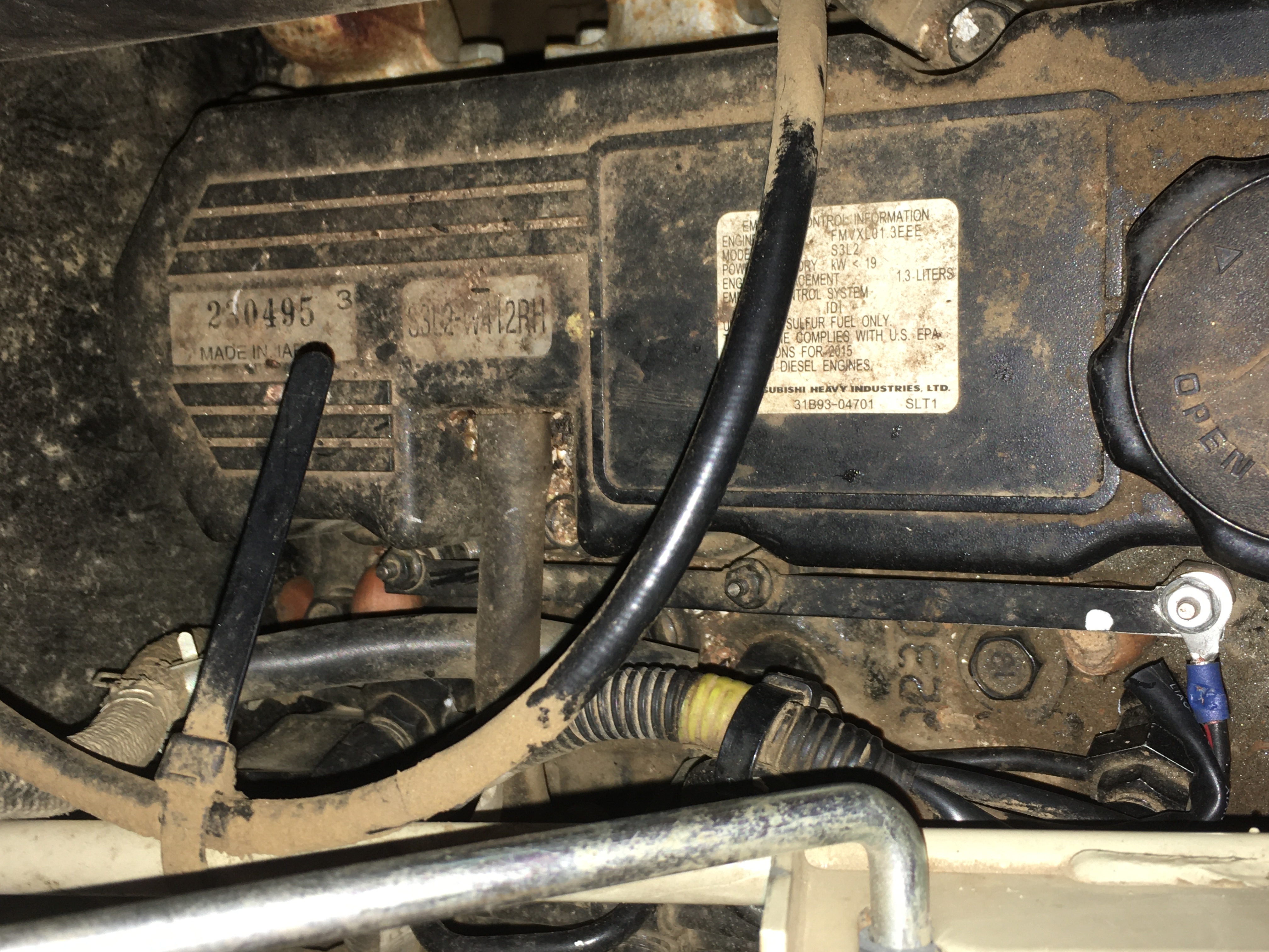

its the hot wire that connects to the glow plug rail...
hey i want to thank you on this, i checked mine and the plug is starting to melt, i cleaned it up, and wasn't making a good connection ( wouldn't start 20f), move the plug and 5 seconds later it fired right up, huge difference in start up with them working.
