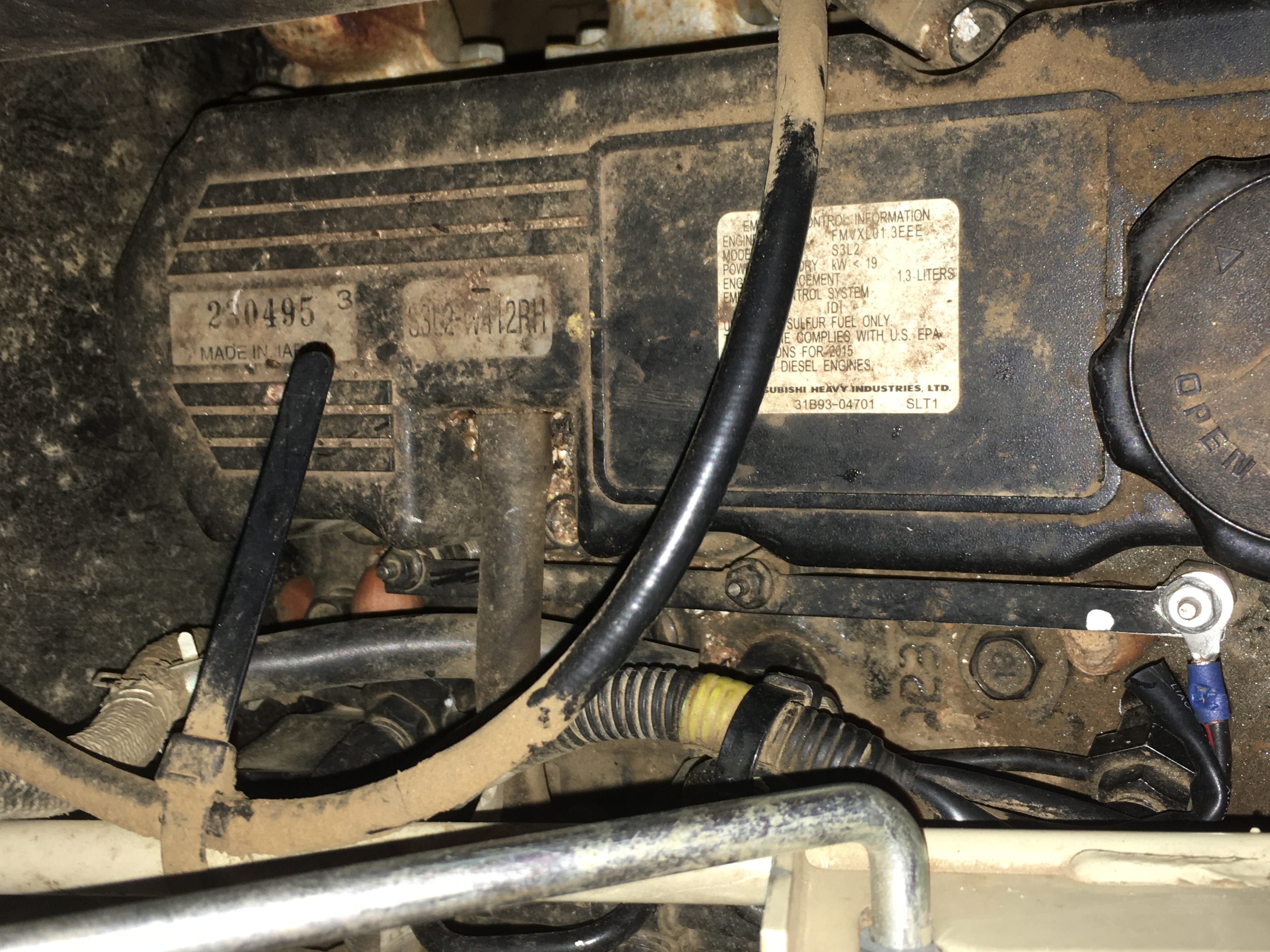

there's a connector on the glow plug rail, its cheap and becomes loose... if you hold it tight against the the connector it slides on, it should start... if the connector is gone, simply cut it off and crimp on a new one... had to do it on a 26 max xl gear... take a meter and see if your getting 12 - 12.5 volts to that connector, if you are, its probably a bad/loose connector...
if you need to start the machine, simply take a heat source (I use a torpedo heater) and aim it at your oil pan for a couple minutes, you'll see the white smoke start to turn blk, it'll start shortly after...
good luck...
any chance of a picture of this connector?

I'll take a pic of it wed...

its the hot wire that connects to the glow plug rail...
   / Emax22 hard starting and white smoke? #24
stock connector is blk, it slides onto the tab connector held down by 8mm bolt on the glow plug rail...
good luck
good luck
appreciate it. will check it out
