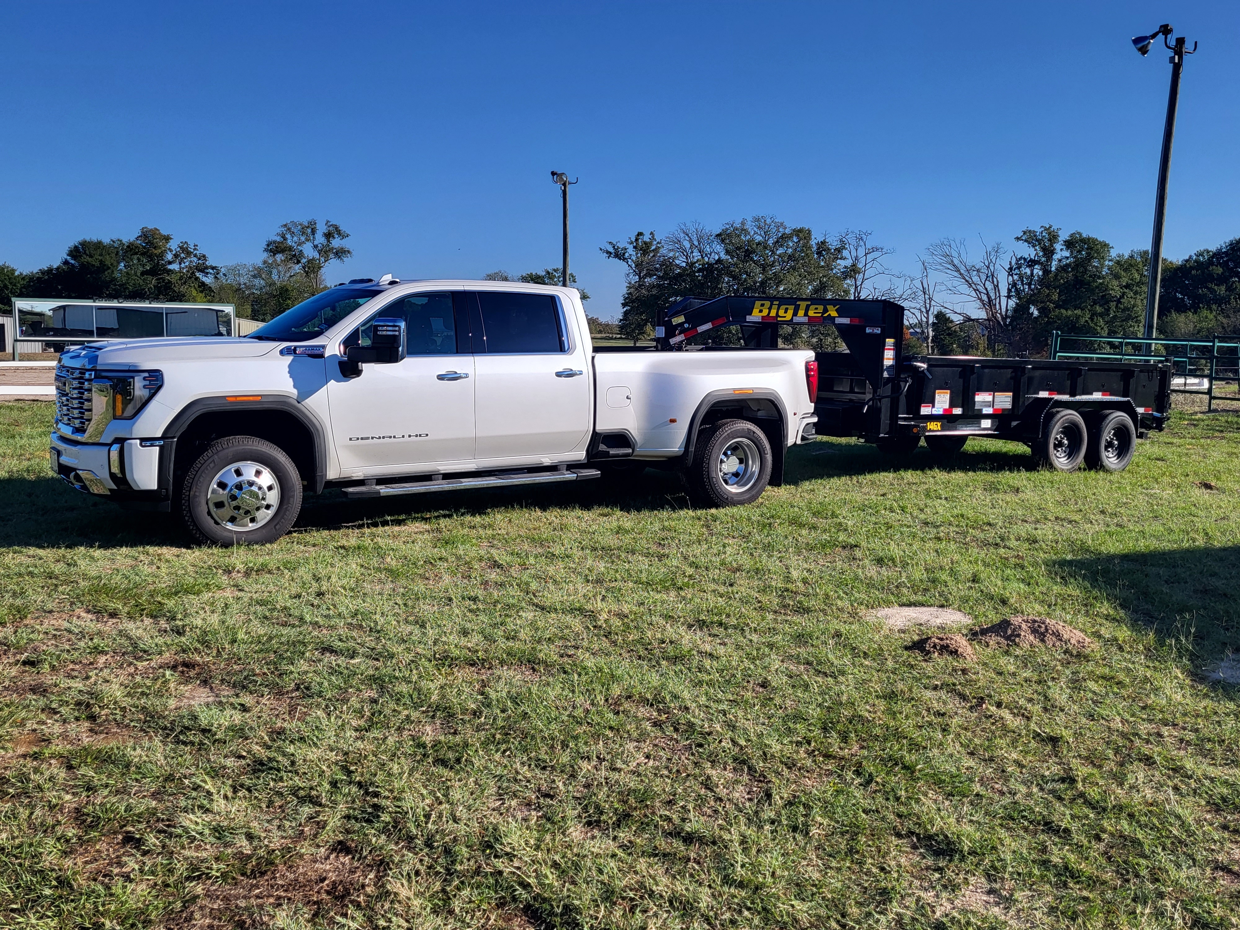

My recommendation is to test drive one with DRW, it is different. I went from a 2017 GMC 2500HD to a 2024 GMC 3500HD DRW. It is not something I have as a daily driver, and I wouldn't like it for that. My 2024 GMC Yukon is the daily driver. The 3500HD is strictly for towing trailers and hauling in the bed. Not only is the 3500HD DRW wider but it meant going from a 6.5' bed to an 8' bed. Parking is more planning ahead than a hassle. Parking a little further out just means more exercise.
When it came time for the first tire rotation, I put lifetime balance/rotation on my tires from Discount Tire so that isn't an added expense or hassle down the road. The rims stay in the same location, the tires are dismounted, rotated, remounted, and rebalanced. That way you don't have to clean rims or reset the TPMS. After 2 years I am at 6800 miles so replacement is a ways out, will be an age issue and not mileage. Discount Tire will not service a tire over 10 years old.
My largest trailers are rated at 15,900# GVWR. The dump trailer gets maxed out more than the flatbeds. Definitely feels more secure when towing a heavy load with duals. Even though the trailers all have brakes on both axles, the Duramax diesel with an exhaust brake and Allison tow/haul mode helps the stopping power.
