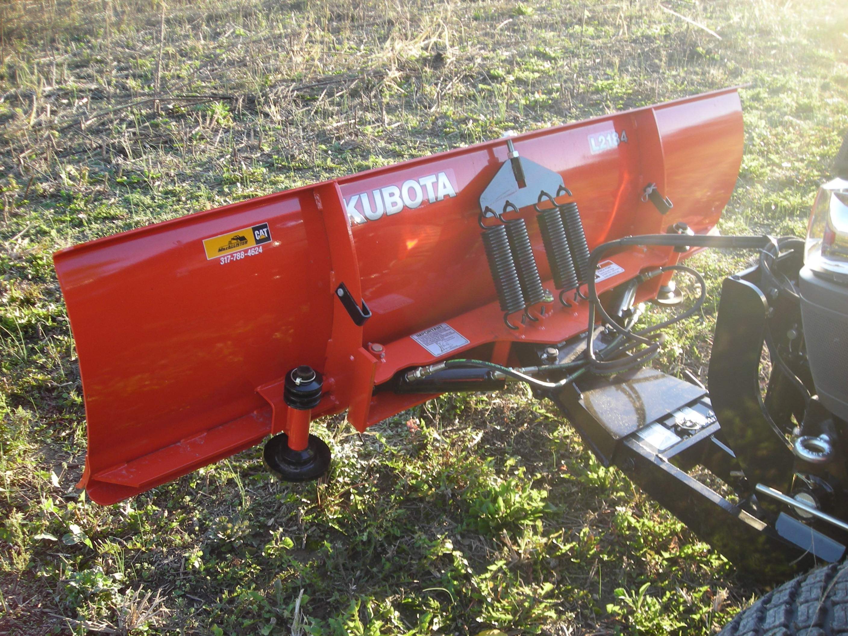

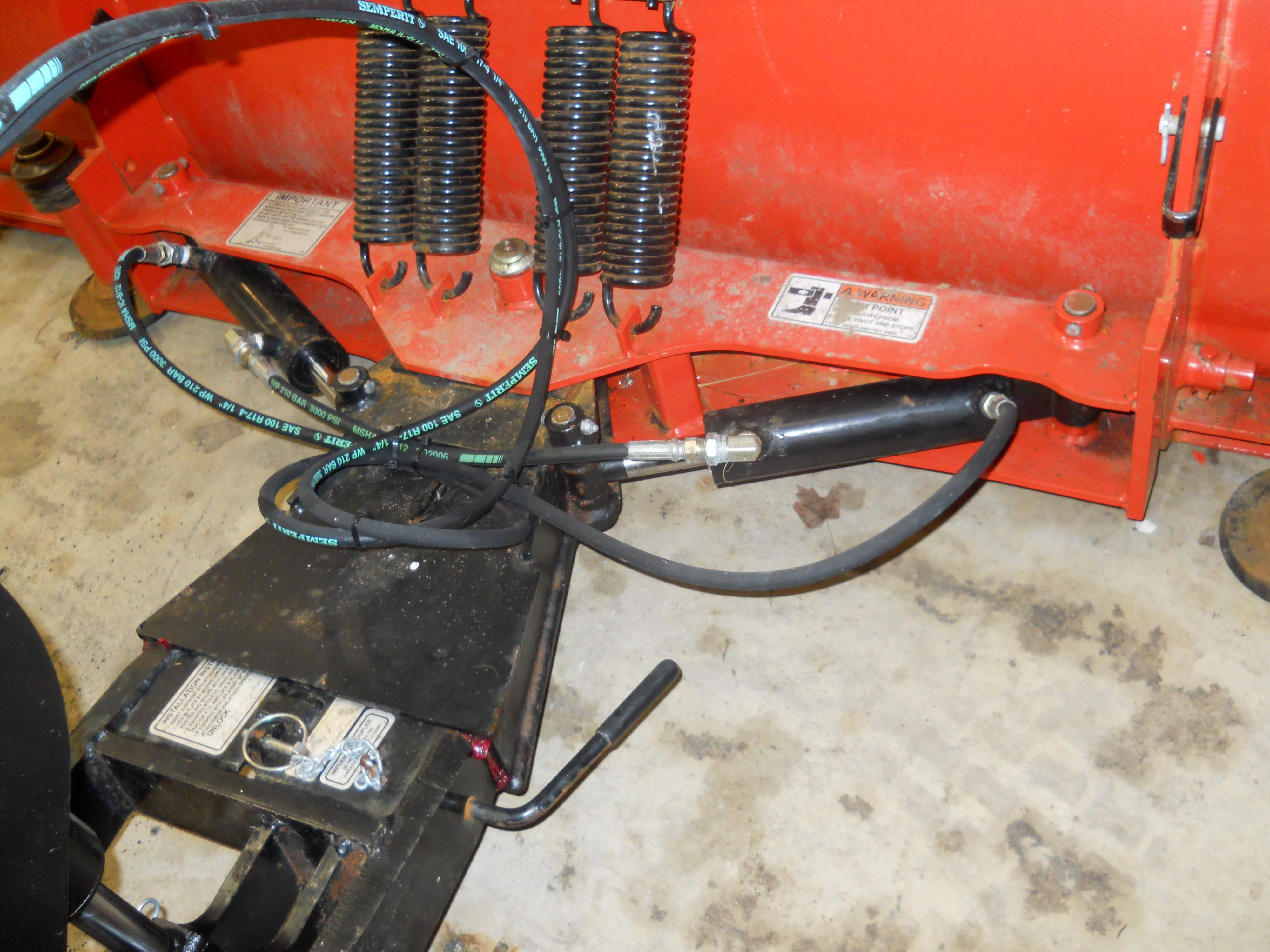

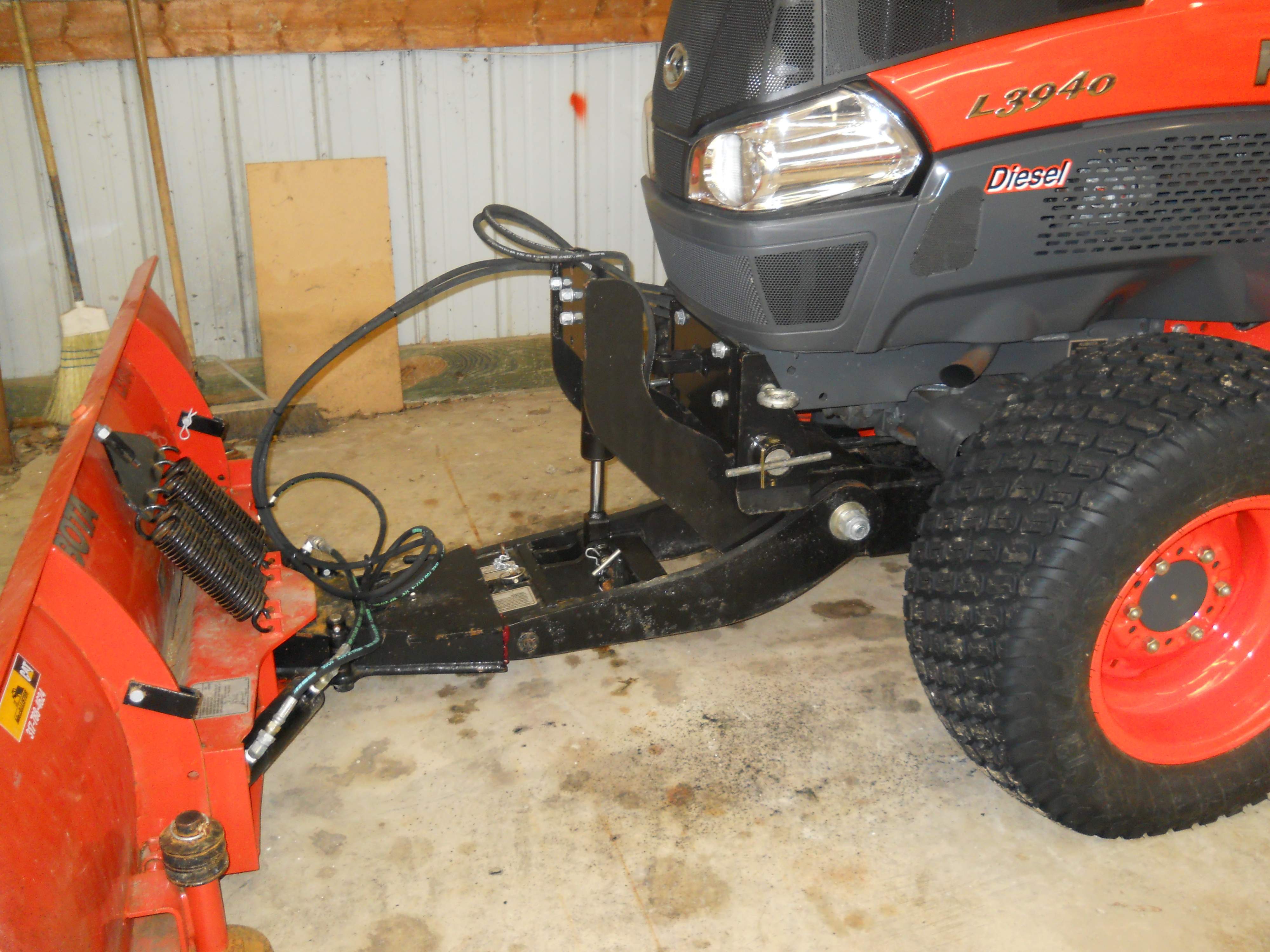

I have 7' front blade, L3940, plus 1200 pound ballast box, total weight +/- 5200 pounds. The only time the front blade steers me is when blade is at full angle and my front turf tires hit ice. It will push anything straght ahead. Here is the hydraulic angle setup on the oem blade. 2 cylinders in series, B port of cyl 1 is connected to A port of cyl 2. A port of cyl 1 goes to one quick coupling, B port of cyl 2 goes to other quick coupling. The only reason to do this is faster cycle times. I do not like it. If I ever have to re-do it, I will make them operate in parallel. Thanks for the nice comments on the old 8N. Now mainly retired since the L3940 came home. Philip.
