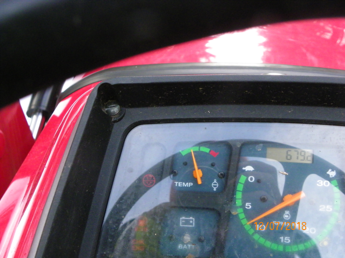

Just trying to understand, do I want to raise the engine temp just to be able to confirm that the temperature gauge is working? Or does the tractor tend to run with a temp that is too low and raising it is good for the tractor?
You want the temp running in the green, from what I was told a cool running diesel isn't good. One of the members posted about some Mahindra models running cool, he's correct on the 4540 without the restrictor.
   / Engine Coolant Temperature Gauge 4540/4550 #12
Here's where our gauge on the 4540 usually runs at.

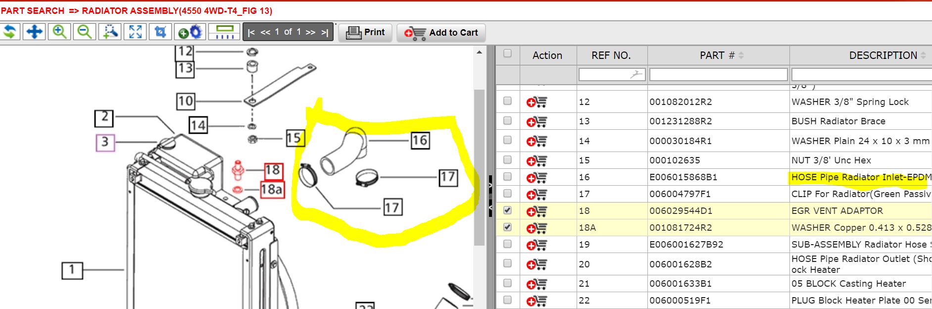

I had the same issue with my 4550. I got the reflash which did not fix it. However, I learned about the restrictor issue from folks here and was able to correct the problem: there is a small diameter hose coming from the top of the radiator to the exhaust cooling system, it is very easy to access. The hose allows a small amount of coolant to by-pass the thermostat. On the hose is a fitting or restrictor that in some cases lets too much coolant through. You can test this by pinching off the hose with a fuel line clamp or vise grips with engine running. If your temperature gauge goes up after 15 minutes or so, then you probably need the new restrictor fitting that Mahindra made available. The Mahindra Part Number for the replacement restrictor hose fitting having a smaller inside diameter is 006029544D.
   / Engine Coolant Temperature Gauge 4540/4550 #18
I should also add that the fitting installs easily with two hose clamps, so you should be able do it yourself without needing a mechanic.
Do you think I would also need a new "hose pipe radiator inlet-EPDM" , or the existing should be fine?
