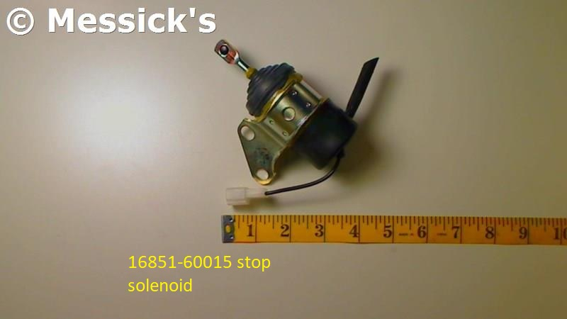

One system needs power to the solenoid in order to stop the engine. Power is applied for about 10 seconds through a controller as to continually apply power would kill the battery.
The other system needs power to pull and hold solenoid open which allows fuel to flow into engine. Often these solenoids have two internal coils. A strong pull in coil and a weaker hold coil.
How many wires are present in the connector to the engine stop solenoid?

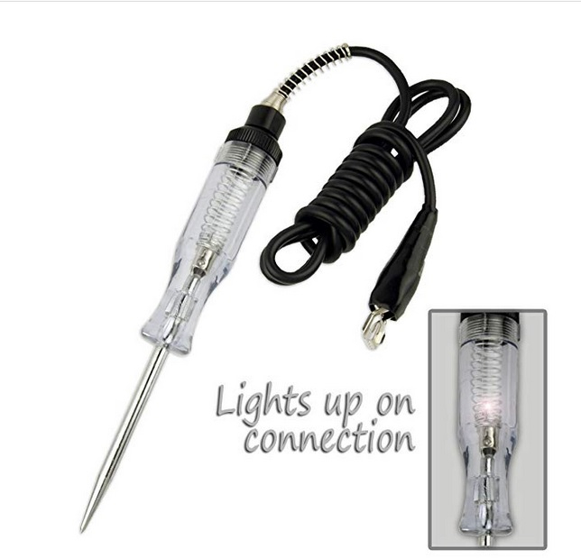

Get a 12 volt test light for around $20 at any auto parts place or on line.
Attach the test light alligator clip to the battery negative terminal and then use the test light's sharp end to back probe probe the stop solenoid connector.
What you are trying to determine is when power is supplied to the terminals in the stop solenoid connector. Any time key is in ON or START position or briefly when key is turned to STOP or OFF position.

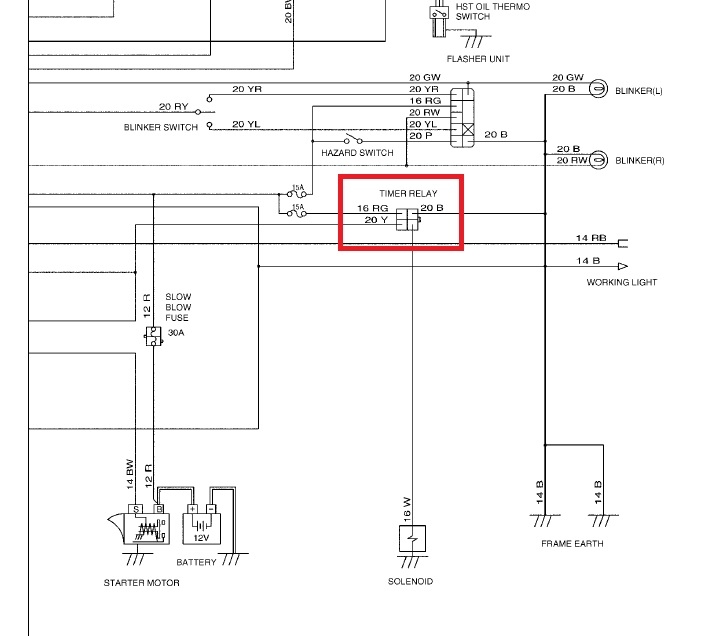

/ Engine doesn't turn off with key turn. #9
A friend provide me access to the BX1500 documents.
There is a TIMER relay controlling the stop solenoid.
Your engine is stopped by the timer relay being triggered and it then applying power to the stop solenoid.
Make certain the 15 amp fuse is OK. If there is power to the relay and the engine is not stopping, check the momentary power out of the relay to the stop solenoid.
