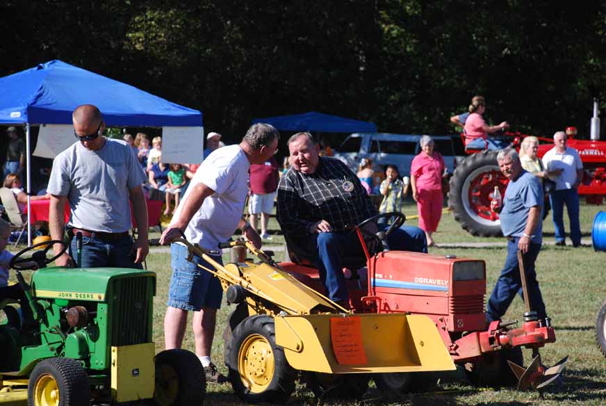

Here is some pic from Richards

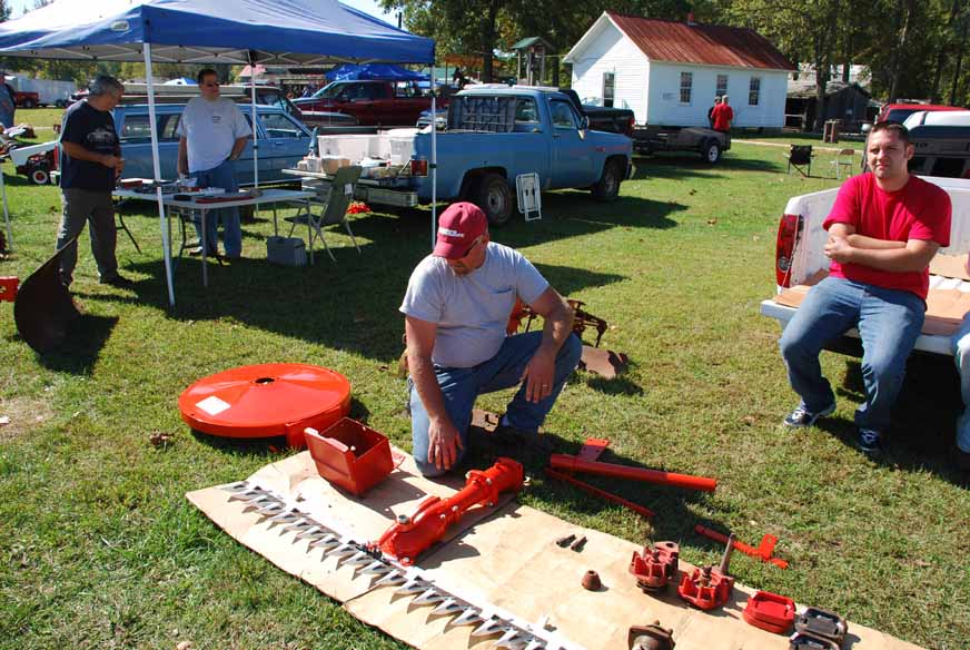

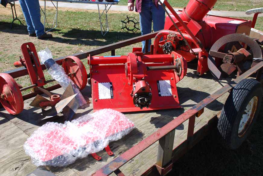

Nice pictures Bruce. The first one is Richards 'booth'. Just to the right is a trailer where he had a large circular saw blade (used) he was trying to sell along with a log splitter attachment. Another guy there had a stump grinder attachment for sale. For those of you who have never seen the log splitter or stump grinder in action there are videos of them on you-tube. Dont have links but type in Gravely and search. The videos are amazing - the Gravely makes quick work of logs and stumps!

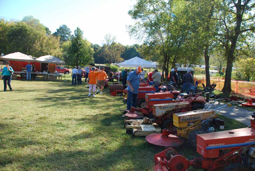

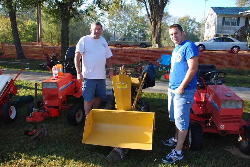

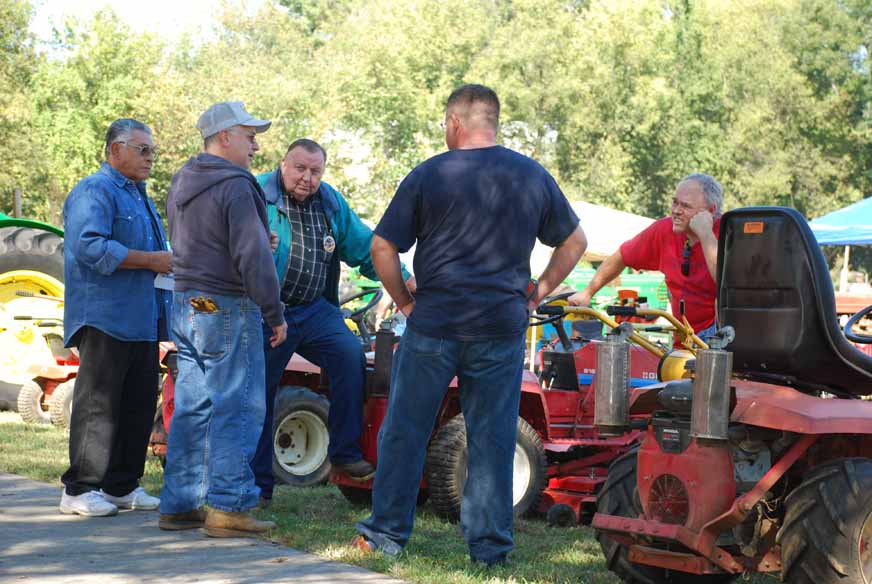

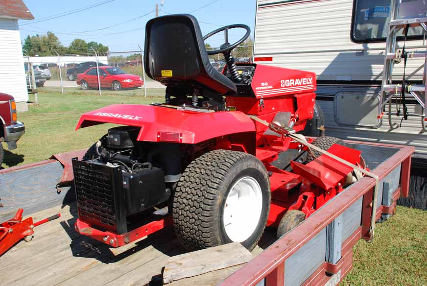

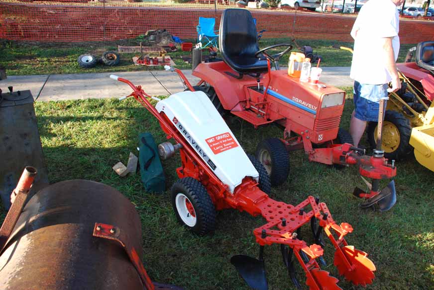

We Had a great week end at the Southern get together.
Here is some pictures

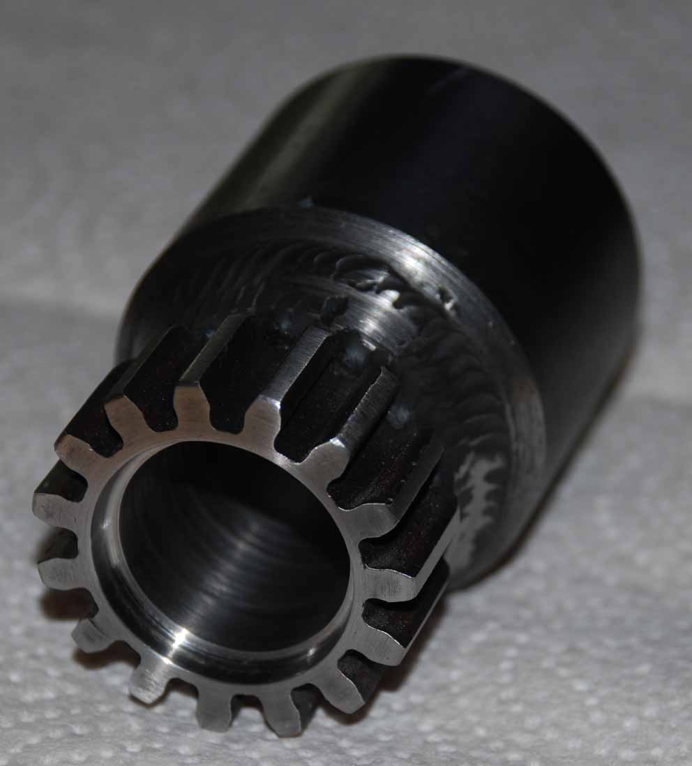

Hi Guys
I finally got a gear done for the L model that I think will work.
I will use a top hat or bushing on the end like Gravely uses
on the late model.
I took a gear Martin S1015
and a 1 inch coupling bored the coupling out left about .002 small.
Pressed the gear hub into the coupling with a key all ready in coupling .
Welded them together.
Bored the gear end out so engine crank shaft can go all way through.
Also machined a pocket in the gear end for the top hat to fit.
Machined off to fit on the engine shaft length.
Now all I like is having it harden.
and make the top hat and have it harden. :thumbsup:

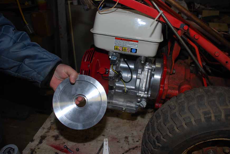

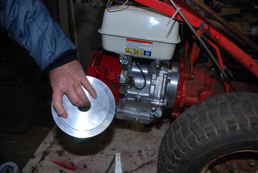

/ Engine ideas #274

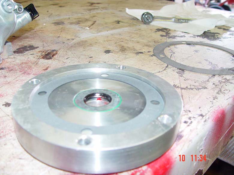

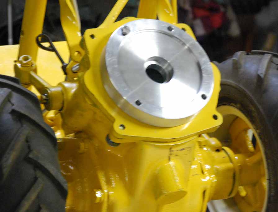

Hi Greg
Right now I have the adapter thickness nail down for the C10.
I am using the old Kohler adapter and making a spacer .
Because the 1 inch cranks are longer.
Now to the L Models.
I plan to use a old Kohler adapter plate redrill it to fit the Model L Transmission
I have not nailed down how Thick the spacer will need to be.
The gear I am having made will fit on all the 1 inch engines.
Some will be different lengths
So I will have to come up with different spacer thickness
Yes I plan to sell the
Spacer ,Gear,and the pilot bushing.
These 3 pieces will run $250.00 plus about $15.00 shipping
The gear is 150 by it self
The spacer is made from a 8" round 2" thick
So it is not cheap.
I can get the muffler cut out for $40.00 swap.

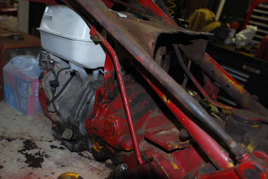

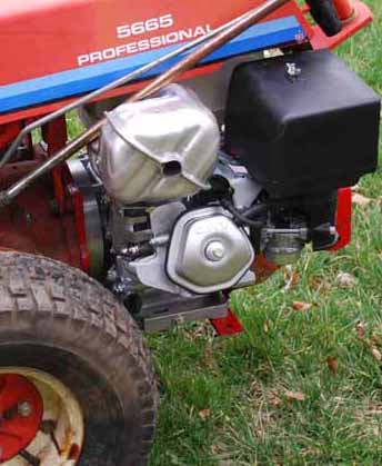

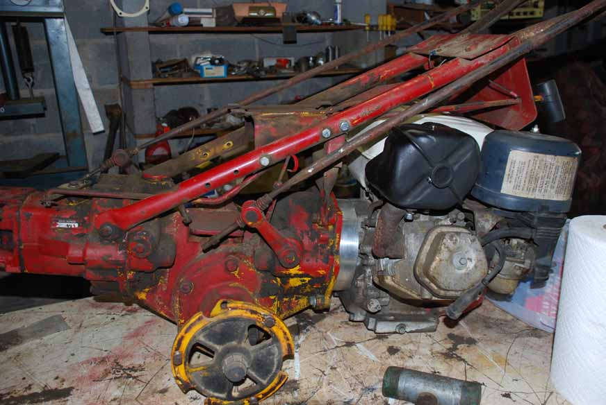

Here is a C10 repowered with a old Honda engine
I had to notch the muffler also.
The engine and transmission is still dirty.
but the picture will give you a Idea how they fit.

This is the C10 That I just got in to change
To a old Honda that he Had bought at flea market for about $150.00
So I am not cleaning it up except where it mounts up.

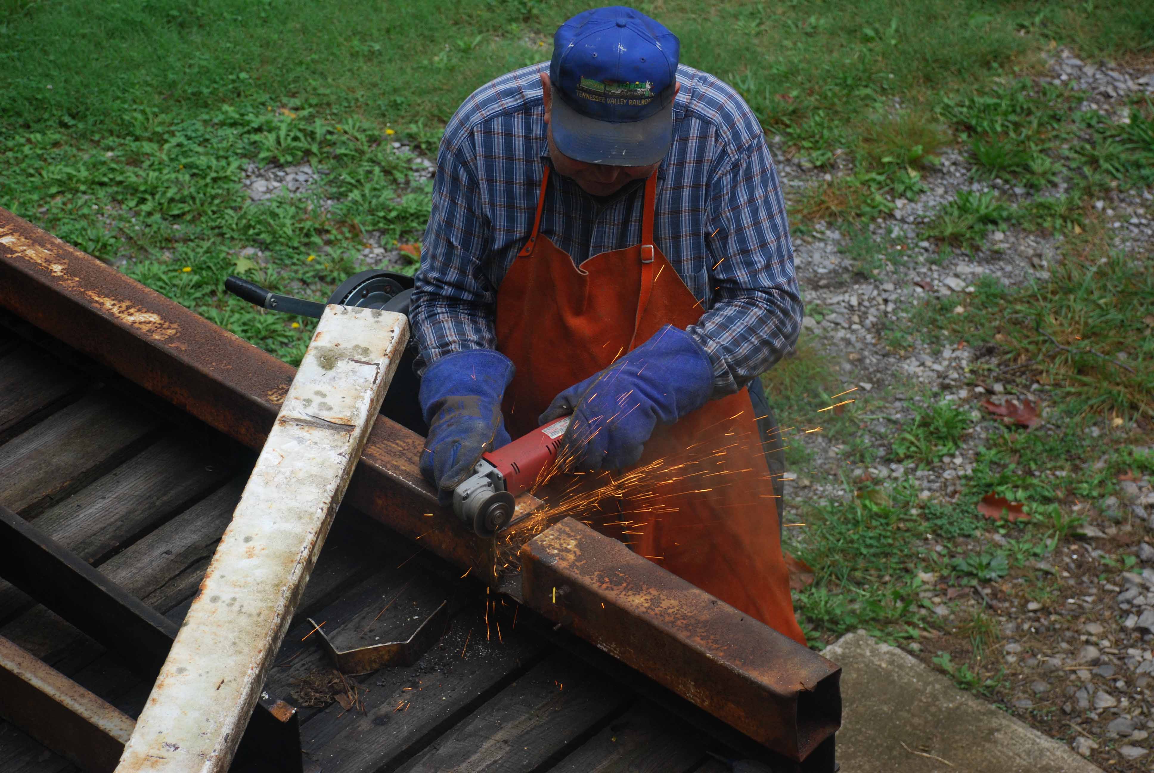

Here is a picture of a speedy cut .
I am using on a trailer frame to cut gaps.

/ Engine ideas #280
Hi One
Did you understand what I was talking about?
The side grinder Has a slitter or speedy cut blade.
The blade is about 1/32 thick grinding cut off type blade.
Will cut anything Hardened Steel ,Stainless steel.
Just don't get anything in the way you don't want cut.
