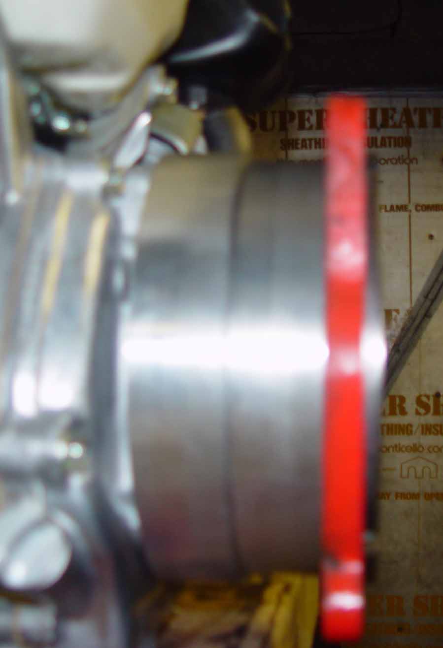

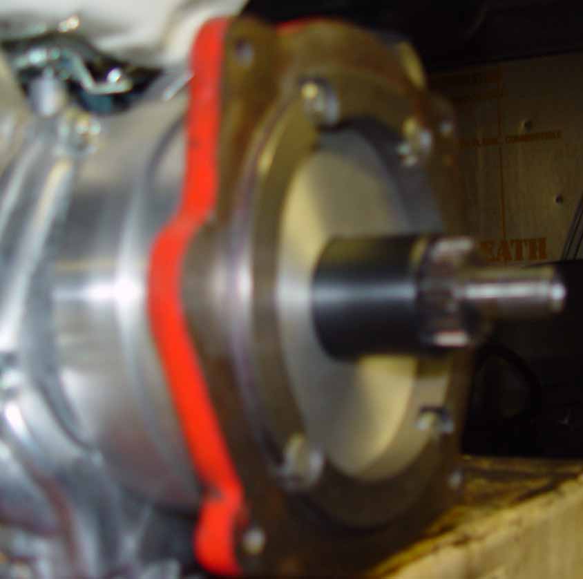

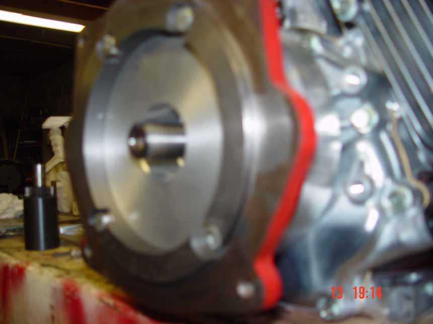

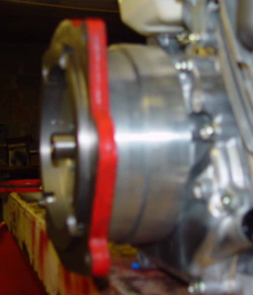

Does it have a 1 inch crank?
I believe the old Gravely planetary will take more abuse then the 2 speed
or double gear will.
Because the small gears that work with them.
But you have to get the power to it
I bored a gear out to 1.1/8 to fit the large engines like the 24 Honda
Also make a bushing to take a 1 inch crank up to 1.1/8
with key 1/4 X 5/16 X 1.

I know that what I'm asking has been answered, it's just that all of these different repowers/threads run together and I get confused. So, since I have a C8 with a Gravely engine, I need something like a "Kohler adapter", a spacer, and a gear to fit the shaft of my engine that will work with the 3600 RPM speed?
- Can I make an adapter out of steel plate?
- Can I get a gear and bore/broach? (I think this 9HP might have a 7/8" shaft)
What am I missing?
Thanks,
Wally
/ Engine ideas
#436
Well 11 or 13 hp would be better as the engines are not run at 3600 rpm but 9hp should work for bout everything cept snowblowing, it would likely work for that also it just might be slow? I have a 12hp Kohler and its rare for me to be at full throttle except for snowblowing.
I know Bruce (gravelymay) uses a Kohler plate and then an aluminum spacer, he has also made the adapter gears for the L models, if you dont have the tools or access to them PM him he was making parts for folks. One could make the spacer with just about anything but the key is to keep everything lined up,, the gear, well others have written their ideas/approach in the thread.
