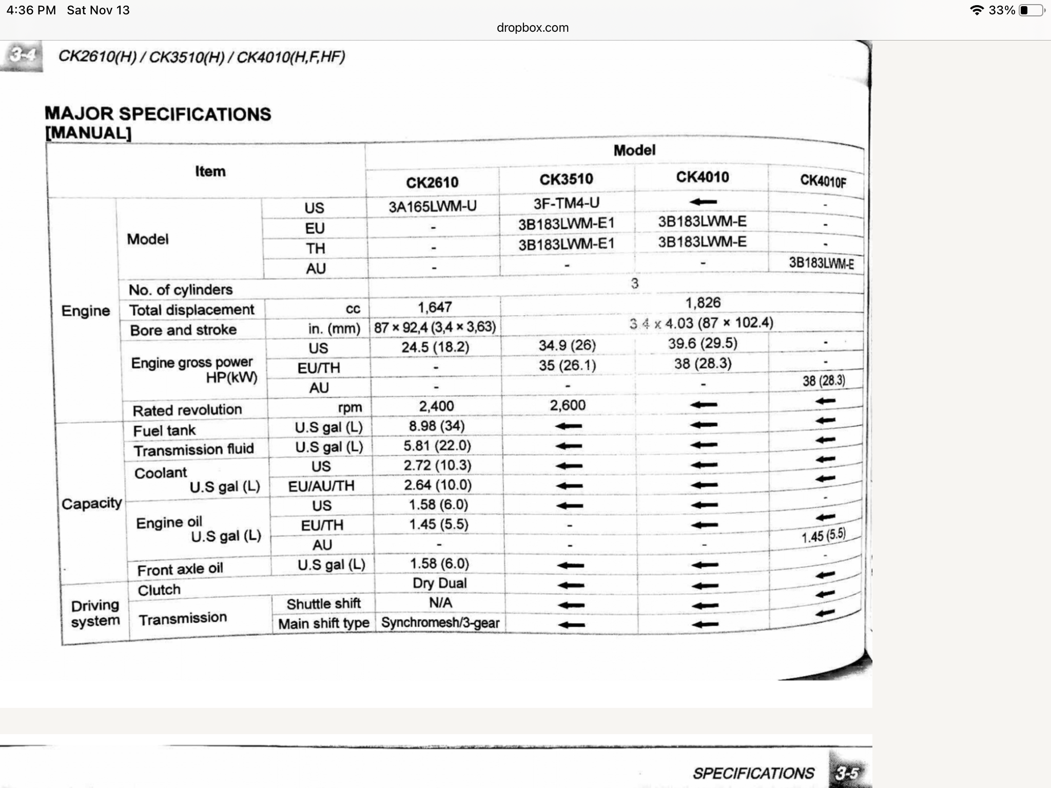

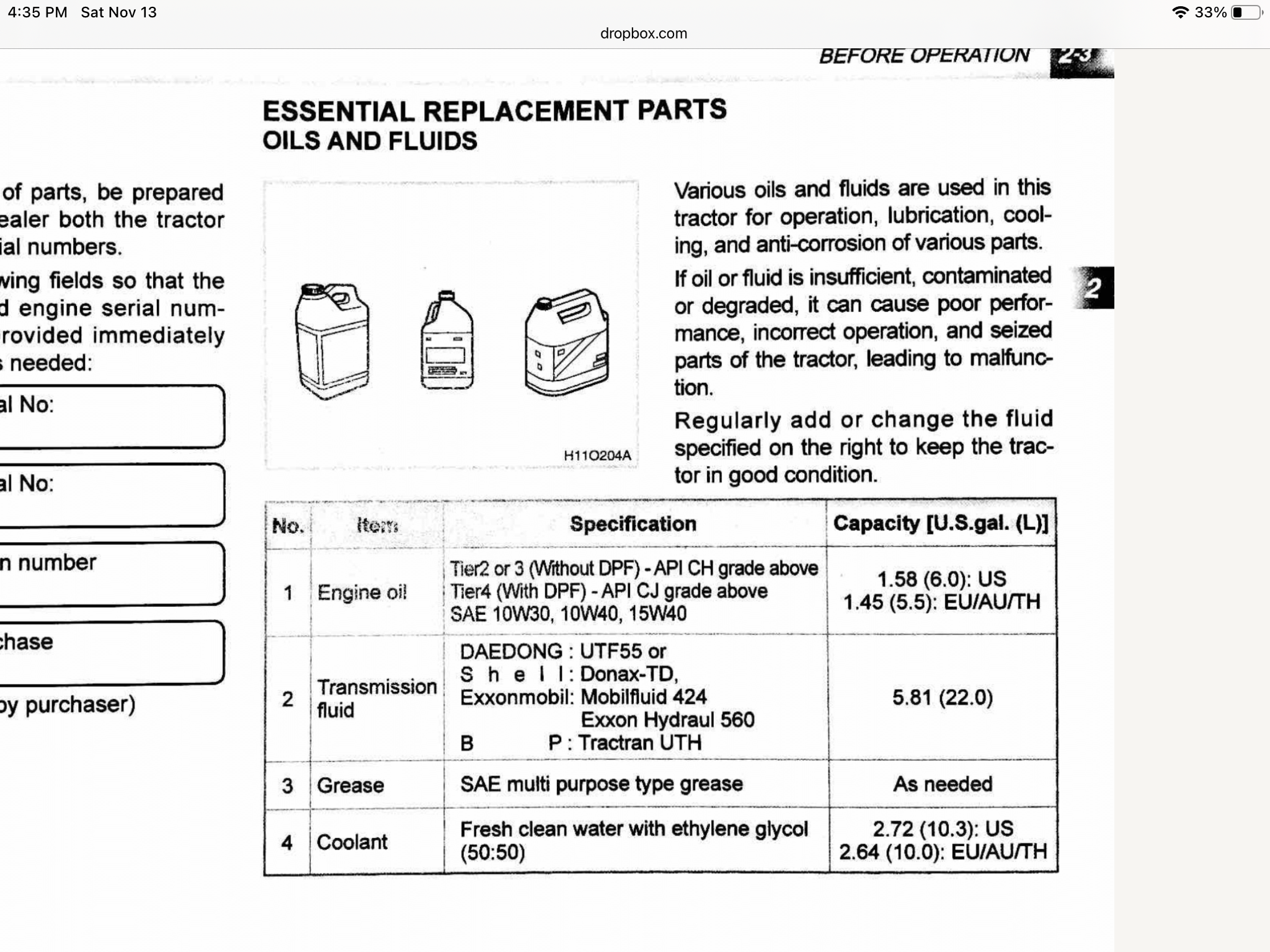

Here’s a link to the manual:
Relevant pages:
The engine for the HST is the same as the manual, so 6.0L of whichever weight you think is best.

I have the Kioti CK2610 and wondering which weight of oil is best in the Arizona heat. Also, how many quarts does it take. I don't have my owner's manual handy.
Well get your owners manual out and see what the OEM recommends! Brand doesn't make a difference. SAE grade, API classification are all that counts. The rest is marketing.

I don't understand these comments on diesel engine oil at all: 0w, 5w, 10w30... in Arizona??? OEM's typically spec 15w40 or 20w50 in high ambients as a safety factor against the environment the machine will live in.
Hockey: find your manual, use a DIESEL rated oil of whatever weight your manual says 'for hot environments'. Know the weakest link in your tractor is typically the transaxle so fuss over those services too. You'll get lots of advice here so you'll have to follow your own judgement.
