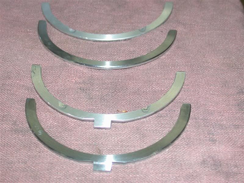

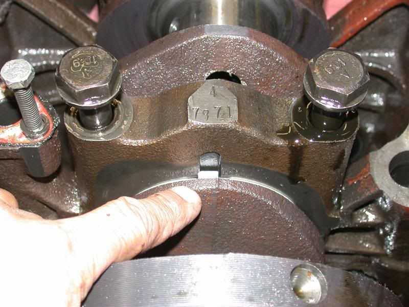

Of particular importance on this engine is journal #4.
That one is where the oil pump starts to move fluid through it and from there into the rest of the oil galleys. Number 4 also has 2 sets of spacers, and one half of each set has a tab. The photos below show those spacer bearings and where they are located. Note that the tab half goes into the cap, which has a pocket for it. There are also oil pick-ups (machined recesses) on both halves of each set. The last 2 photos show that those should be pointed away, to the right and left of the cap, and away from the journal bearings.

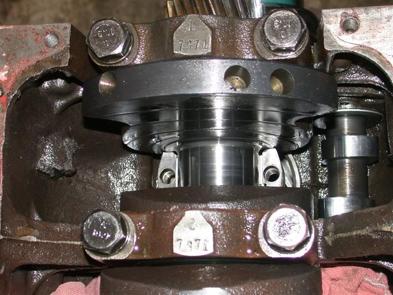

I removed all the crankshaft and connecting rod caps.
You can see from the photos below that the bolts come off with the caps. I had marked each of the rod caps before, and the main caps are numbered 1 through 5. The numbering pad is shaped like an arrow (sort of), and all the arrows must face towards the front of the engine. Also shown below are the new main bearings. One half (the bottom half) has the oil galley hole and internal groove and the other has the start of the oil groove on each end only. That bearing goes into the cap. When installing the bottom ones, be sure to line up the oil galley holes.

After writing down all those details, I finally lifted the crank out.
Shees, it was heavier than I thought. I also noted that each of the main caps were pocketed into the journal web so they can not spring out. They are fit with a slight interference fit. Anyway, I got the crank out and started to remove the pulley bolt and gear to put on the new crank. I wore my best flannel for that picture. :D

   / Engine Overhaul Kama 554 #215
Those half moon "washers" Robb, are the crankshaft thrust "washers" bearings. When the engine is running, or especially when the clutch is depressed, those washers take the load of the throwout bearing pressing onto the pressure plate, attached to the flywheel, bolted to the crankshaft. There is a slight thrusting of the crankshaft while the engine is just running, and a greater thrust when the engine is under load. They are constantly flooded with oil. Volkswagen diesel engines have the same type of thrust bearings.

#217
Thank you IH3444,
I saw there purpose upon dis-assembly and figured they were a spacer of some sort.
There was no other method to keep the crank in position ... no other method to keep it moving forward and aft, relative to the linear axis of the crank. I neglected to make the connection between the clutch and TOB, and that those washers would then act as thrust washers as well. Never even crossed my mind. Not all spacers/washers do double duty like that, so thanks for pointing that out. (Another thing I learned)
Very clever design work on their behalf.

   / Engine Overhaul Kama 554 #218
Rob, see the little "divets" on the washer. That allows and directs the oil to the crankshaft thrust surface. I'm certain you noticed that already. Just besure to install the new ones the same way. Great job as always. ;)
