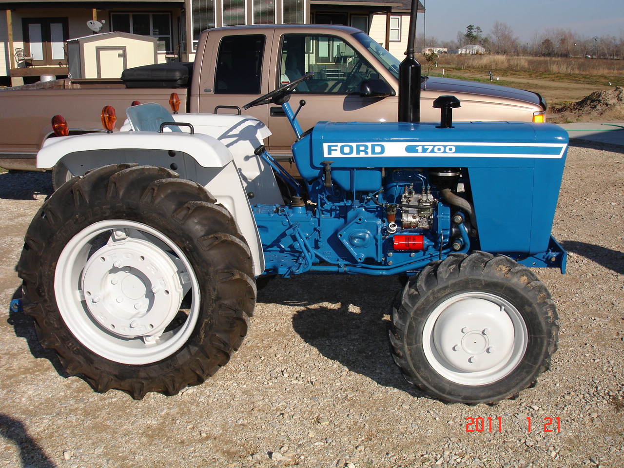

There's a new tractor roaming around the neighborhood. Here's a picture after we got it running yesterday.
Next is to rebuild the front end loader and then the mower. They will both get a paint job to match the tractor.

1200 hours is not a lot of hours. That piston would look like that from overheating or oil starvation, neither one is good for long piston life.

Piper, nice tractor results. :thumbsup: Also like your avatar :thumbsup:

Outstanding job!
You will get many years of satisfaction from that old tractor still.:thumbsup:

cool:) looks great piper.

Wow...that looks like new. Now you have a tractor that you KNOW what has been done to it! I bought a 1920 a few months back. I bought it from a woman...which at the time I thought was a good thing. Bad mistake. She never changed the hydro fluid and the rest of it just looks neglected. I wish I would have passed on that one.
