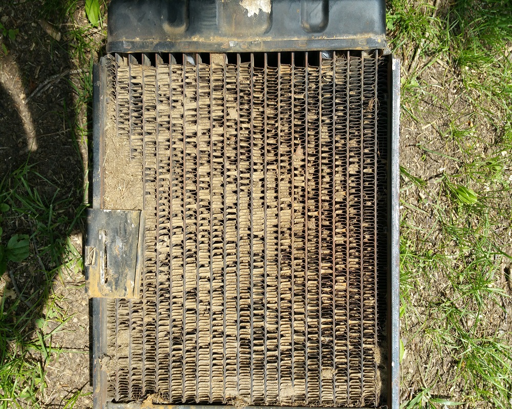

Thanks for the help on the cap Jerry. It is nice to know how to check them now. Yea I think the radiator and air filter was really putting a massive strain on that poor little tractor! You might be right on the motor not needing to come a part!
Here is some pics of the coolant side. It needs to be flushed and cleaned. radiatior 5.jpgradiatior 4.jpg

WOW- Can't believe the PO didn't clean or replace the rad before ripping into the engine...
That rad looks badly plugged and almost like Mud in between some of the cooling fins. Can't see how it could do a decent job of cooling the engine.

With the list of stuff you already have on your to-do, that little tractor will be happy as a clam. You can honestly probably skip a bunch of this - your cooling problem will be VASTLY improved just by hosing out that radiator (not too high of pressure). Just let your wallet be your guide. Stuff is way easier to have done when it's apart already, and re-disassembling is a pain. Doing everything on the list so far, except head milling and radiator re-core/replace should be reasonably low cost. Since it did likely overheat a LOT, checking for warpage and liner seating is justified. Two-cylinder heads DO warp if abused enough - even single cylinder sez some of my old motorcycles and lawn mowers.

Here is one more pic of the radiator...I think you can see the amount of junk in the fins better in the sunlight . The pics dont do it justice..this thing is packed tight as a tick!
