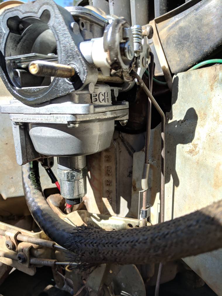

When I pull the carb off after failing to start, a bit of gas dripped out from the front of the carb where the air box goes.
Here are some carb pics.IMG_20180421_162601.jpegIMG_20180421_162703.jpegIMG_20180421_162646.jpeg

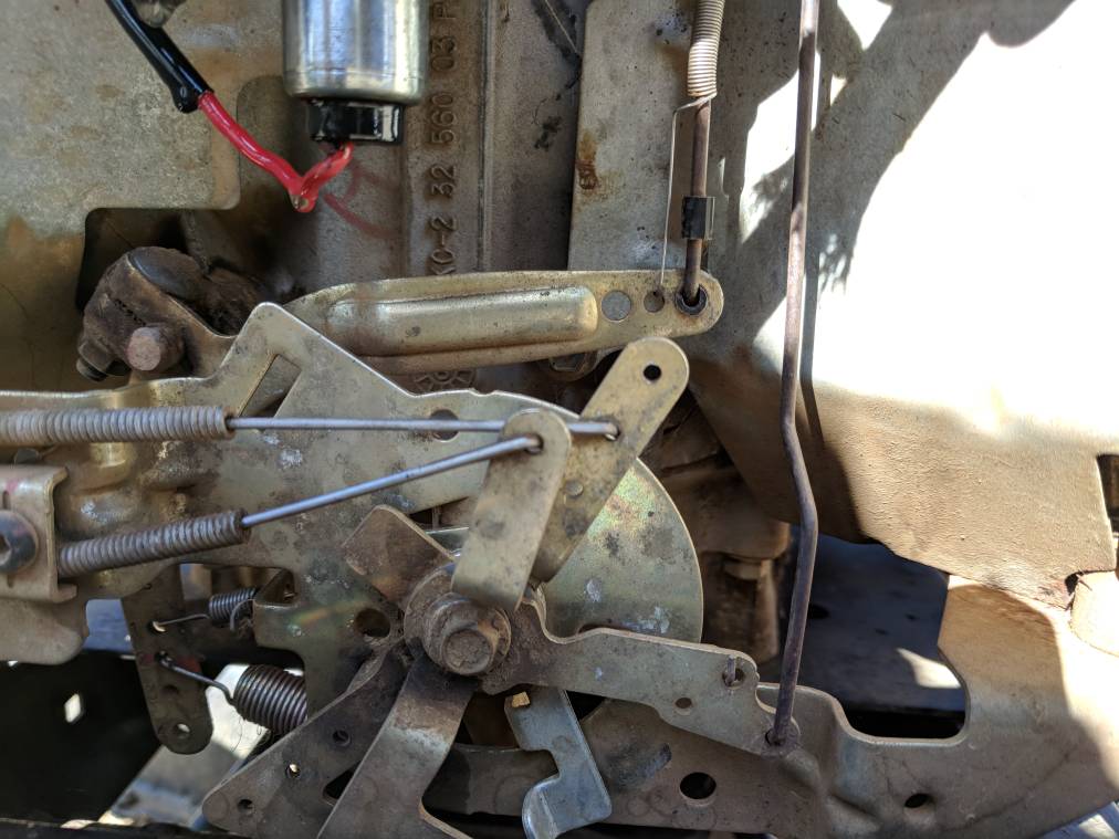

My guess is that perhaps I've got the throttle linkage hooked up wrong (throttle is the vertical rod in the back, with the little spring next to it / on it; the vertical rod in the front is for the choke, I'm pretty sure - the front rod actuates a butterfly in the front of the carb closest to the air intake and the back rod actuates a butterfly at the rear of the carb where the mixture exits to the engine intake manifold), or that one adjustment screw way off.

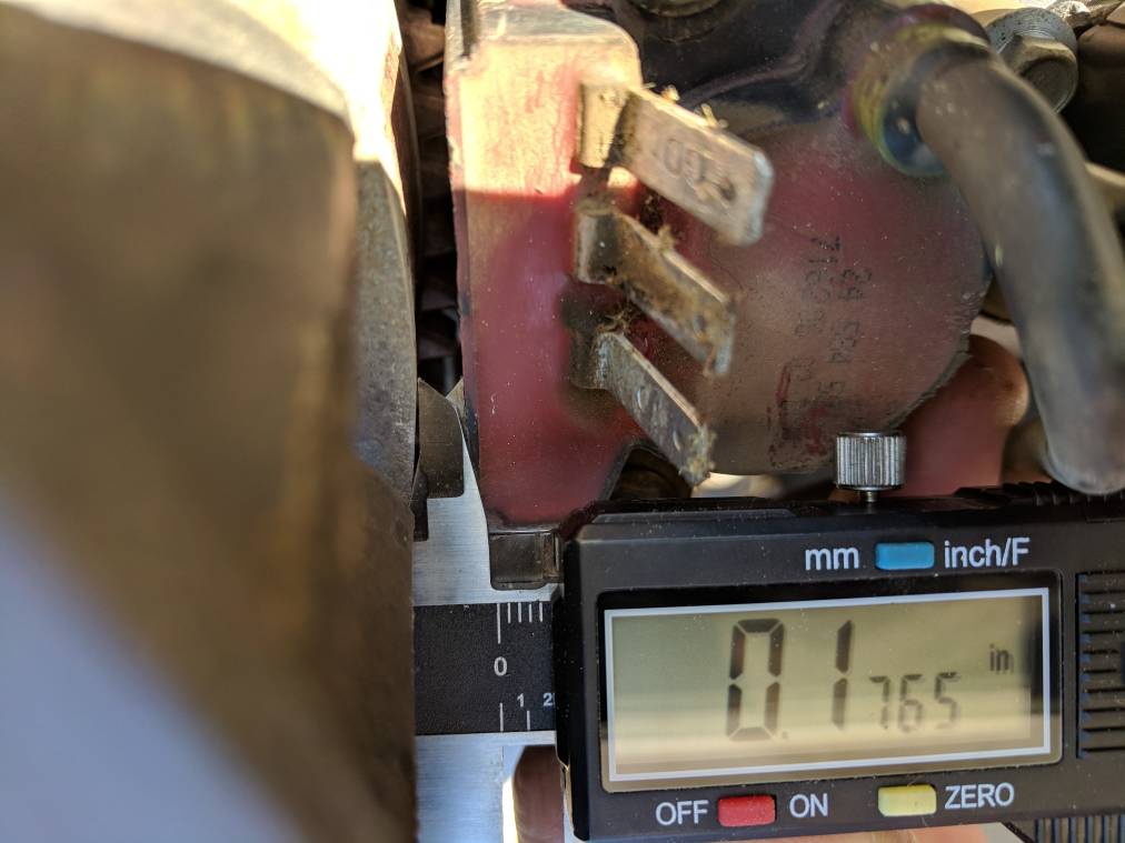

I'm curious about the current things - are they not driven by the magnets on the flywheel? The reason I ask is, there's a huge gap and they don't seem to be adjustable.IMG_20180512_092148.jpeg
/ Engine runs rough for a while, then smooth for a while, repeat #20
Should be .012" on a SAM system. Can you rock your flywheel back and forth like the upper bushing in the case is badly worn? Otherwise they are slotted to make the adjustment.
