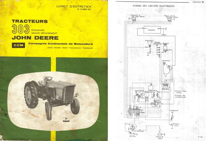

Fuel at the pump, so should be OK cranking (I wish), cold here so battery not turning over motor very quickly...luckily ran out of juice outside house...
That is more than likely your key problem. Low cranking speed and lo temperature gang up to prevent compression ignition. Use 5W40 oil to reduce cold cranking resistance. You may get another year on the battery.

Update:The manual mentions a pre-heat on the ignition key (pressing in? my French isn't very good).

Further research indicates your tractor has a Standard 23C engine. I hope these paragraphs apply to your engine.
Glow plugs were factory fitted on Banner Lane (UK) produced tractors with the 23C engine from 1959 onwards. Maybe some export markets remained without?
While the Perkins starts much better, I would prefer the Standard engine if I want the tractor for show or playing. It runs much smoother and quiter due to its four cylinder. Engines with a strain number of cylinders will always run smoother. But for work a Perkins modell will be the best. Parts are available through Sparex-UK - are they in the Staates too?- or the major UK Ferguson parts dealer. Look at www.fofh.u-net.com for them.
The 20C engine was used in the TE-F while the later 23C was used in the Ferguson 35s and early MF35s.
