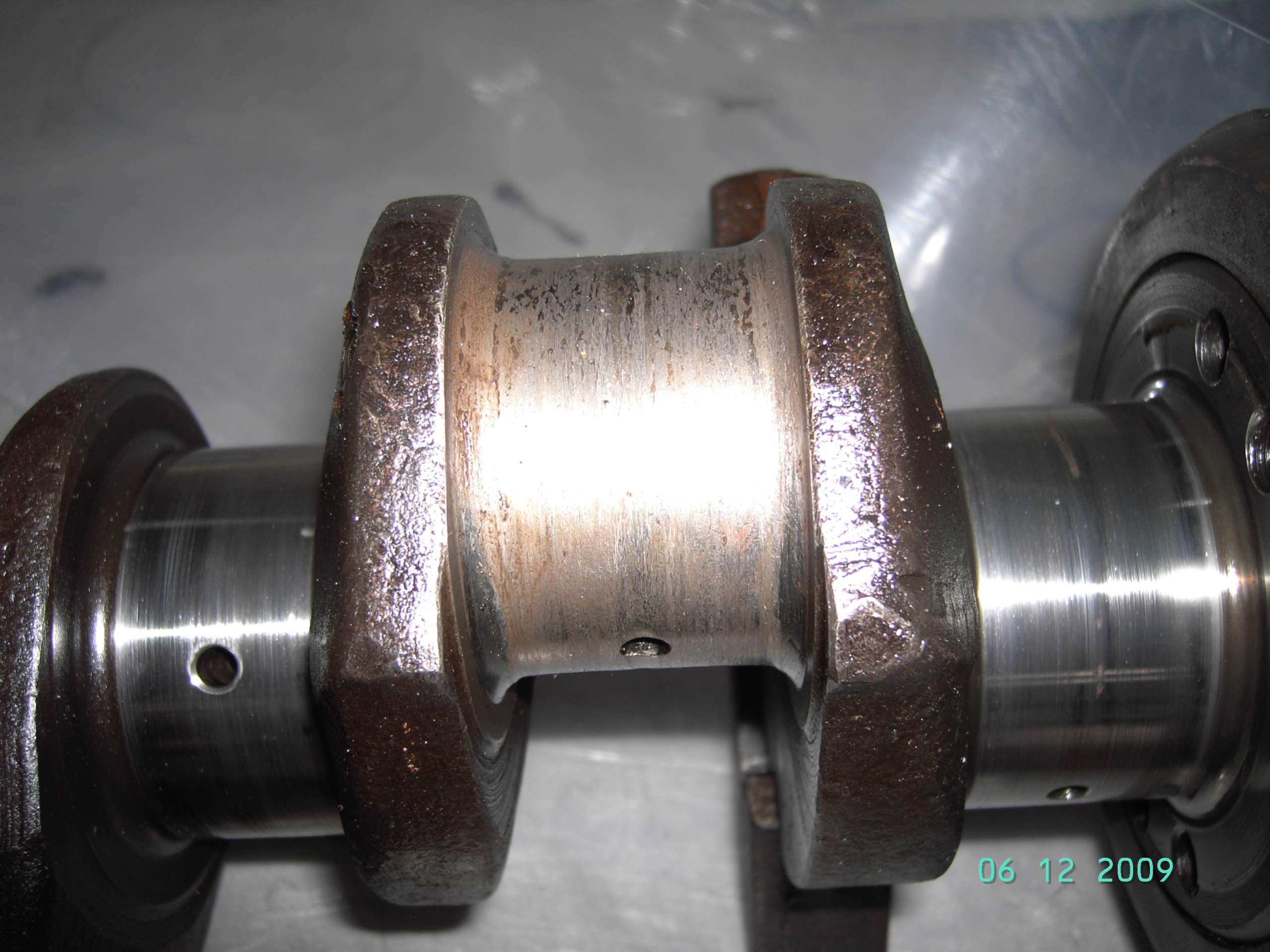

all,
a short up Date overhauling my Zetor engine.
I have put the crankshaft to the maschine shop yesterday for grinding.
But got bad news, one bearing pin is so badly damaged they can not grind it anymore.:mad:
So i am looking for a used or new crankshaft and a con rod as well.

3011;
I hope you can find the parts you need. That crank journal may be repairable by welding and regrinding. Can't say much about the rod though. Good luck.

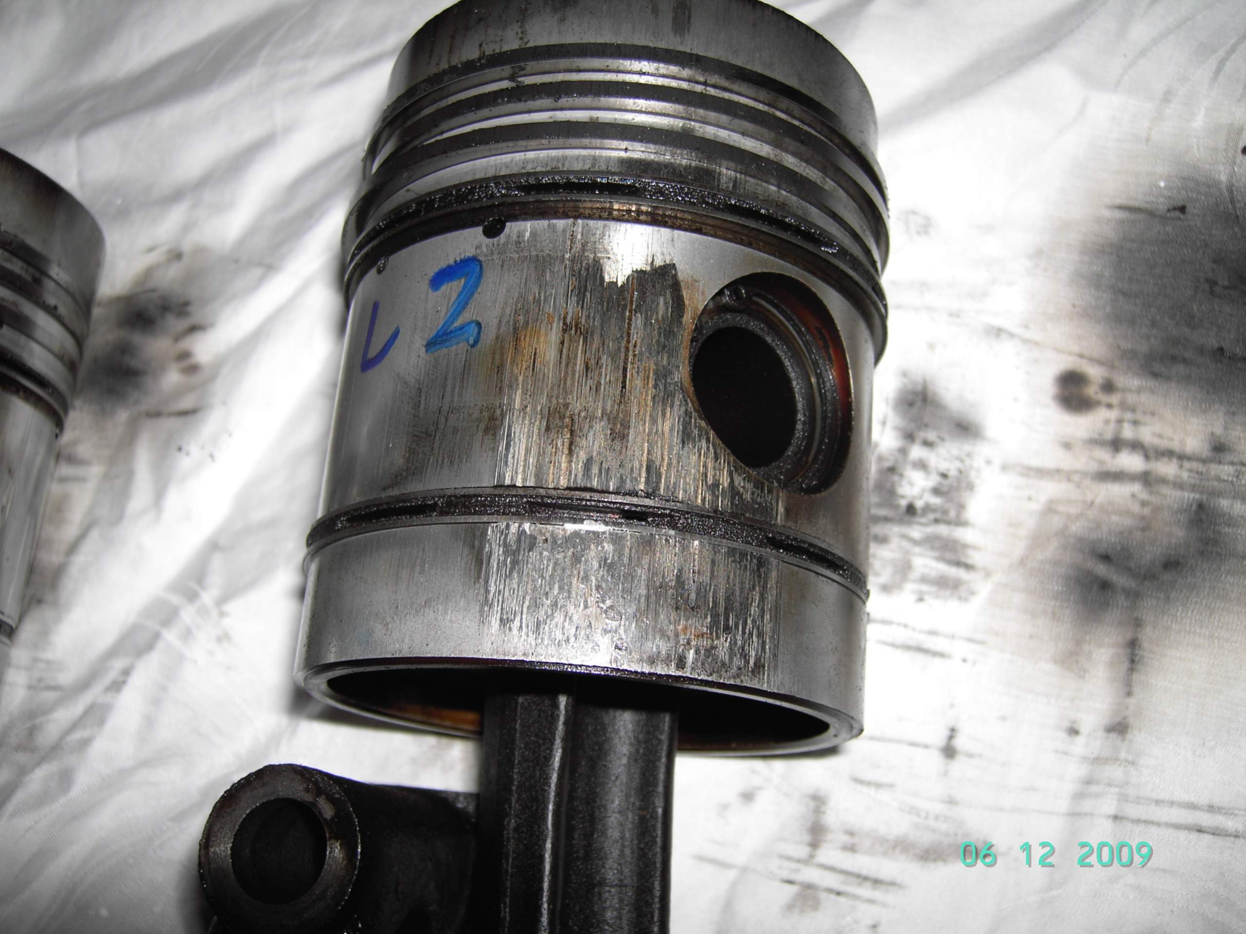

/ engine with bearing failure #8
What does the cyl wall look like from that scored piston? What does the rod and cap look like? Was there still a bearing in the rod assembly? That journal does not look as bad as your piston, and if all else fails try to clean it up and check to see if the bearing clearance is within tolerance. Its OK to laugh, because I did. I have put one four cyl truck engine together (at the request of the customer) with two journals that were worse than yours. I cleaned them very well with fine paper, plasti-gaged the rod bearings, and torqued it down. The engine was so tight that the starter would not turn it, but we started the engine by towing it down the road an popping the clutch. After running the engine for several hours at an idle, we shut her off and it started with the starter. We changed the oil again and, laughing, said "good-bye" with no guarantee's to the customer. I didn't believe it when the customer drove in 5k miles later for an oil change. If you cannot find a new crankshaft, try it, short of a short/long block, you have nothing to loose.

Hi fjp2,
the cylinder wall isn't really bad. They are even exchangeable. But the pistons come in sets together with piston pin and cylinder sleeve. No big difference in price. So i going to buy it complete.
The bigger problem is the crankshaft.
There was no bearing /shelf in the rod anymore. The previous Owner took it out. The journal of the crankshaft is oval grinded and there is about 1,8 millimeter metal from the journal shaved away the guy at the mashine shop said. There are no bearing shelf on the market who can equalize the difference.

3011, the bad connecting rod bearing journal can be welded up, and then reground back to stock specifications. You need to find a shop with a stellar reputation for this type of work. You may find a useable crankshaft before you need this fall back position. Good Luck!

I much rather you did find a usable crankshaft, or a new one. As mentioned, crankshaft welding up is a last resort, and must be done to the highest standards. It is almost never as good as a new crank, or even a good used one.
