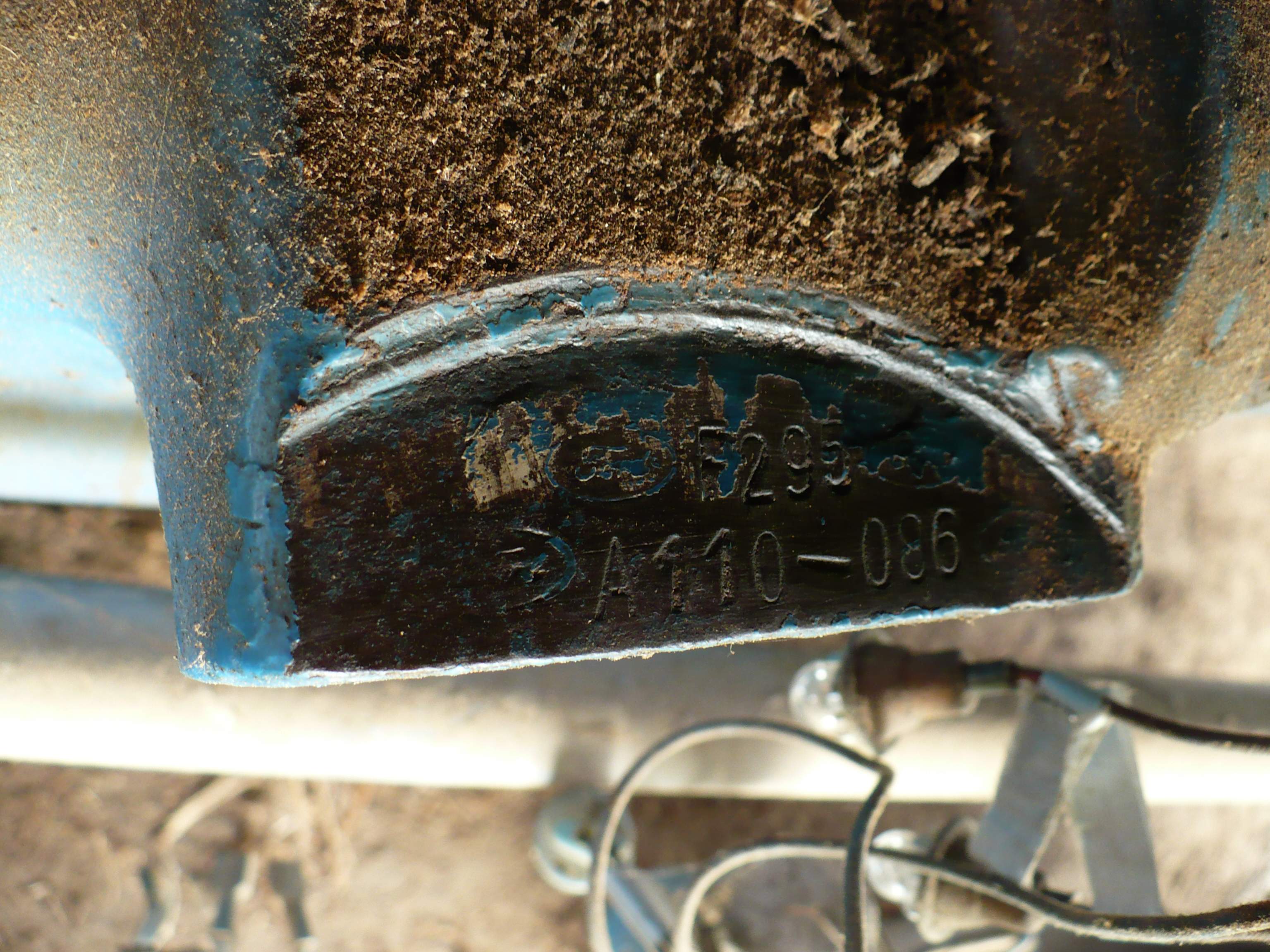

post a pic of the machine front and side
post the number on the trans bellhousings.. there will be 2-3 rows of stamped numbers.

Here are the requested id numbers. Thanks everyone for the help! F295 A110-086

Upon further investigation, another set of numbers was located above the posted numbers. They are...5 F 14 C. Thanks.
