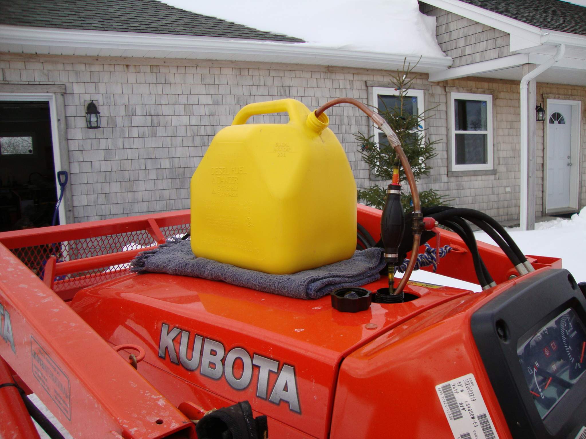

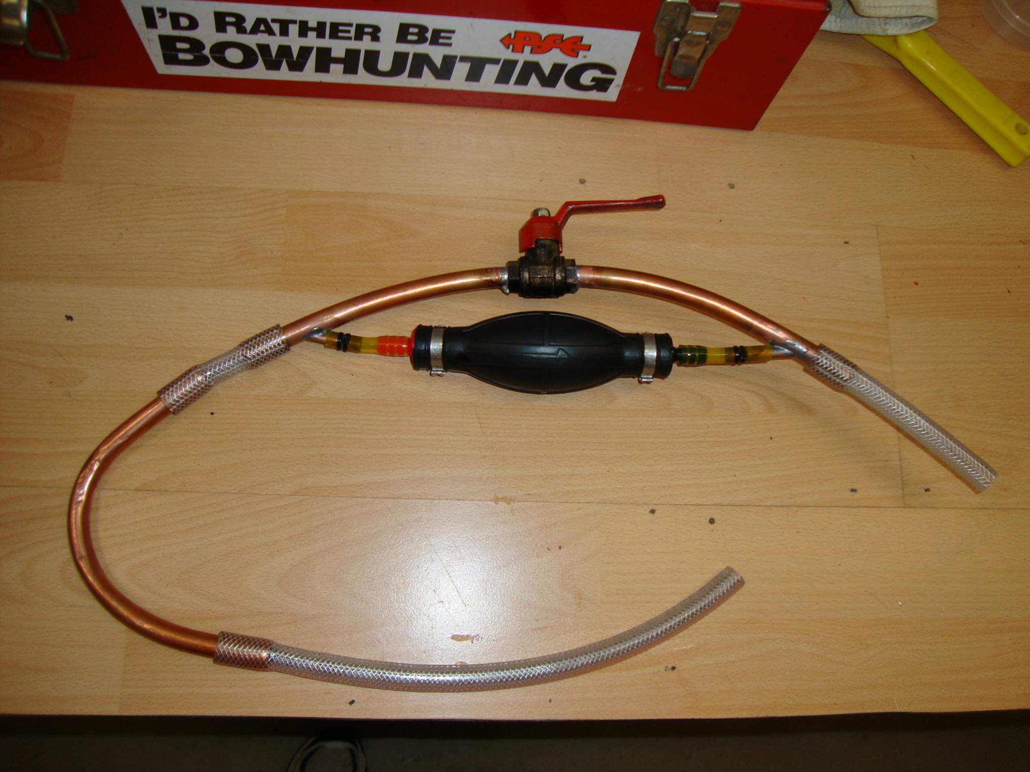

If you're handy with tools, this is fairly easy to build. You set the full fuel container on the hood (in the case of my L3400) and remove the cap. Stick the plain end in the can, the end with the valve in the tank opening, close the valve and pump the primer bulb a few times.
Once the bulb has fuel at that point, open the valve and wander off to do whatever else you have to do.
As long as there's room in the tank for the fuel in the can, it'll siphon happily by itself til the can is empty. If it won't all fit, just close the valve to stop the fuel flow.
I built this after nearly falling off the front wheel a few times with wet slippery boots on, trying to balance a 5 gallon can full of diesel and not spill any.

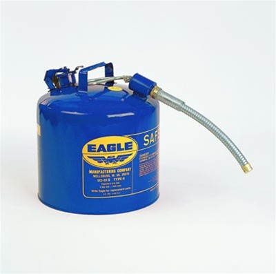

Hello all, brand new to the forum and was wondering if I could pick your all's brains. I have a brand new JD 2520 (haven't even had time to post pictures yet!) and need to find a functional diesel can to store diesel in for her. My dad has a couple of older cans that don't have the government's "Enviro Flow" valve on them. Been just taking his diesel, putting it in my tractor, and then re-filling his can because I'm not a fan of the new valves. I have a one gallon enviro flow for my Stihl weedeater, and even with that small of a can I always manage to spill more than I do with the traditional spouts.
Here is a link to one at Tractor Supply, and the review there from another customer is exactly how I feel. I don't want to be spilling diesel all over the hood of my tractor, floor of my barn, driveway, yard, etc. Does anyone know of a "new" can that is functional and practical? Or do I just need to hit the yard sales and flea markets?
Blitz 5 gal. Enviro-Flo PLUS Diesel Can with Flexible Spout - 3950880 | Tractor Supply Company
Thanks for your help!
Here is what I use.
