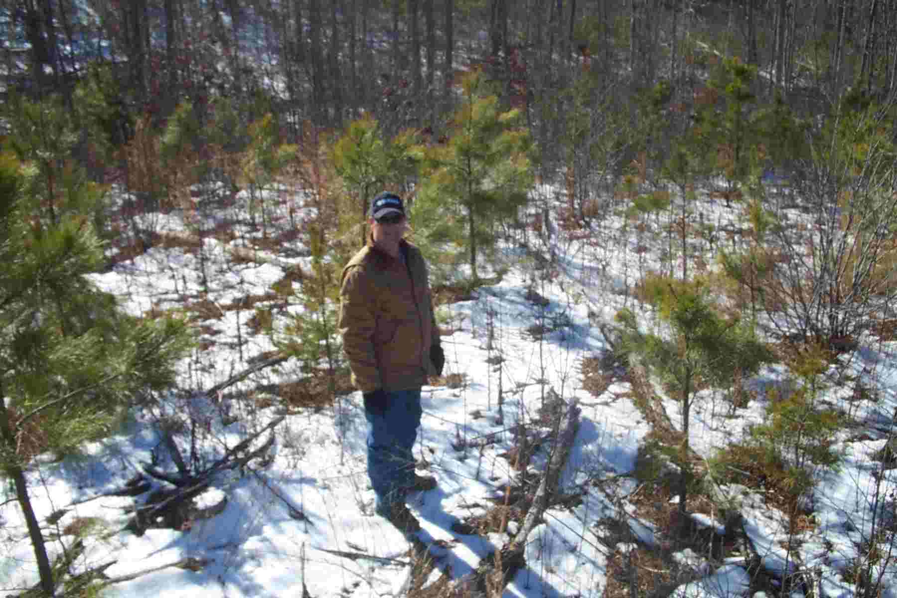

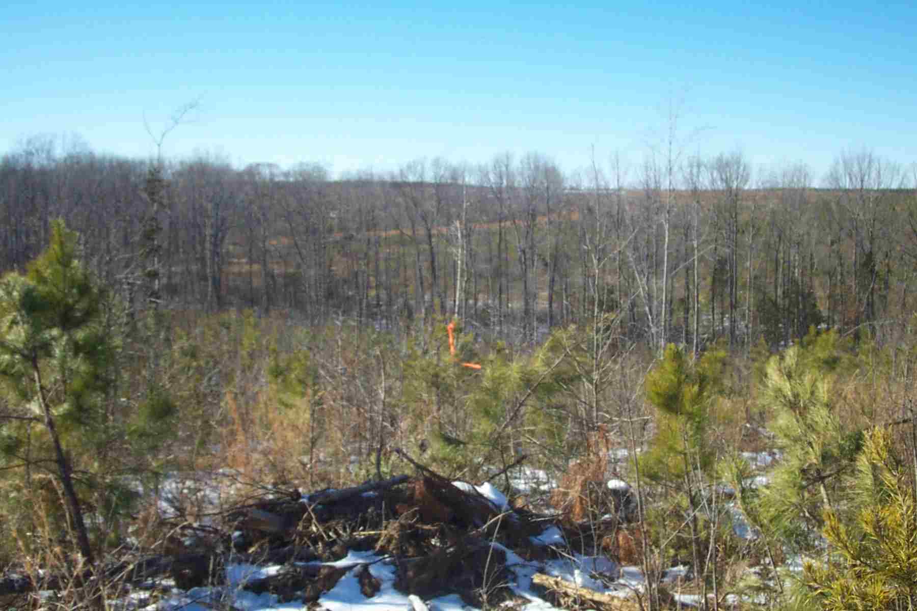

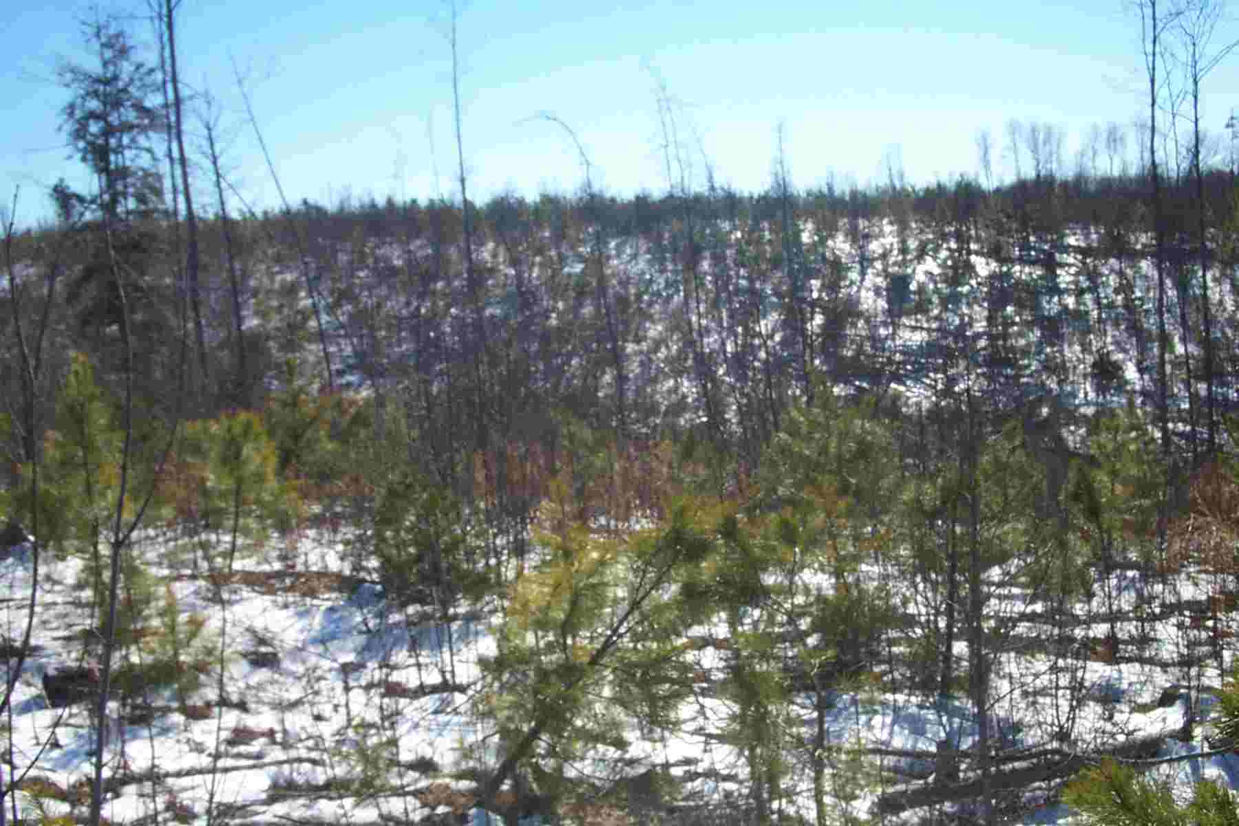

Well, I went back to the property today and walked around a bit and took some pics. It is amazing how easily I brainwashed myself into thinking that the land would be a breeze to clear. I said in earlier posts that the pine were very very small...wrong...7 feet tall; the stumps were flush with the ground and 6-8"...wrong...they are not flush with the ground and many are closer to 1'1/2 round; oh well, that IS a lot of work! I will attach some pics so that you can see some of the property. Most of the big hardwoods are on the property lines or along the creek.
Todd
