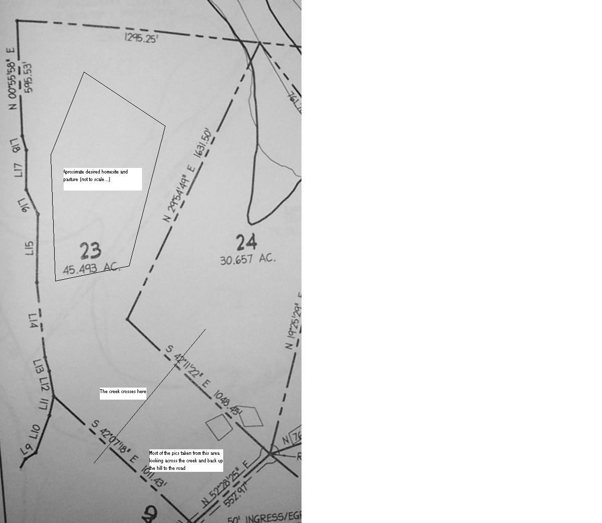

Thanks everyone for the replies.
To answer some of the questions concerning amount to be cleared I only need a road, bridge, 7 acres + the homesite (10+- acres) of area to start and a bridge over the creek to get to the back area which is where most of the land is located. I have attached a plat of the land for you to see with some short notes.
Thanks again and I have been looking at dozers to buy or I might do what Beverage Tractor recommended. Rent a dozer for the weekends at 275 a day and only be charged for the weekends as long as I place an order for one of their tractors.

Thanks Mike. A land buyer bought about 1200 acres from a logging company back in july and created a tract with about 25 lots of 20-80 acres each and mine that I just bought was the last one. I'm just north of Lake Anna state park off of routes 601 and 721.
To answer your question about time, I'm not in any MAJOR hurry but I would like to have the 10+- acres done and the home/barn built at the latest by next summer.

For 10 acres,you would be ahead to hire a dozer operator.
1. A professional operator will run the dozer a lot more efficently than you as a novice.
2.The hired cost of the dozer operator pays for everything.
Where I live renting a dozer costs not much less per hour than me hiring a dozer operator to bring his own dozer.
If I rent a dozer I pay for the fuel in addition to the rental fee of the dozer not to mention my low experience of operating a dozer,I would spend several hours or maybe days to get proficient at operating the dozer.
Then there could be breakdowns where the hired dozer and operator would be responsible for that.I am not sure how breakdowns are covered under a rental dozer.
If you hire a dozer operator and his dozer,if you are like me you will want to be there the whole time he is operating his dozer,because he will have questions/you will have questions and it is fun to watch him work and you can still stay busy lighting of a brush pile or 2 while he continues running a dozer.
If you want a small road or 2 put in or your land a good dozer operator will make one and ditch it properly etc...
