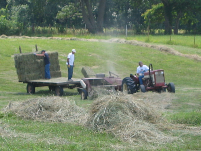

That's crazy talk picking square bales up off the ground by hand. We pull a rack wagon behind the baler and stack on the wagon right out of the baler. We have three wagons for this use and they are good for a lot of other things as well.
Dan
