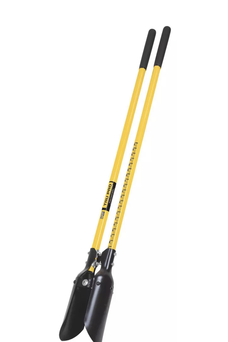

A 3pt auger is perfect for you. I would expect there will still be some hand digging while cleaning up a hole, or digging roots / rocks out. It is not a wonder tool, but will reduce the work you need.
I will bring the clam shell digger to get the final dirt out of the hole. Also the timber sections for a positive stop on the depth
Good ideas. The clam shell digger is a requirement. Along with a good tamping spud bar. I would also go with the 12" auger. The holes for the fence are more forgiving. The 3pt PHD moves in an arc so the holes are very hard to get straight.

I will bring the clam shell digger to get the final dirt out of the hole. Also the timber sections for a positive stop on the depth. Also the pipe wrench and extension pipe that you and CH4Ohio have pointed out for manually backing out stuck auger. Good to know replacement parts are also available on Amazon.
Thanks for you information.
After putting in 1100' of split rail, try drilling the auger a few inches deeper than required, then push soil back in and tamp with a marked 2x4 to get the exact depth. Any time a clamshell digger can remain leaning on a tree is a win!
