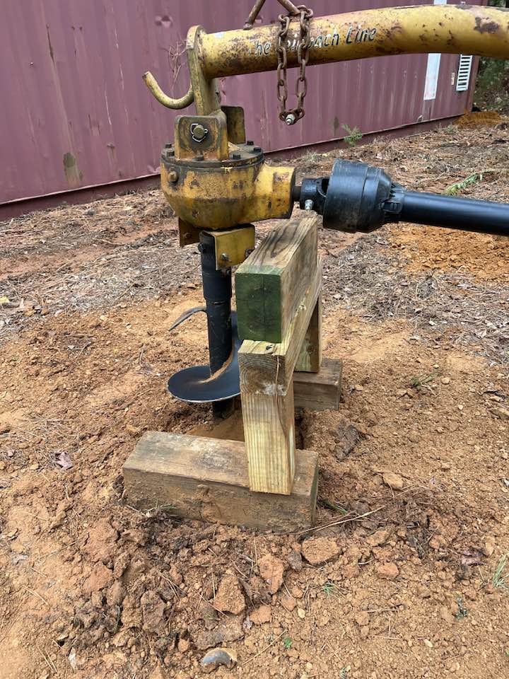

I started out with a 38hp tractor, and now it's on a 65hp tractor. The 38hp tractor had plenty of power to drill the holes, but not enough to pull it back out if it buried itself. I use a 36 inch pipe wrench to unscrew them, but I also have a length of 2 inch pipe that I put over the handle to get more leverage when it's really buried. Expect to ruin your entire day when you bury the auger!!! The 65hp tractor doesn't have this problem. Something that I came up with to help with the smaller tractor burying the auger was a set of blocks to stop it from going down any farther while using it. Once they gear box hits the wood, it stops digging and then it spins in the hole, breaking itself free.

I will bring the clam shell digger to get the final dirt out of the hole. Also the timber sections for a positive stop on the depth. Also the pipe wrench and extension pipe that you and CH4Ohio have pointed out for manually backing out stuck auger. Good to know replacement parts are also available on Amazon.
