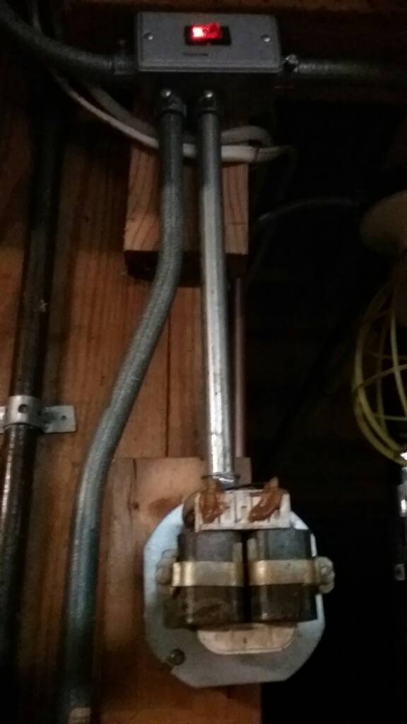

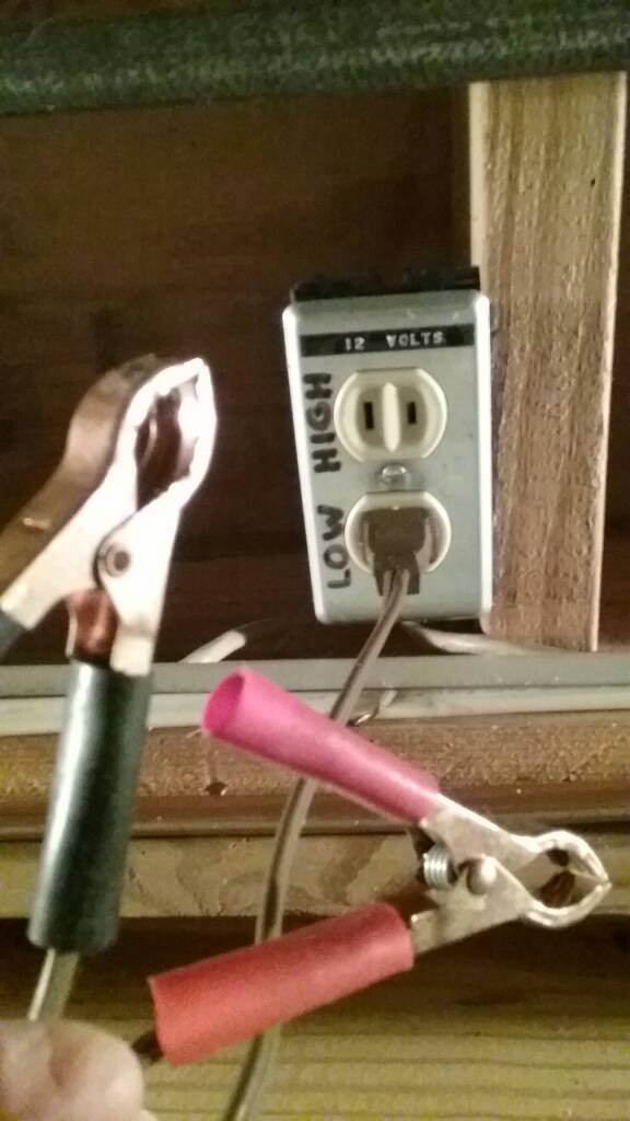

This is a simple thing I rigged up many years ago, if you have lots of batteries you want to trickle charge.
It's just a common 120v primary/12.6 v secondary transformer. This I ran down center of garage to boxes in ceiling. The outlets I cut the jumper and put a lamp (#1156 I think?) in series, one outlet marked low. Then a.c. cords with a diode in +red positive jumper.
Advantage is you can charge as many batteries all at once. Diode isolates them and provides charging (17v peak) voltage.
Plugging into low is a trickle charger current limited by lamp.
Disadvantage is unlike a maintainer you have to know how long to keep it on. A low current bulb like a #194 is only about 1/4 amp (250mA).
Just food for thought. 20181205_174640.jpeg20181205_174756.jpeg20181205_174822.jpeg20181205_174846.jpeg20181205_174908.jpeg
