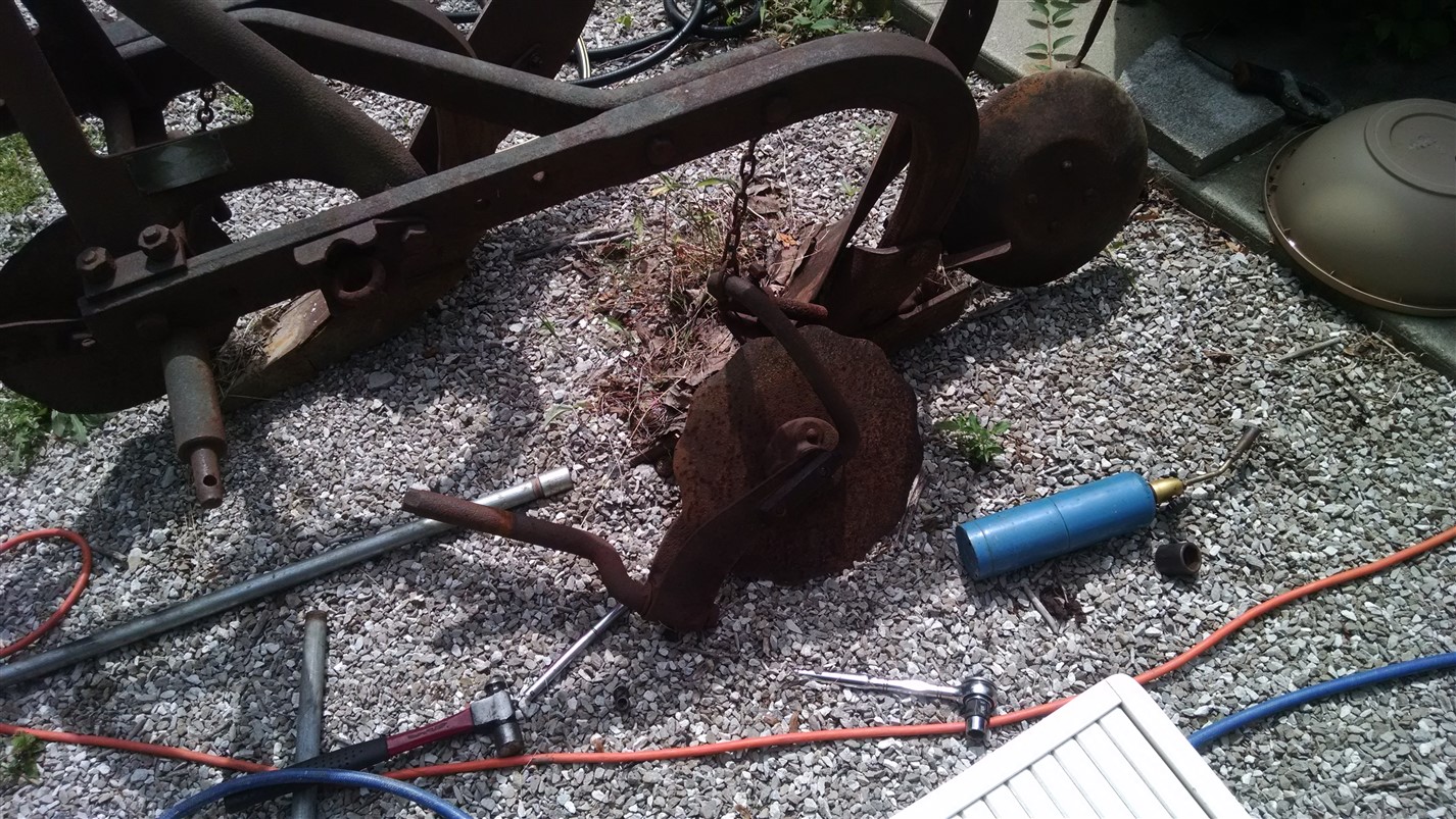

I use heat and a wax candle. The heat from a propane torch is fine but a Mapp torch is better. Oxy/acetylene or a tiger torch works well too. Just get the whole nut warm enough to melt the wax and use it as a penetrating oil. Wax seems to flow in better than anything as long as your using enough heat to keep the wax melted.
Once you have the wax in there just take two hammers and hold one under the side of the nut and then hit the opposite side. You don't need to hit hard you just want to set up a vibration between the nut and the bolt to help the wax penetrate. For the same reason it will help to hit the bolt on the head while it's warm. Do this several times and you won't even need a cheater pipe on your breaker bar.

I'd use an impact socket, like it looks like you are using in your pic, and a large breaker bar, depending on the nut/bolt and if you just want it removed or snapped off. Heat can be good, but you have fused rust there from a long time of weather and oxidation having wreaked ruin on the fasteners.
The suggestions of Flusher and pmsmechanic are solid too.
Mapp gas is way hotter than propane, and oxy/acetylene is even more effective.
Depending on if saving the fastener is the objective, I find that sometimes judicious amounts of heat will work if combined with using a hammer to smack the nut flanges to loosen up the rust and free the threads from the bolt. Then try using the bolt threads to recut the nut threads and vis-versa by using a rachet to tighten/loosen over and over until the nut works loose.

I have gone to almost automatically grabbing the 4 inch angle grinder or the welder if a fastener is stubborn. Welding a piece of pipe, an old bolt, or even a stub of rebar onto the available portion has usually let me undo fasteners with just finger pressure, at most a pair of pliers or small pipe wrench; it's quite astonishing, frankly.
Or, I just slice the nut with the grinder, even if not full-depth, then wallop the flat with a punch or chisel. The nut may take another cut on the other side, but it usually pops off quickly.
The time saving I get here more than justifies the expense of a few nuts or bolts, and the nuts are easy to replace, and wrecking them saves the original bolt, which is sometimes hard or impossible to obtain.

It worked! Only took an hour to get both coulters and joiners off. I used the candle wax heated by my little propane torch. Did the two hammers and repeated the process. Then used a breaker bar and got them moving. More wax and heat and moved the nut back and forth a few times. Then used the impact wrench for the final turns.
I took my time and didn't rush things. I was even able to pull up a chair for most of the work (it's the white object at the bottom of the picture). Thanks again for all the advice and suggestions. Sure glad I asked! plowapart.jpg
