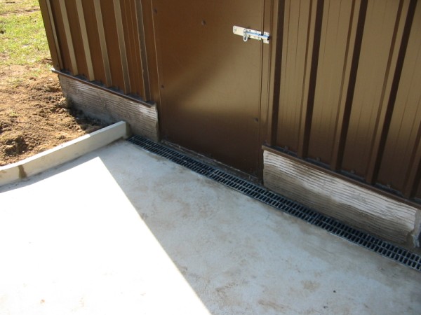

</font><font color="blue" class="small">( Now that's a really nice building, exactly what I'm wanting to put up. Who manufactures that deal? )</font>
just by looking at the picture you are going to have some
serious drainage problems how are you going to keep water from running in under the doors or do you have a drainage
system in place?

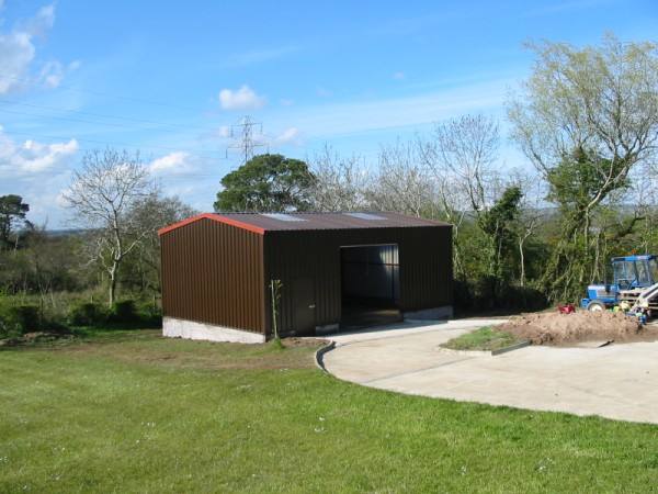

Well. They came again first thing this morning even though it was pouring with rain. I was away on business, but my wife says they worked through it without slacking.
It appears that at least two of the workers are Portugeese immigrants. They speak very little English, but are very friendly and evidently hard workers.
Here's the finished product.

"Finished" is entirely relative.
I still have to finish rendering the walls, installing the electrics and landscaping around.
Not to mention a fuel tank to give my "toys" a drink /forums/images/graemlins/wink.gif

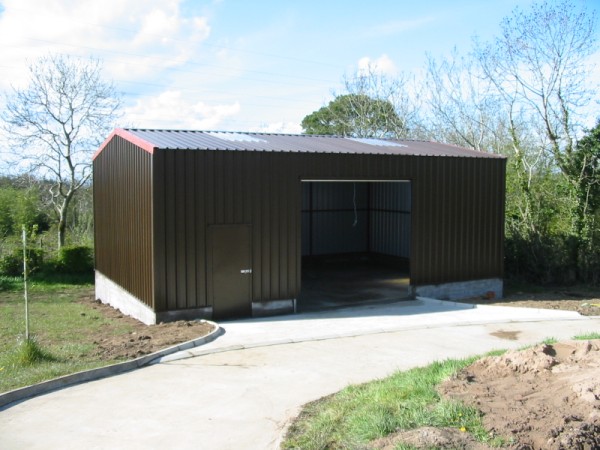

Redrocker,
The frame is from a local company here in Ireland. They make it up in their own workshops.
Having seen it erected and the detail of the construction, I could have fabricated the frame myself. The biggest problem would have been space to set out and weld up. They are obviously geared to do this kind of work and have jigs set to create the framing. The profiled sheeting is off the shelf and the roller door comes from a local supplier also.
Given the time and space, I might have had a go.
That said, the workmanship is very good, they build these day in and day out and at the end of it I have a finished quality product. If I had done it myself, it might not look so complete even several years from now.

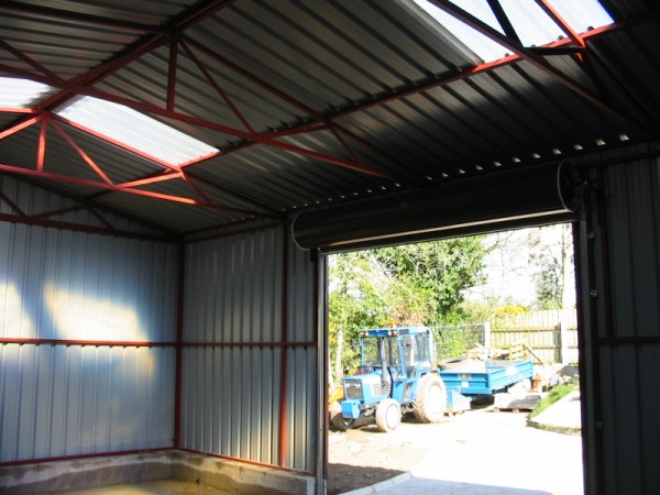

Here's an internal shot gives an idea of the positioning of the roller door.
Nigel

TBailey,
Drainage was a major concern right from the start. It has to be here in Ireland /forums/images/graemlins/crazy.gif
I was working on a sloping site and had to accomodate in the levels I had to work with. The access road was existing.
The first phase of the solution was to intrroduce a transit kerb to the front of the apron. Easy enough to drive over, it breaks the level and continues directing the water to the base of the access road where a road gully takes it away.
Nigel

The second stage was to introduce a comtinuous drainage channel across the opening.
You could not see this in previous photos as I had a plywood cover as the channel lid to protect it whilst concrete was laid and walls rendered.
The channel grates are now in place and should do the job.
The floor itself has a pvc damp proof membrane installed to prevent rising ground water. I don't want my toys getting their feet wet /forums/images/graemlins/laugh.gif

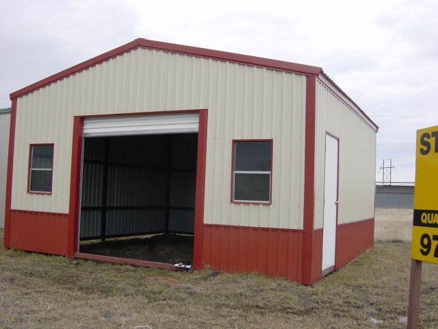

It sure looks nice, can't wait till I can get one on my place.
Here's one I was looking at copying, just need time and money!!

I was just going to tell you to be carefull about the sky panels in the roof. They are illegal in many states here in the US as they can become brittle over time and if someone is on the roof they can fall through. I think as an alternative they install them in the walls or ridge. The particular story I am thinking of was a farmer trying to remove snow from the roof. He fell through, broke many bones in his body and died about 20 ft outside the barn when crawling for help.
Don't want to put a damper on your project, just wanted to let you know.
