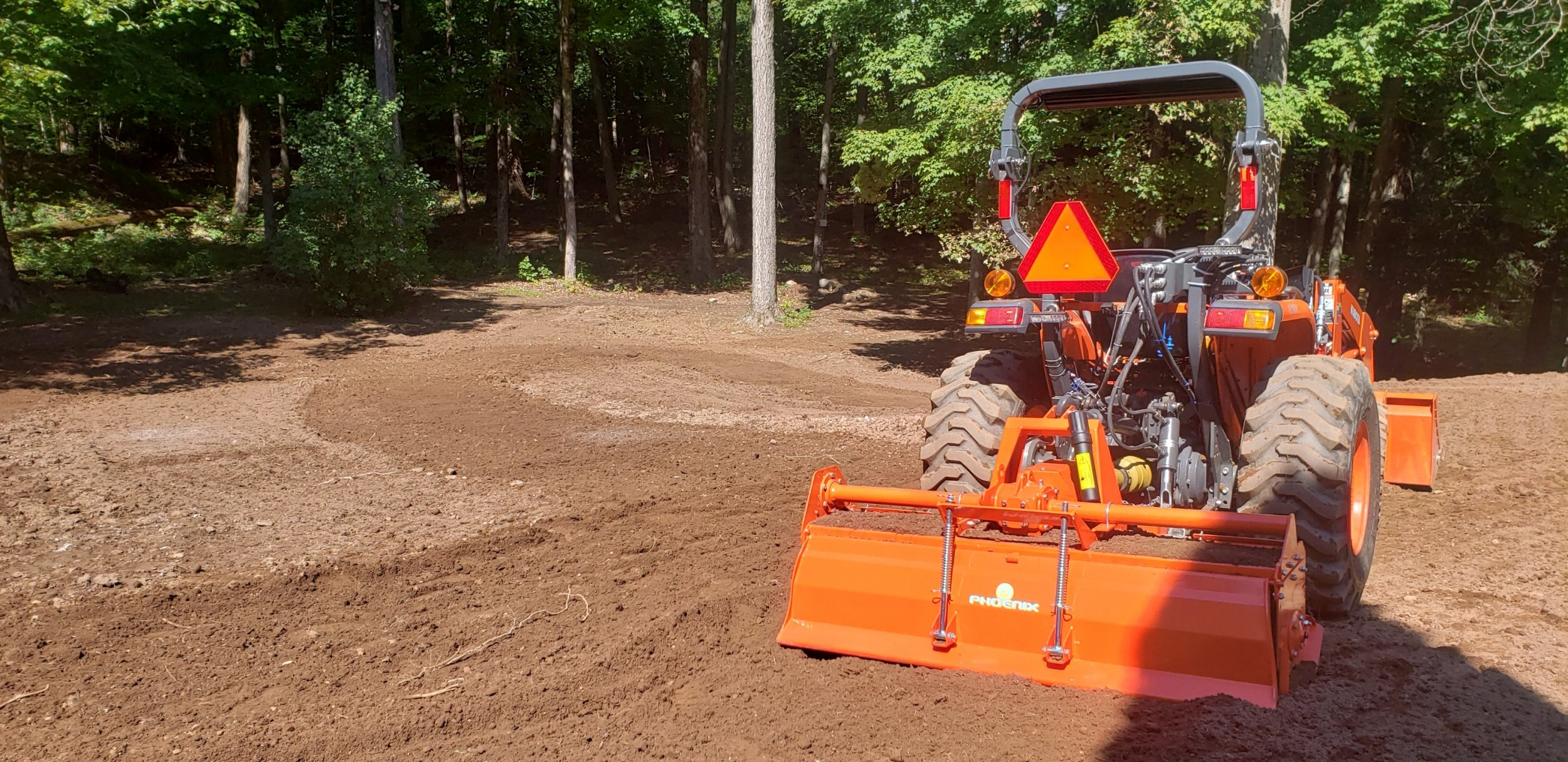

A couple of years ago I put in a new 3/4 acre lawn. The land hadn't been touched in 30 years and the original landscaper didn't put a lot of time in 'derocking'.
Because the prices I received for putting in a new lawn were so friggin high I decided to do it myself and purchased a really nice Phoenix 66" reverse rotation tiller from EA. I used my box blade's scarifiers to dig up the rocks first and then the tiller. I just didn't want to beat the crap out of the tiller with the rocks. It worked out fine!
