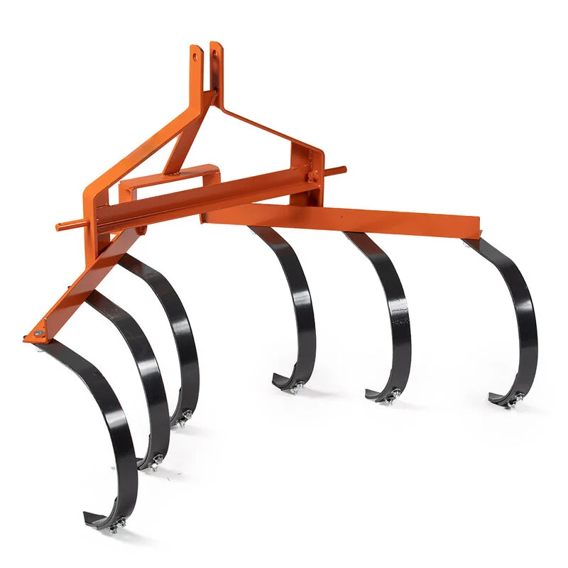

Yanmar SA 425 is an 1,850 pound, under 25-horsepower tractor.
Not enough tractor weight, not enough power to pull a Disk Harrow of effective weight.
I suggest a Middlebuster, AKA Potato Plow, with replaceable plow blades. Ample for a one (1) acre food plot. Relatively cheap, low draft resistance (low traction requirement), short operator learning curve.
Tarter produces 'CountyLine' brand implements as private labels for Tractor Supply Company.

I guess I should specify a more on these rocks. I’m not talking softball sized rocks, I’m talking 2 plus footers.
YANMAR SA425​
Lift Capacity (Pivot Pin) lb. (kg)1,200 (545)
Stone Fork weight is around 450 pounds. Therefore, Stone Fork payload in theory could be 750 pounds (1,200 - 450 = 750). However, both Stone Fork and payload are carried forward of the FEL pins, therefore "real world" payload capacity will be around 600 pounds, with enough counterbalance mounted on the Three Point Hitch to maintain rear tires in solid ground contact.
Relatively cheap (<$400), low draft resistance (low traction requirement), short operator learning curve. Three Point Hitch counterbalance not needed.
