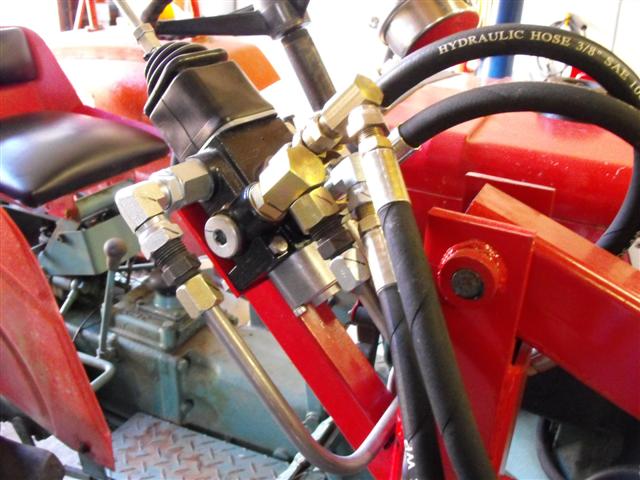

Look at that picture of the valve again, the PB sleeve and hose is connected to the straight through path through the valve. The return is using the top outlet

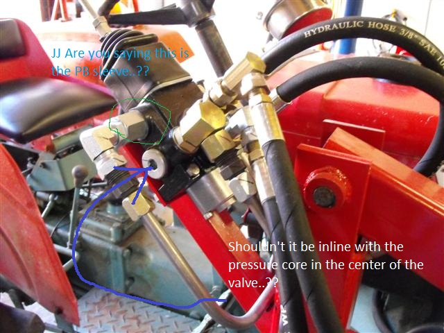

This is where I'm not seeing that.....The PB (plug shown) is inline with the center power core but the PB hose connection to 3ph is not (it's showing the return to tank inline with the power core)......
   / Erratic Hydraulics #75
In this picture, I see the steel line attached to the PB sleeve, the return is the 90 degree fitting to the right. The side return port is not used. Both are using steel lines.

?? Which are you referring to as PB sleeve.?? the upper left looks like an adapter fitting to me....
That is correct. The PB port comes straight out of the valve side and I used the top return port hole and plugged the side return port hole. The side hole would not clear the PB 90degree fitting.
This valve has an internal connection between the PB port and the tank return port unless you install the PB adapter (which it has). Then the connection between the two ports is sealed off.
