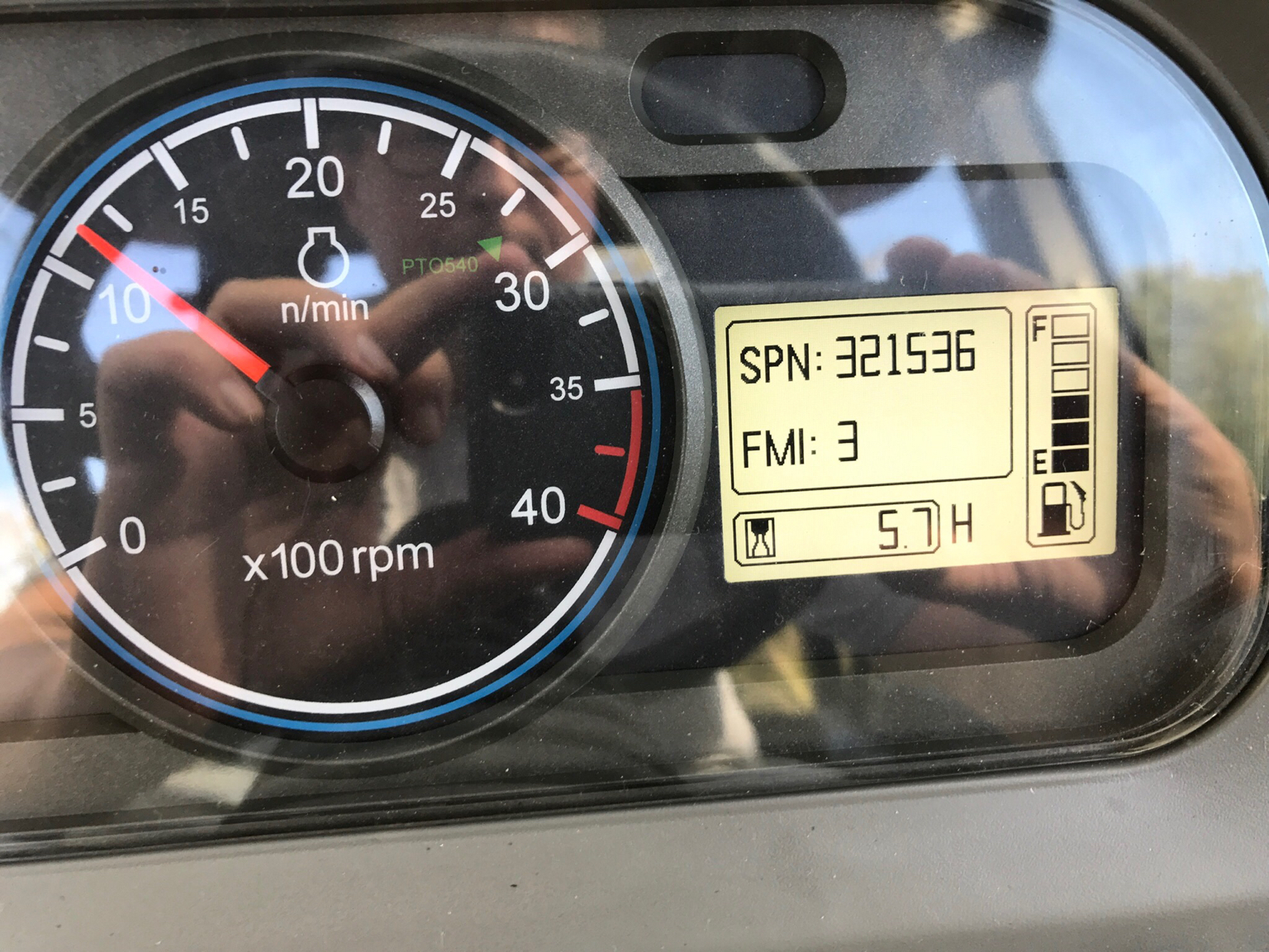

I started my tractor and saw the following codes show up on the dash:
SPN: 321536
FMI: 3
This flashed alternately with two warning symbols:
I can't find anything in the user manual and my dealer is also stumped. Does anyone know what these mean?

Stephen, it doesn't sound similar to the problem I had.
   / Error codes on T554 #15
The left engine light indicates low oil pressure. The right is the check engine light. Low oil pressure would trigger a check engine warning. And both would illuminate.
Try changing the engine oil. If that doesn’t work try pulling the sensor of the idiot light and hooking in a guage, to see what the pressure actually is.
Sometimes the sensors go bad, and send incorrect signals to the engine management system.
