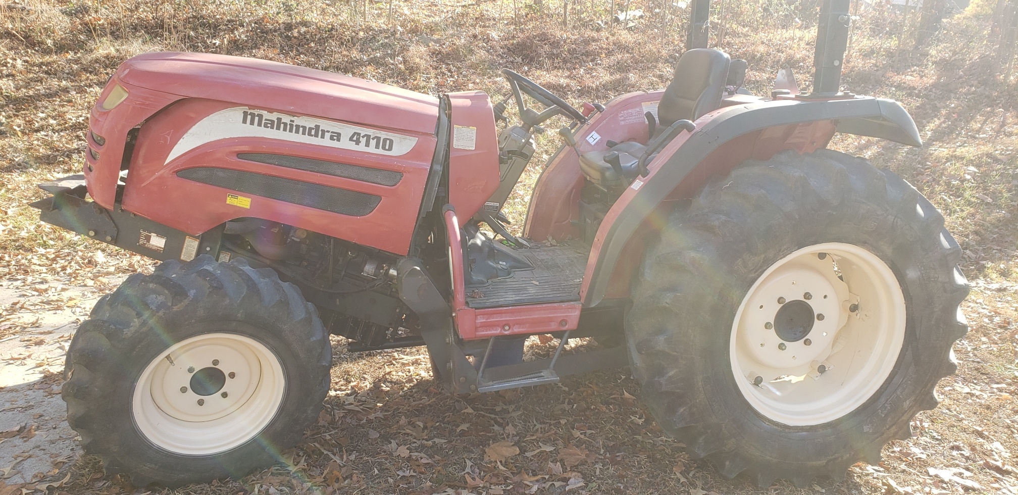

Hello. I purchased a 2001 4110 with FEL in May 2023 with approximately 1650 hours. This week I was pushing some dirt around with the loader, I heard a "pop" and the clutch bell housing had broken apart. Everything worked good on the 4110 but now this. My first inclination is to sell the tractor as salvage. If so, how would I determine the value? I live in North Carolina. Does anyone know of a Mahindra salvage yard in this area?
Thank you.

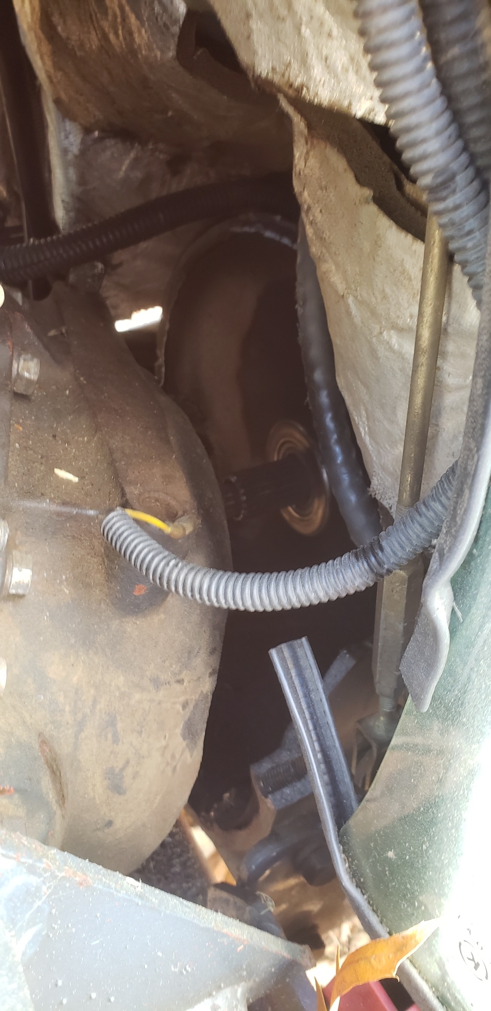

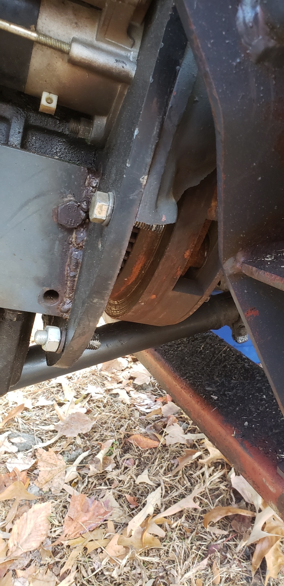

That's one heck of a break. What's welded to the bell housing in the lower picture
   / Establishing Value of Broken 4110 #4
Check with your local Kubota and John Deere dealers, that tractor would make a heck of an advertisement for what not to buy..... Sorry for your bad luck.
   / Establishing Value of Broken 4110 #5
I’d say it’s seen a welder before! However, From what I can see it’s a clean break? Be a great project to split the tractor and have a pro welder put it back together. Quite unusual really…
   / Establishing Value of Broken 4110 #6
Looks like that's a side frame. The weld is a poor man's solution to bolts breaking and/or frequently working loose.

That vertical piece of thick plate is the plate between the engine and trans - it is bolted to the back of the engine, with several of the bolts behind the flywheel, then the bellhousing is bolted to the plate with a different bolt pattern. That horizontal gray plate is the tractor frame rail along the side of the engine. Those bolts that attach the vertical plate to the engine do not have ANYTHING to help hold them tight - no lock washers or Loctite. Mine loosened many years ago and the tractor started to come apart. It's obvious that this happened here and someone tried to weld the side frame of the tractor to that engine plate to hold it together instead of doing a split and changing bolts like I did and using Loctite on them. This is when I discovered TractorByNet all those years ago !! I related my experiences with Mahindra and the fix on my tractor back then. After the repair, this problem never occurred again. Mahindra could have avoided this catastrophy with $.02 worth of Loctite during assembly ...
