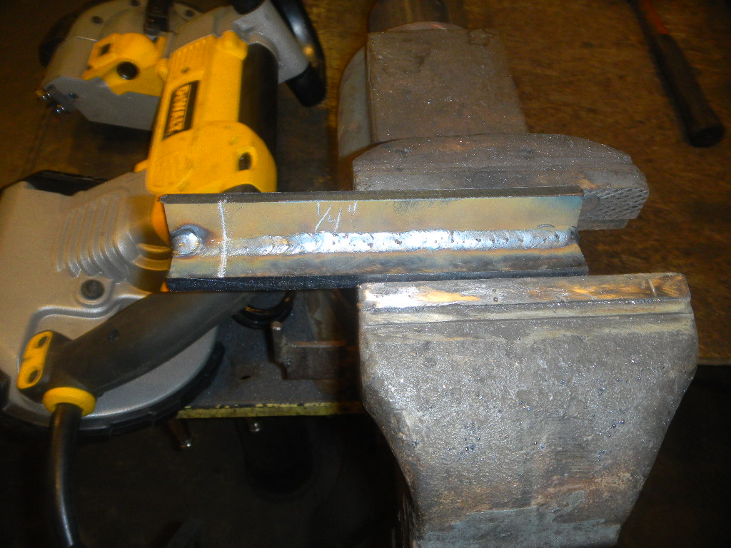

I love this phosphoric acid! It give results very fast.:cool:

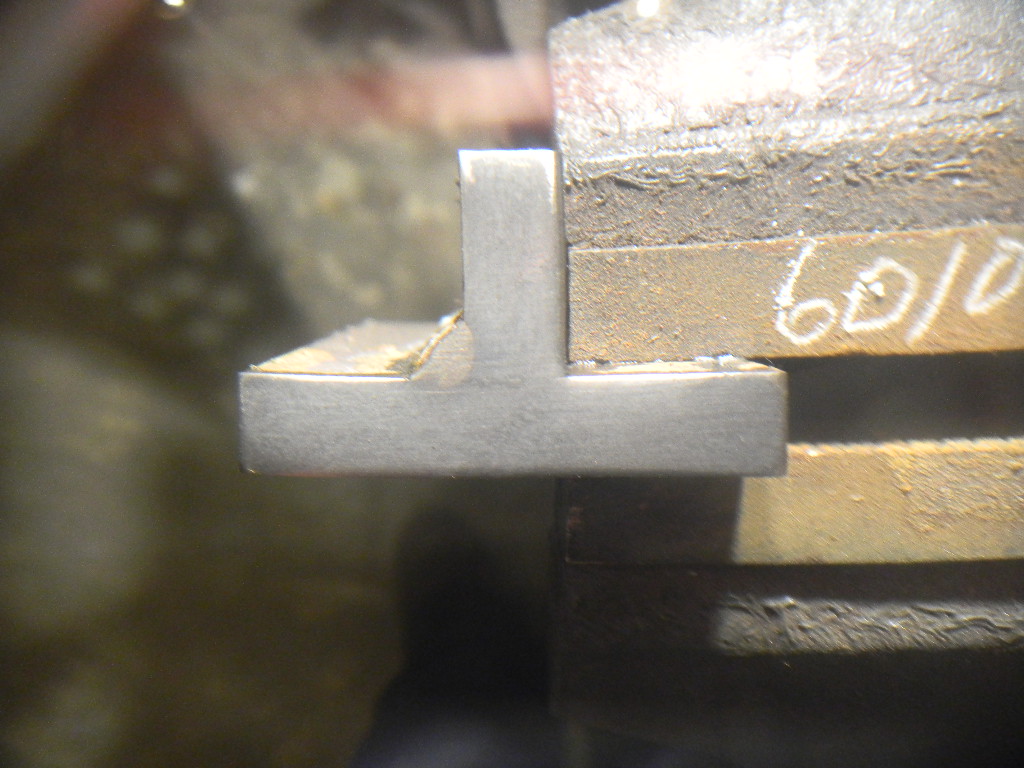

This is really dis hearting:shocked:. This is the 3/8-inch thick V-butt test plate I ran with the Everlast 120-volt Mig welder. Wire speed maxed out, and the voltage turned down just a bit. This is the last 1/2-inch of the plate. So it should have been about as hot as it was going to get. And I preheated this test plate before I started welding.

Oh it does Dave! Only takes a couple minutes to see the results too! :cool2:
/ Etching welds. #24
Very interesting. What phosphoric acid concentration are you using for the tests?

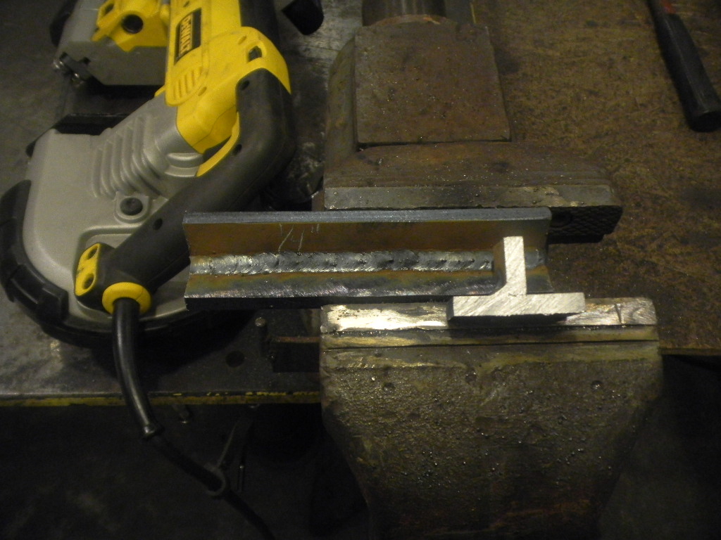

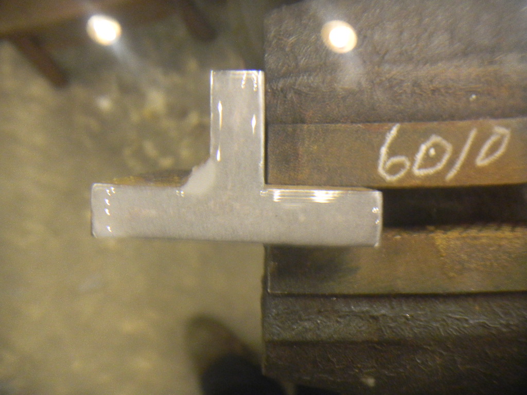

Third picture is the weld made with the Lincoln V350-Pro,
Shield Arc, that V350-Pro must be an awesome machine. That etch is picture perfect. :)
I've never seen an etch weld pic showing that much penetration down into the corner before. :thumbsup:

Oh yeah she is a sweet machine. These inverters just amaze me with the control they have over the puddle. That weld was run with 0.0 on the pinch / arc force. Need to run a fillet weld with it, and set the pinch / arc force up more and see if that gives any more penetration.

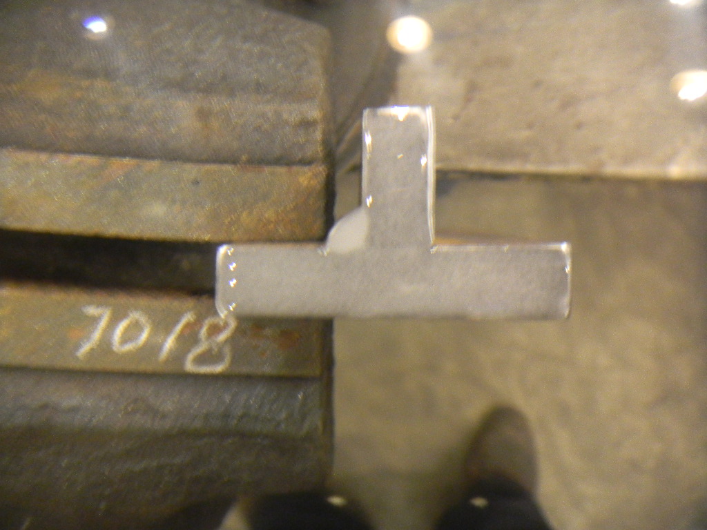

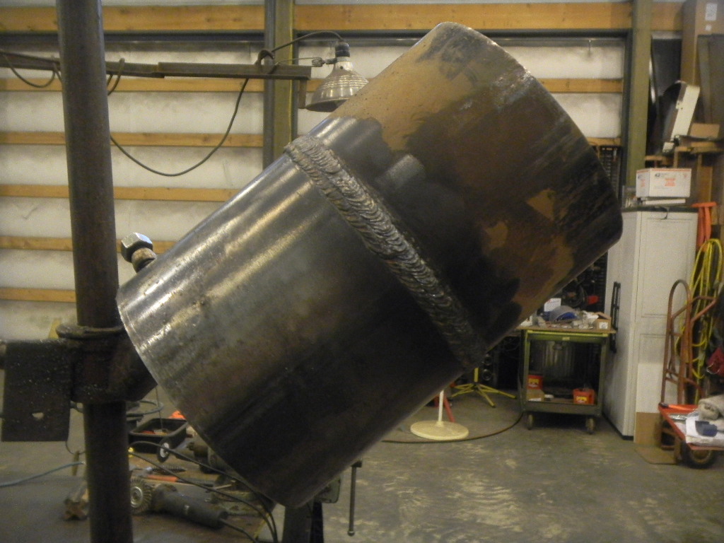

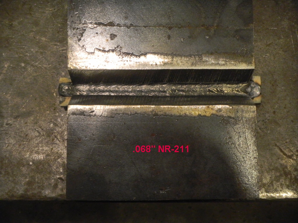

I was just in the shop cleaning up around the saw. I found this 3/4" thick V-butt weld I did last summer with .068" NR-211. I thought, well lets see how it did.:laughing:
/ Etching welds. #34
Looking good. :thumbsup:
Now that you've got your etching skills perfected, you'll probably be etching anything and everything you've done in the past, that you can find.
You might even need to order a couple more bottles of that etching elixir. :cool2:
/ Etching welds. #35
Hey SA, I doubt you have the weld you did with my 211 on 3/4" Tee fully cranked but if you do, I wonder what kind of penetration you got?

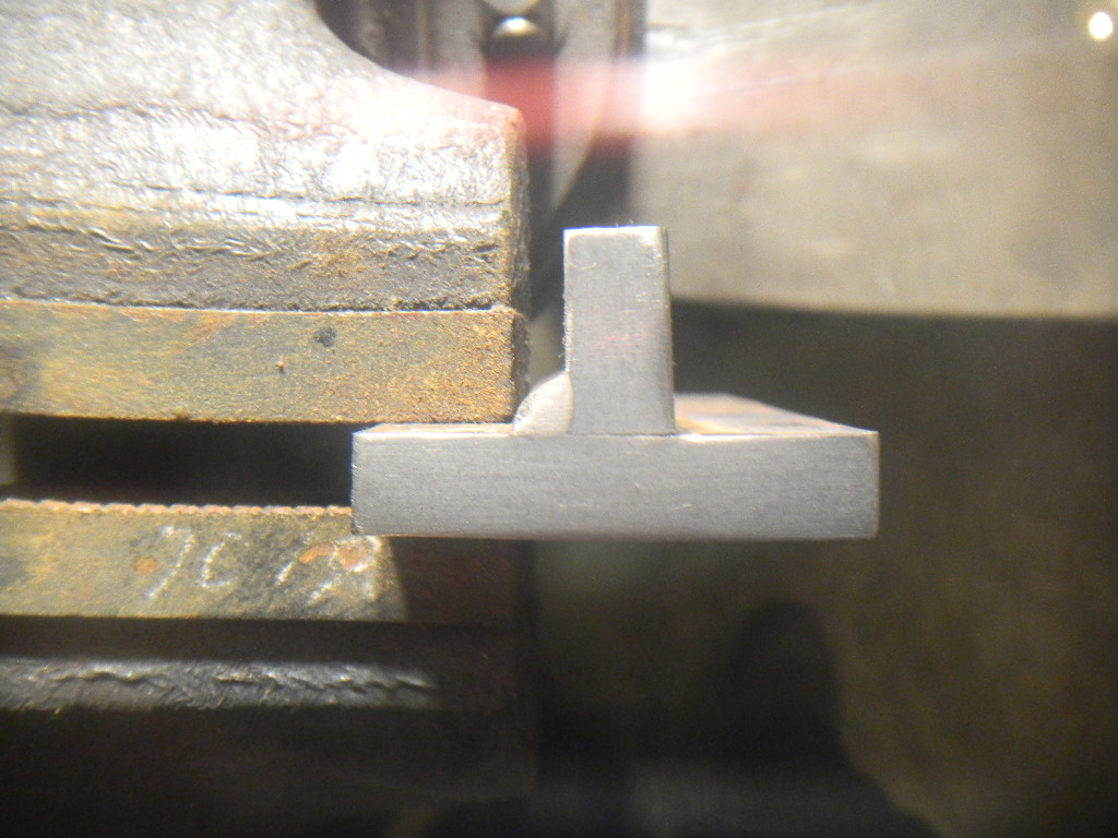

Very Interesting. Better than a bend test.
Etching shows the weld profile but not the strength of the weld metal. There is no substitute for a proper bend test for determining quality of weld metal, not even an X-ray will prove the welders and welding rod ability like a bend test will. That is why even after all macro-graphs, etchings, xray testing etc have been done on a welding PROCEDURE qualification, a bend test is the acceptance standard.
I have seen beautiful welds that failed the ASME IX bend test procedure.
