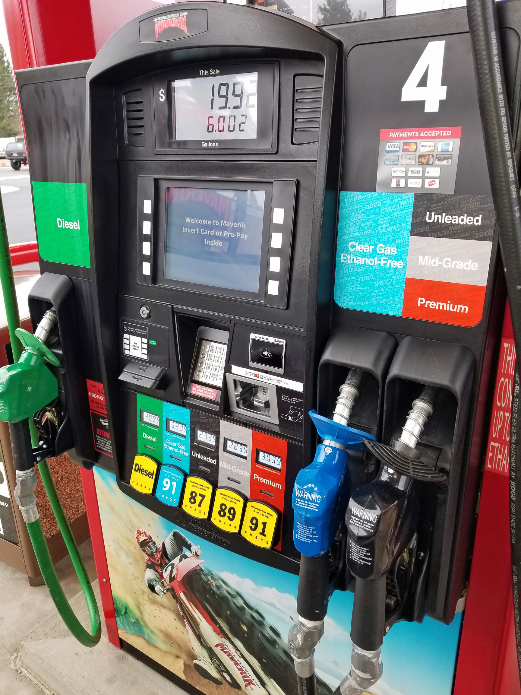

In that case, I always put the first gallon in my pu's gas tank and then fill my cans...
SR

I bought 5gal of E0 91 octane from a station that had all those grades and e0 87 octane. The fuel I bought was yellow and smelled bad in 2 months. It didn't even last until the real winter started which is why I bought it, winter storage. Now I only buy e0 91 octane from pumps that don't carry e10 91 of rain.
Think about it. We are the knowledgable one's and prob at the max are buying 20gal a year of E0 fuel. You have to figure these at least a few hundred gallons in storage at the pump and there not putting stabil in it. That e0 could be half bad right out of the pump...in my case it was.
