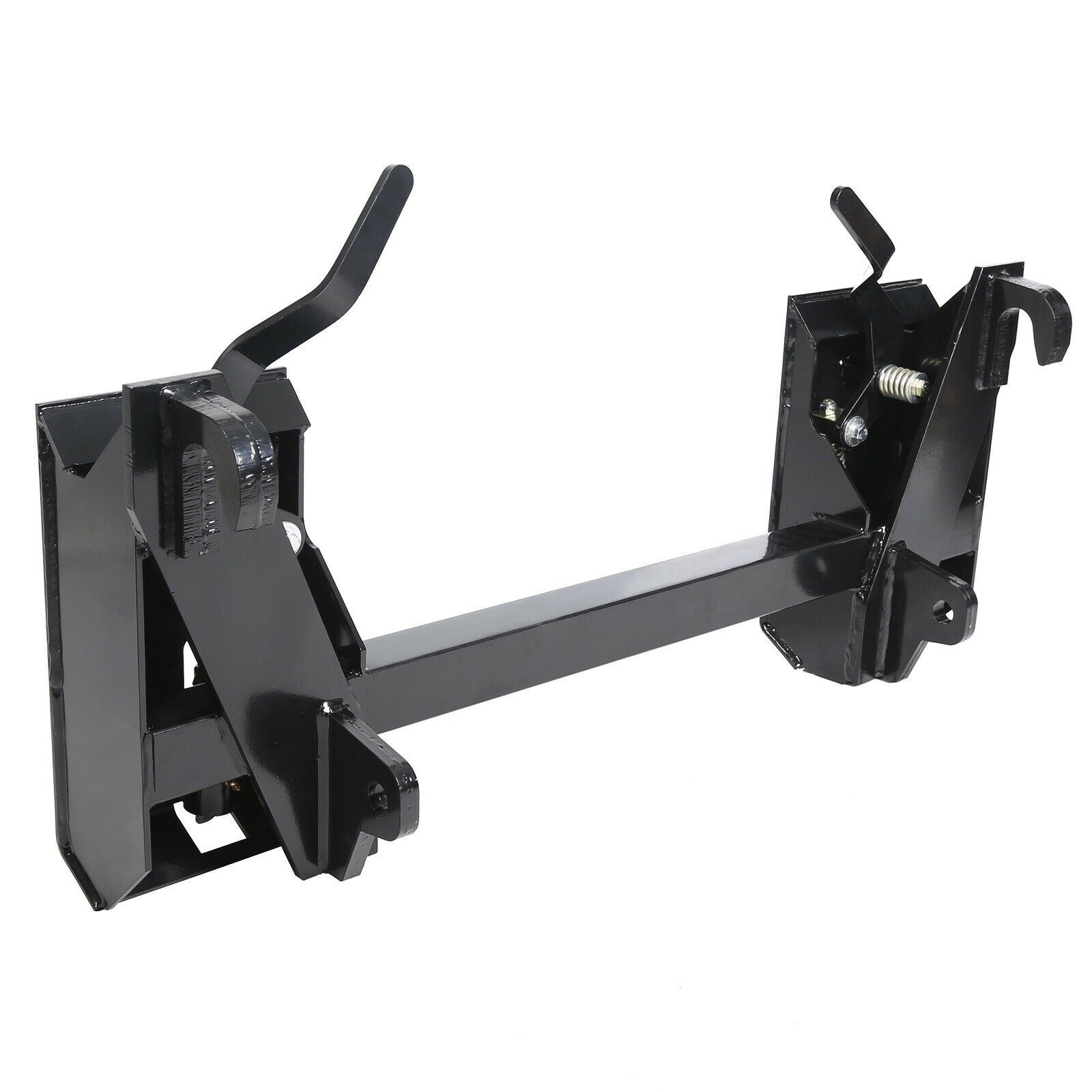

I am reminded though of this caveat: These adapters tend to be quite heavy and take away a considerable amount of loader lift capacity.
Euro/global quick connects tend to be on larger equipment, I doubt the extra weight is a meaningful percentage of the loader capacity.
Likely as not "John Deere" is just stuck into the name as a keyword to show up in searches.

It weighs 140lbs. My loader will lift about 5000 so not much worry.

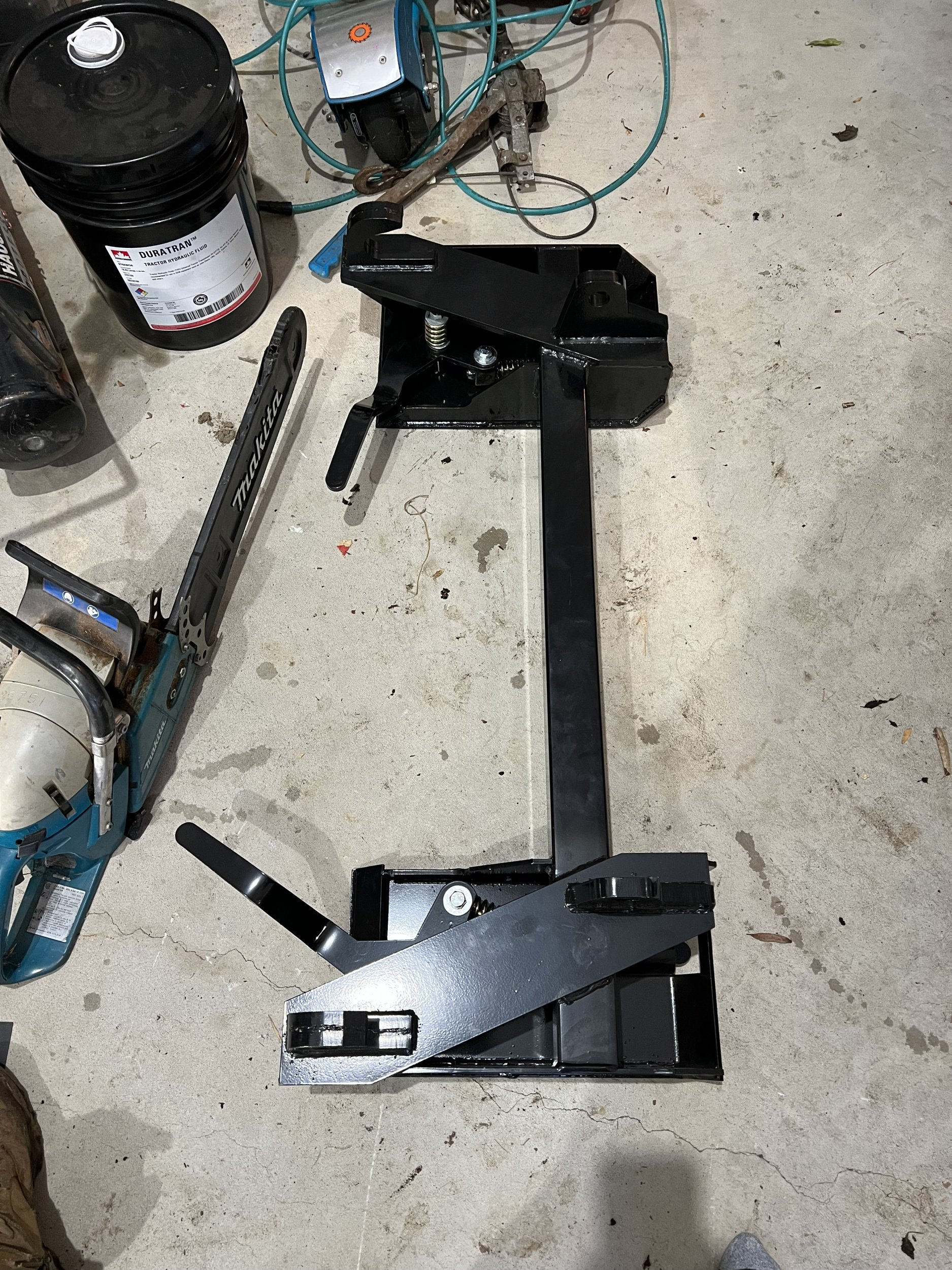

seller replied with a somewhat canned reply “It is John Deere Global”

Looks like Euro

How much farther out will the attachment be with this kind of adapter? I worried about a blade,with the added 'arm' could be more prone to bending stuff if you hit something with it.
I looked into a whole new tool carrier for my loader frame.... about $1000.....
   / Euro/Global to Skid steer/SSQA adapter
#19
Legit concern that I have, too.
Looks to be about 10” deep.
For me it’s more of a temporary measure while I switch from skid steer to global.
I hope to have 2 Euro/global loader tractors and all E/G attachments soon.
This is more of a temporary measure to get me through that

Arrived right away.
Feels a little “light”.
Seller said it weighed 142lbs.
Feels more like 100 lbs as I can easily lift it over my head
