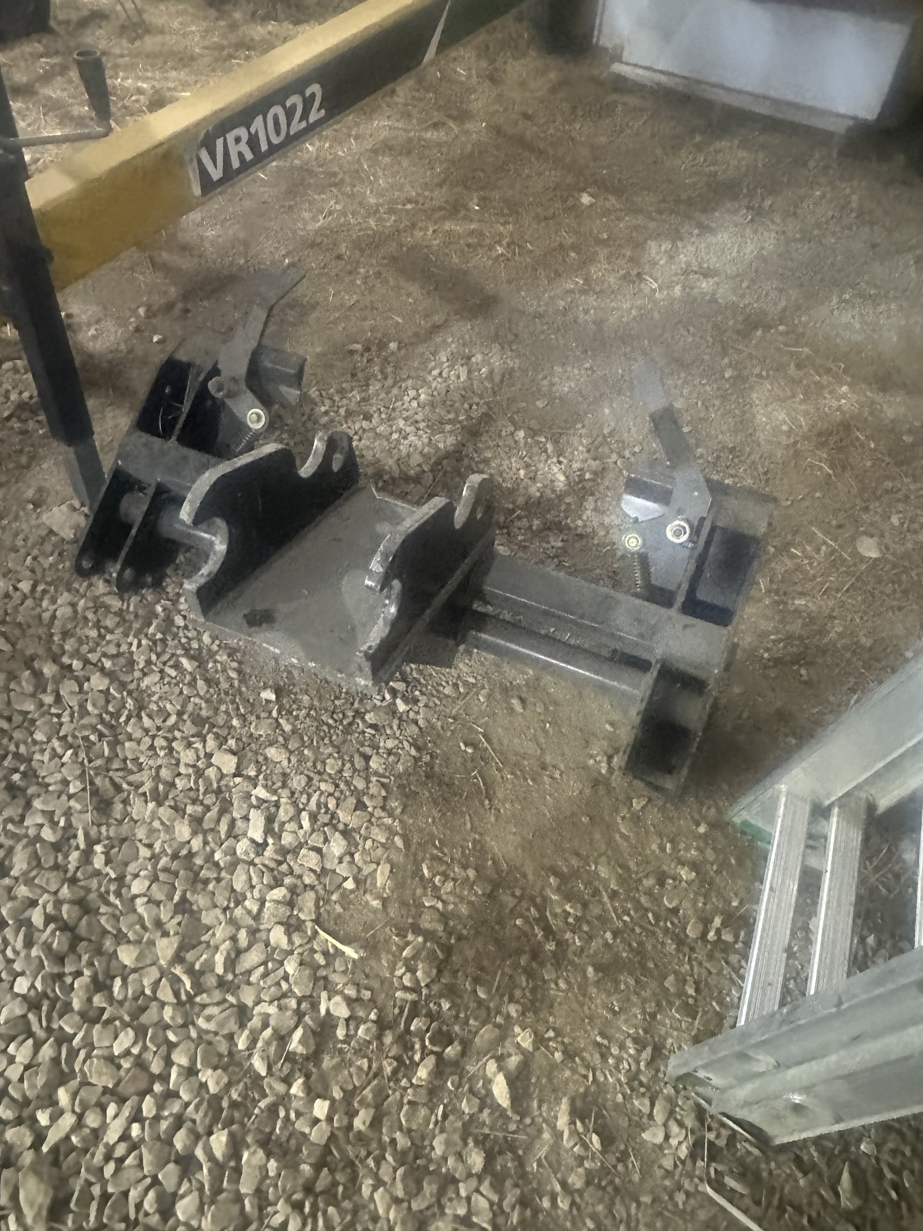

Arrived right away.
Feels a little “light”.
Seller said it weighed 142lbs.
Feels more like 100 lbs as I can easily lift it over my head

HD, I just saw this post so I'm late to the game. At least I don't recall responding to it. I had the same issue with my SS PHD. I bought one from Bell Industries because it was the only one I saw made in the states. Mine is quite a bit heavier and has more metal in it. I really like it. Works well for my purposes. It sets the attachment about 4" father out. I paid just over $800 for it.

Paid $980 for the Worksaver adapter and it’s built in USA like a tank. Tried the crappy chinese one and it was terrible!

Yeah the cheap adapter I bought a few years ago was a pile of crap. They I spent 4 times as much and got a good one.

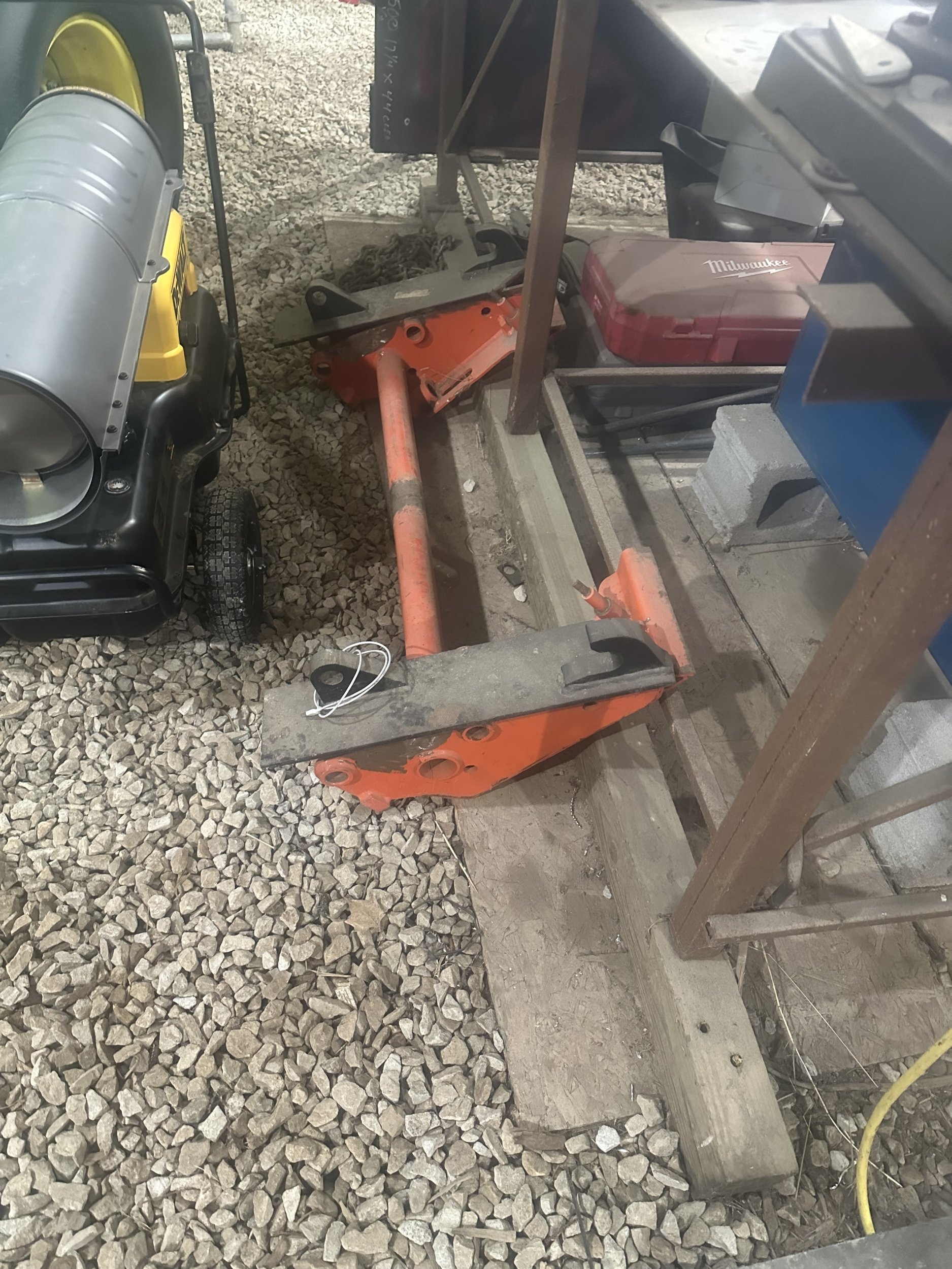

I got 2 of these kubota loader ends from a dealer, 1 was perfect and the other was tweaked. Easy fix just cut the torque tube and reweld. I made an adapter for my mini-x to use ssqa attachments, didnt have a use for the other but had a pair of euro adapters and started to tack them on to try and figure out a configuration to weld up. Lost interest but now with the new tractor I’m going to dust them off and get it going so i can use my pallet forks, cause dang, the adapters are expensive.

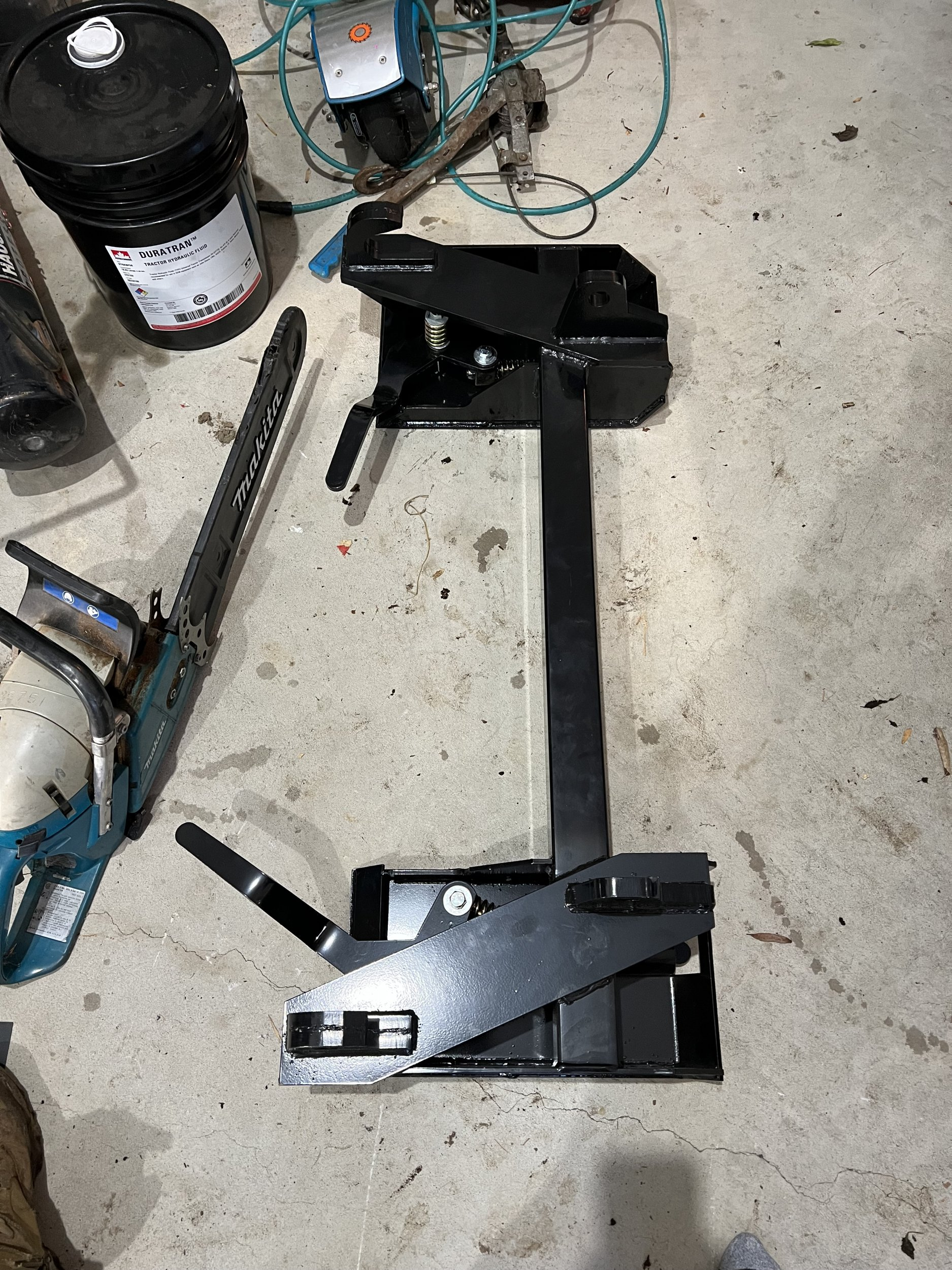

Looking back at this thread, wonder if this adapter is better than the cheap one hay dude tried out, it’s on sale and free shipping. $500.
Titan adapter.
