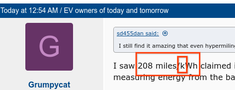

2023 Tesla Model Y Long Range AWD
says 28 kWh/100 miles. EPA measures from-grid, the energy to charge the battery to drive the miles. Is more accurate to measure this way, but harder. One has to measure the energy to recharge back to the SOC one started the trip.
For those who failed high school physics 28 kWh/100 miles is 280 Wh/mile. In-car indicated 208 Wh/mile from battery for 140 mile average.
For those who failed high school math 208 Wh/mile is 4.8 miles/kWh.
So what did you fail?
   / EV owners of today and tomorrow #1,989
Yeah but when you finished the trip and parked what was your actual fuel usage? When you do the same thing going down a long hill in an EV the energy is being harvested and put back in the battery,the truck is getting the brake rotors and pads hot instead.
Yes, but I don't have a 70 mile hill to go up/down then return down/up.
Both Grumpy and I have seen almost 5 miles per KWH at the vehicles best and that is for sustained driving in good summer weather. EV's have a broader best to worst energy usage for sure, winter they do use way more energy, but summer can get some pretty great efficiency.
Teslafi says all the losses parked since prior drive and consumed during this drive works out to 278 kWh/mile added from the power grid. 208 displayed in-vehicle, 278 measured (still by the vehicle but calculated by other means) outside vehicle.
